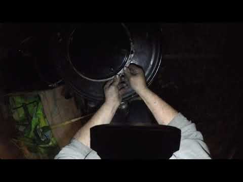

Short video of a hopper bridge on the way home last night, interestingly if I refuel with half a hopper full in about a mile and a half I will get a hopper thump like clock work every time. I would assume this is due to the much larger hopper being able to ingest a lot more oxygen while refueling. The Toyota does not care when it gets refueled it has never thumped while driving once. Puffer lid does its job nicely and last night I saw the fireball puff out in the mirror since it was dark out. Boy oh boy did the guy that was tailgating me back off in a hurry!

Marcus have you tried a duck tape gasket like Wayne uses on the puffer lid? Or tried greasing the gasket to keep it from gluing to the rim?
Grease it every day still sticks. These buckets I used SUCK, I would not recommend them. The lid will bend its so thin when the gasket sticks
