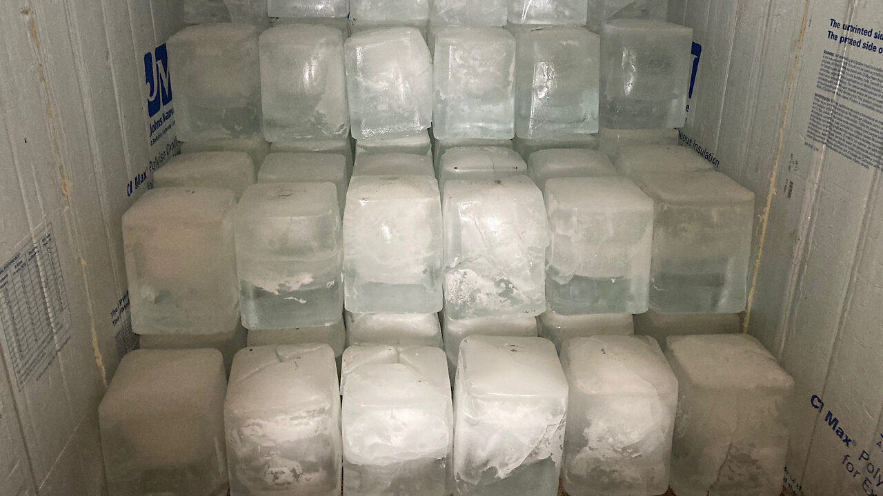

You would go out to a frozen pond, in coldest mid-Winter, with a horse and sleigh, and saws, and helpers. You would cut ice blocks from the pond or still water area. Then you would take them back to a sturdy building and stack the blocks surrounding them with the sawdust you made from working wood for building and heating. Then, you would hope you did a proper job, and there was still ice left in the heat of Summer. Go sit in the icehouse and drink cold drinks while remembering the hard work and planning done last Winter. :cowboy_hat_face: If you live in a warm climate, swim in the pond. I suppose a Swamp Cooler would work in a warm / dry climate. :smiley:
I visited a man who had a water powered saw mill up in Michigan, he used that mill to cut the blocks of ice for just that reason…
Today another friend of mine fills up buckets of water and lets them freeze and put them in an Amish made igloo.
Swamp coolers do work in humid Florida, but not inside the home, they are used in mini green houses where the air is pushed right on outside, but the incoming air is cooler than what is in the greenhouse and the tomatoes love the humidity.
