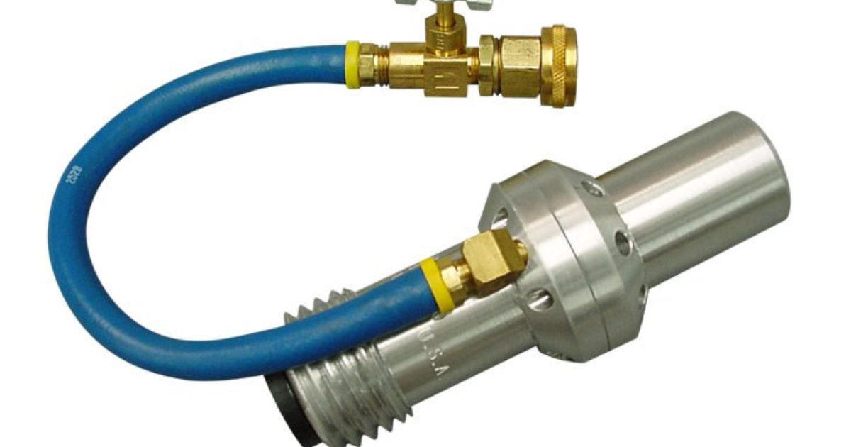

Think I’m going to replace my ceramic TIG cup nozzle (too fragile) and replace it with a tungsten carbide sandblasting nozzle, similar to this one…
We get higher melt temps than SS without the brittleness of alumina…
With 1/4" opening wouldn’t it take 4 of these at over $50 apiece?
That image was for reference… scale up depending on gas flow needs…

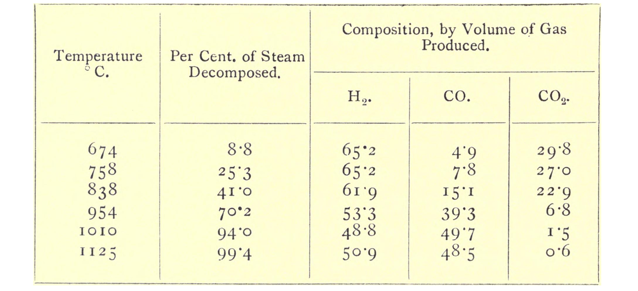

Remember, the ideal exit speed should be 25m/sec and the ideal temperature is 1,125 C. If you have a pressure drop at the nozzle, it might make sense to balance these two ideals.
The Crossfire was all 1" pipe, but the nozzle was 8mm—not too far off from the 6.25mm as the nozzle in the photo. For reference, we ran a 7,500 w generator and a 10,000 w generator, no problem…
There must be some sacrifice to the outpt, but if it means better gas, it might be an even wash, or even a thermodynamic benefit…
The way I look at it is why not invest in a nozzle that you never have to worry about again? If you look at the true cost of the “bother” of fabricating or molding your own… i.e. $50
I’m going to splurge and will report back to this group with results over time…

I have used TC on a nozzle about 2 years ago and with great results and if i could remember where i put the nozzle when i took it out of my older gasifier i would use it again for sure , so Troy suggesting TC blast nozzles is a very good and cheap way of geting a almost purpose built nozzle that will almost be plug and play , and i have even found this one that would suit us i am sure for those that use a water drip .
Glad to hear someone tried this with good results… I will be moving in this direction…

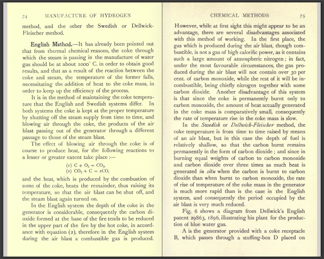

I think this picture is not for gasification with air Troy… More likely to use with steam gasification, external source of heat.
Koen —ambient air and steam—intermittent bursts… Their primary objective was to product H2… So yes, this is not a universal syngas temperature chart, but one that was cenetred on H2 production through coal gasification…
The Chemistry and Manufacture of Hydrogen
by P. Litherland Teed
so, 2 main “gotcha’s…” 1) we are using char from biomass (cleaner and usually less dense), and 2) I/we are trying to find a homogeneous balance of temperature and “free” H2 gas via continual drip and subsequent flash vaporization…
So, for woodgassers that aren’t interested in cracking steam, this chart may not apply.
Thanks, Koen. Sometimes I need to preface my thoughts and biases… And it’s important that if someone makes a claim, it should be cited…

It appears that the most relevant information on the ideal temperatures for this situation are 1,125 C, as per P. Litherland Teed studies, even though they were using ambient air.

I still doubt that picture. As with ambient air there should always be nitrogen present. Or, in this case, they might have been using the steam phase for the gas and the air inject for the heating phase and use that gas (from the heating phase) for heating the water to steam process.
But the picture is still not useable as reference for our DIY builds.
Hi Koen, the writer was seeing up to 70% N in his overall gas flow (we can do better than that now) as he describes here:
I certainly never believed there was zero nitrogen, and didn’t try to confuse anyone. In fact, I’ve been constantly thinking about how to get rid of it. You know me too well :wink:
That table heading is a bit misleading, however.
here is the link, if your are interested (some good stuff):
My principal interest in this chart was the ideal temperatures for steam reformation in a char gasifier.

On second reading, I think they were only capturing the syngas during the steam phase, then using air to heat… You were right, Koen…
And if that is the case, then those numbers and that table makes sense…
Great way to make N-free syngas (bottling)… But not for running real-time engines…

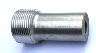

I looked around and I see TC nozzles of various I.D. up to 1/2" for about $25. Please let us know how it performs when you put one into service.

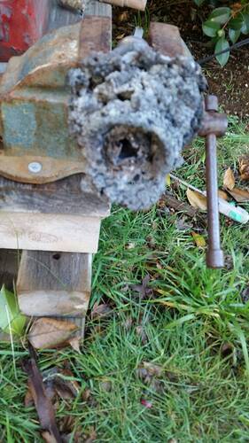

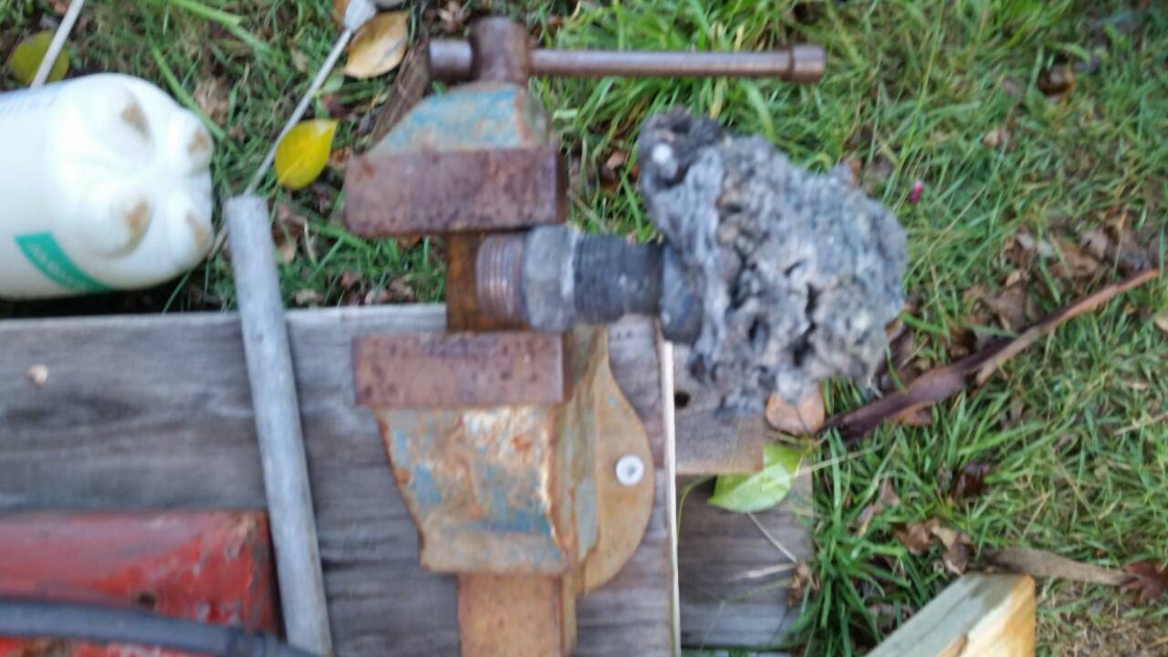

Just over halfway through winter decided to check out the old nozzle , bit of oxidation wearing it down a little but still once cleaned off of slag i reckon i could get another few months out of it , as its only thick walled mild steel bar with a 25mm hole and 40mm OD its an easy replace .

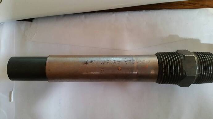

Going back into the gasifier this afternoon will be a Boron carbide nozzle , shall give this a testing while waiting for a tungsten one to arrive
and sleeved into thick walled copper tube and into 3/4 pipe fittings

This is great stuff and timely for me. I’m especially interested in hearing your results when using the smaller diameter nozzle. I’m hoping that 5/8" , 1/2" or even 7/16" might work for a 250cc engine. Your thoughts? I have one of those tungsten carbide sand blast nozzles on my wish list.
Please remind us about the engine size and any EGR with the nozzle in the pics.Thanks!

Ran the gasifier for 2 hours late evening good gas straight away and engine running and full power in about 4 mins .
Now i was hoping that this morning i could walk over and unscrew the nozzle setup out of the gasifier with a almost full load of charcoal in it , but i could feel some resistance when attempting to unscrew so rather than destroy anything before doing at least a 2 week run i have decided to give it at least 14 fire ups before removing it and add up the total hours running time and then post the pictures of what ever is left
This is running my 7KVA inverter generator that powers a 12volt 50amp inverter battery charger , and also a 24volt, 100 amp inverter charger , and while running also powers my drop saw, tv, , washing machine ect and once its started the initial charge cycle the generator runs down to a very low smooth revs with plenty of spare power left with the odd speed increase when demand calls for it , the engine of this unit is a 13hp honda clone gx390 engine as near as matters 400cc and at the moment i am using no EGR or water misting if it works anywhere near as good as the tungsten carbide nozzle i once had then i shouldnt need to use anything else for what i am doing .
Thanks, Dave. Are you running the one with the 1/2" hole?
its roughly 18mm tapering one end down to 12mm so i guess working on 12mm of air flow a little under half inch
