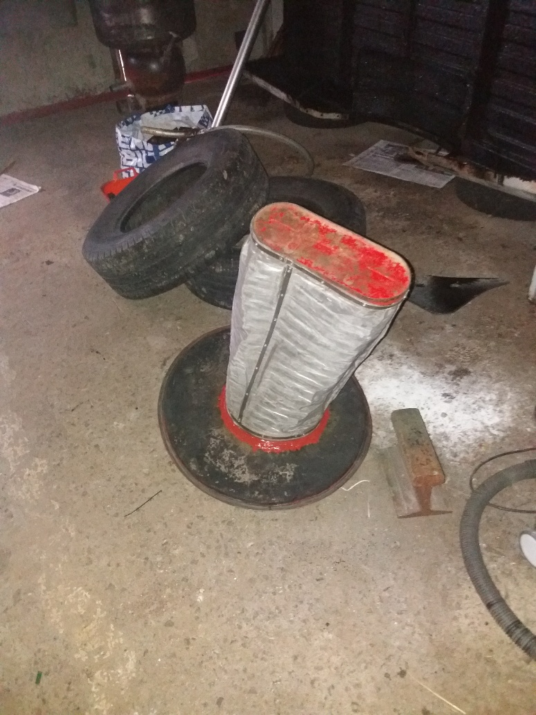

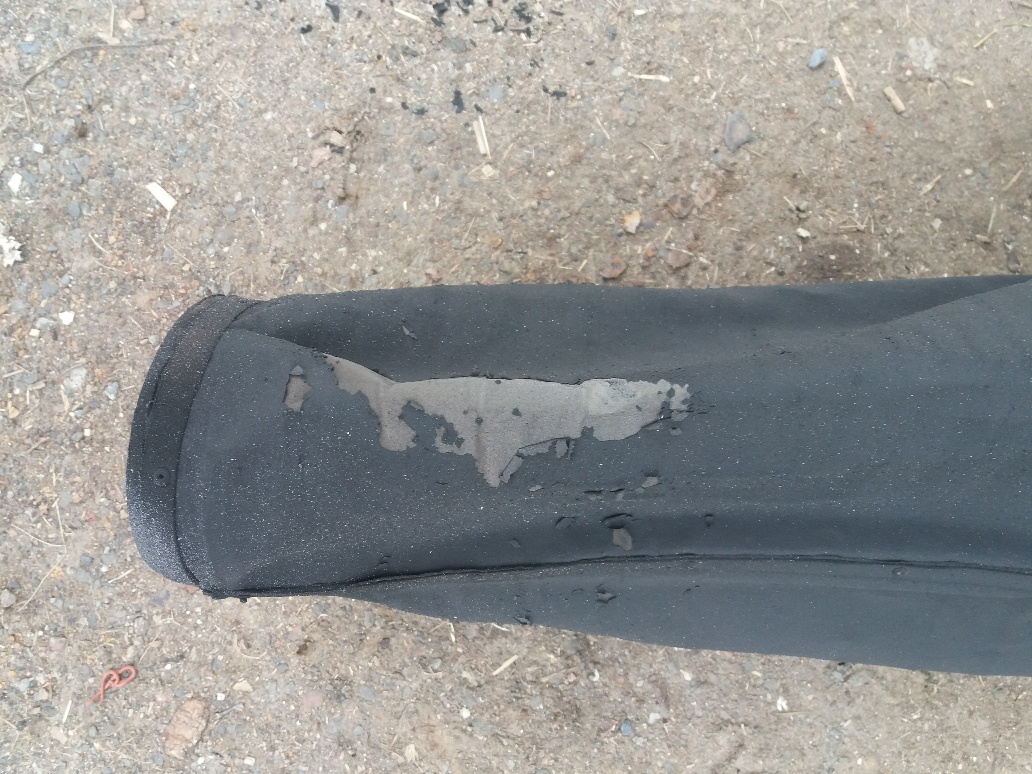

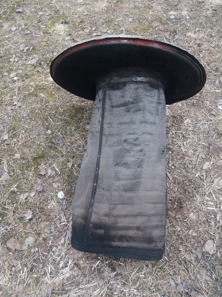

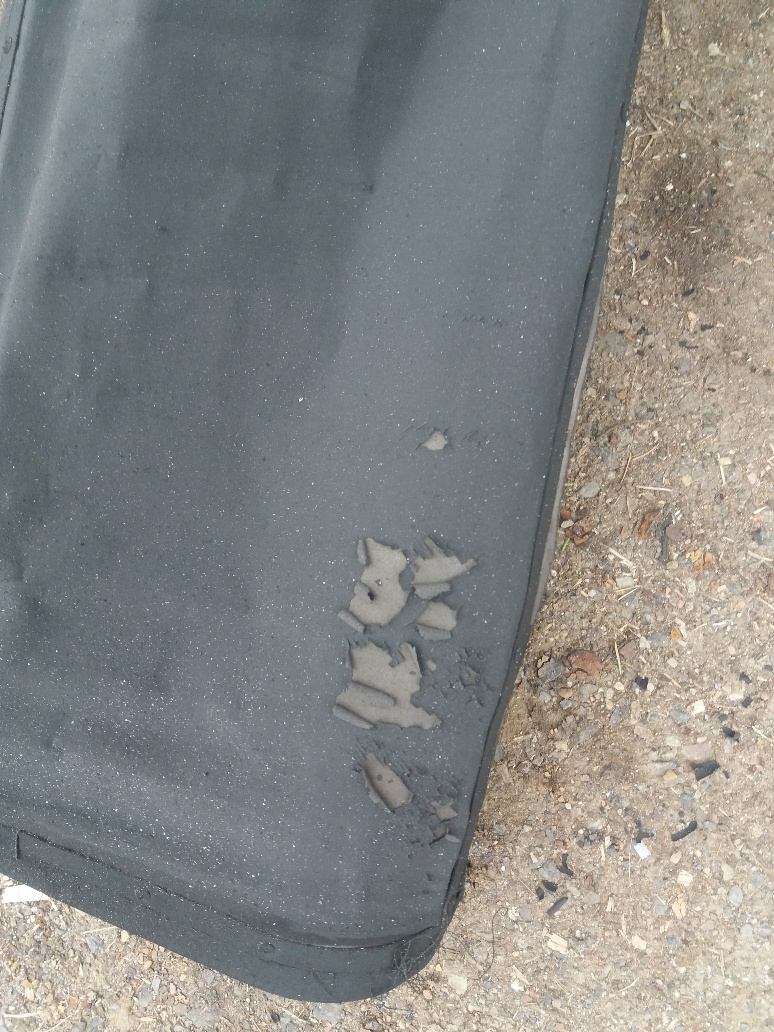

Tried a few rounds of wood to test the new filter, the gas looks good the flame is not visible at all.
But what do you think about the filter, it looks like there will be a membrane on the outside, it looks to come off easily, when I shake a little on the filter it loosens like cookies, will it work in the car, or will the filter get tight?
The last time I cleaned the unit there was very little coal during the narrowing, is it because I have too large pieces?
This will not work if I stand idle for a long time so the unit does not shake?

May be, and a combination with too sloppy nozzletips…
Sloppy airflow does not break up chunks very energetickly…
While the air has an easy going to find suitable “channels” between “big” chunks.
A somewhat narrower nozzle-tips increase the velocity to the price of bit higher vacuum… and penetration.

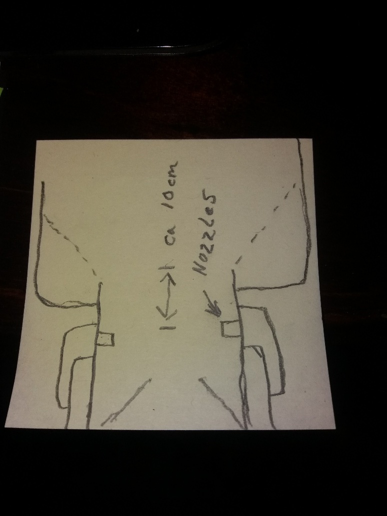

OK, I’ve tried to emulate this one, because it seems to work best (what I read) on moist fuel.
Mine looks like this, and since I have the tube only 22cm, it can probably affect both carbon formation and that it easily becomes bridges. (I think)
I wouldn’t worry too much about the firetube diameter. With small enough fuel (round limbwood if bridging) it should cover most of your driving up to 70-80 km/h. If you for some reason are in a real hurry you may want to add a few drops of gasoline anyway.
Oh, and where you have a 10 cm distance, I have only 3-4 cm. The entire funnel will eventually be covered with a mix of baked tar and debrie anyway.
Once you’ve been running things for a few months you’ll end up with a list of things you want to do differently no matter how many changes you do at this stage :smile:
We’re using the same type hopper vessel. I’ve noticed the thin ss is always cold to the touch at the bottom. If you want to keep condensation from getting close to the hot firetube you could put a slice of a 25-30 cm tubing down there, as a barrier. Even without it, I think over time, a tar crust will form and keep the condensation insulated from the protruding firetube. A cold void at the drain perimeter is enough.
