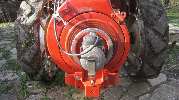

fortunately the other sd card works yet…lombardini running on chargas with acme magneto
on the picture is to see the signs of upper dead point and injection point on diesel, our magneto opens about 5 degrees before diesel injection point

open magneto during test run…
