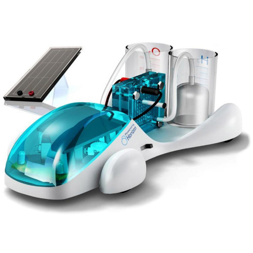

I agree that the added complexity outweighs any possible gains in Sam’s idea but I’m not one of the innovators here. I am interested in your electrolysis system Dennis. I have built electrolysis rust removal set ups but have not seen anything that would allow it to be used to amend IC fuel. This science project set up was the only thing I could find.
