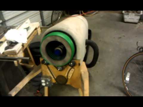

I have a 2-stage trommel that I made with 5 gallon buckets. The first stage has 1" holes, and a concrete weight that tumbles around inside, and the fragments from this stage drop into the 2nd stage with 1/4" mesh. This lets ashes and fines drop out. It’s kinda slow but makes nice uniform product.
The enclosure is the remains of a failed rainsoft appollo II water softener that just happened to be the right size and shape for this. The motor is an AC gearmotor, I could have also used a 24v wheel chair motor.

That is almost exactly what I had, but yours is much better construction. I just wrapped the drive belt around the bucket as a step down gear. The input hole really wasn’t big enough to get the shovel in so I added a chute.
