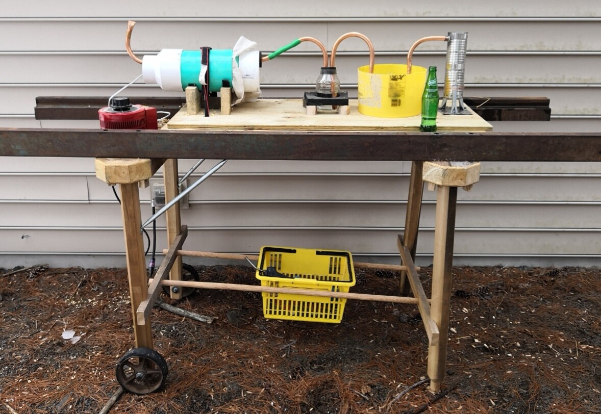

I decided to build my own test set-up with scraps that I had around and I’d like to get some eyeballs on this set-up.
I found a vacume cleaner by the side of the road which I tore down and put the brushed motor into the 6" green pipe shown. The pipe is packed with sawdust as a filter and I used unbleached linen sandwiched between the flange to back the filter.
An ice bucket keeps the pipe cool and that bublator should be extinguishing any embers before they reach the filter…
But, I can’t get it to flare.
Could it be the nozzle? Or, air leaks before the ice-bucket?
Thank you and have a nice weekend.
Does it try to light but won’t stay lit? Possibly too much airflow?
Is this a pyrolisis setup? Im a bit confused, can you tell more?
I don’t know if your reaction chamber is sealed tight enough. The top can’s lid is lifted and it is most likely introducing oxygen into your chamber which might be causing the issue.
Hi Joe,
This does not look as a pyrolysis setup but rather a small “gasifier” / smoke/tar generator…
A gasifier needs well adjusted components build together in order to make it work.
The smaller you start, the more difficult it becomes, everything depends the correct sizing.
In order to make usable gas you have to build with the principle that you can only let enter 50% of the air needed to combust the wood ( generalized )
The air intake ( inlet nozzle ) have to be well sized to get the wood /carbon glowing but not burning.
However, in case you want to build a pyrolyse unit, then the tin can , containing wood, would not have air inlets, but be heated by external source at a high temperature.
If you want to build / start with gasification at such small nice setup, then i suggest you fill that tin can with small / grain size charcoal and punch a tiny hole in the side where you can light up the gasifier.
(actual a very small Gay Gilmore Simple fire )
As airpump device i suggest a small membrane pump that creates suction but not to much flow.
If need any more advice to help you further, please feel free to ask opinions or guidance to any of us.

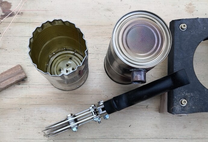

Also, showing some pics+details on the construction that could be useful for you:
The gaskets were made from 1" thick rubber flooring aka cow-matts and a hole saw. I picked up the material at an agricultural auction for cheap :smiley:
I used a 5 blade gutter crimper to fit the combustion chamber halfs together.

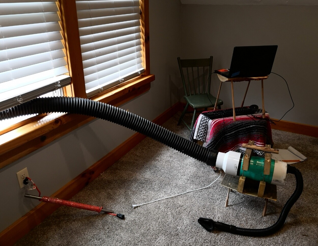

And, here is another view of the vaccume+filter.

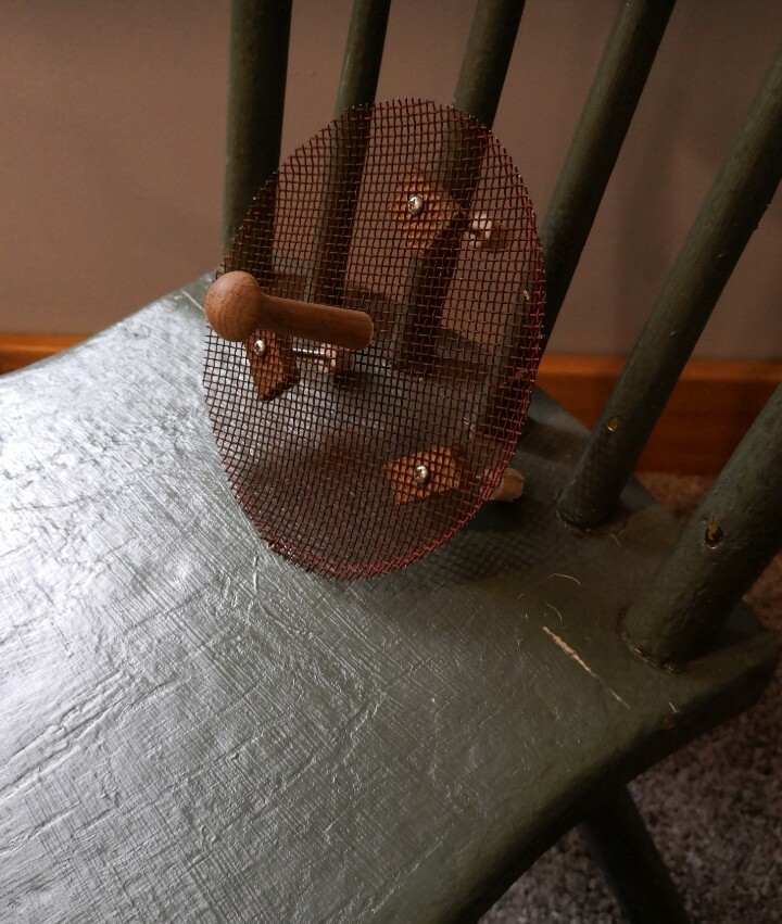

This is not a wooden satellite antenna, it’s a filter.
That filter goes inside the green pipe which you might recognize from my previous post. Yes, I’m using it as a vacume cleaner again because it draws too much air for my small gasifier.
