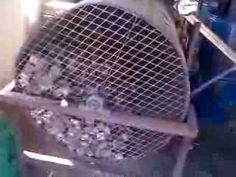

Here is a link to my youtube video for the moment.
Or you just search youtube for woodgas powered sawmill.

Was able to see the video. Impressive! How much of your sawmill can you actually run off your genset?
We found our 45kW would run lots of our equipment, but our bigger saws and molders required more starting amps than we could produce. Upgrade time or just tie into the grid with what we have. We were trying to avoid all the problems with the utility company. An electrician told us we would need 175 kW. I would have to calculate if our gasifier can actually produce that much gas. If it can, it would be at it’s limit.
Is it going to be worth it to you to invest in a drier for your sawdust and purchase a briquette press? The drier you could probably build yourself.
Hi April
I can run all of my saws at the same time as long as we don’t try to start them up at the same time.
My double log edger has two variable speed drives on it so it is the softest starting of the saws, which helps a lot.
