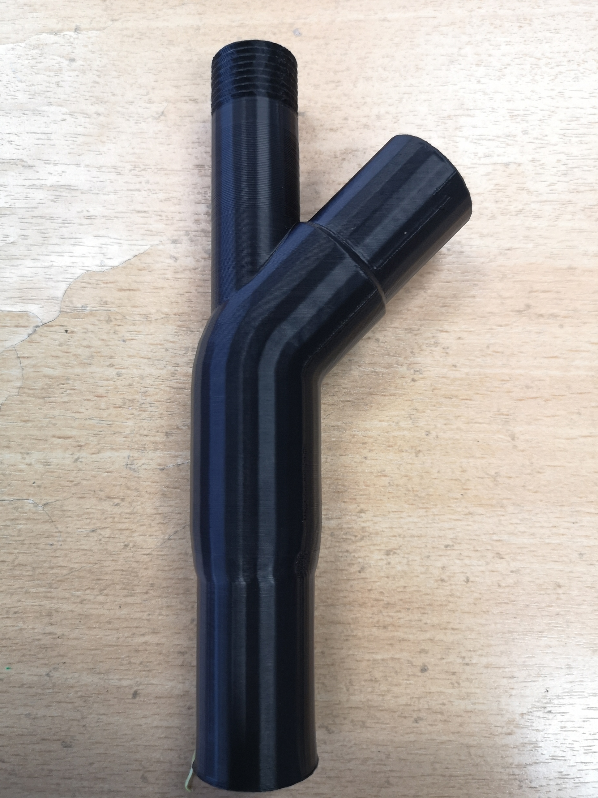

I make large industrial gasifiers, but there was a need to create a gas generator for the smallest gas generator, 0.22 liters in volume and 3 kW on gasoline.

Not many people know how important a properly made gas and air mixer is. For this engine, I designed and manufactured a mixer, as seen in the photo.

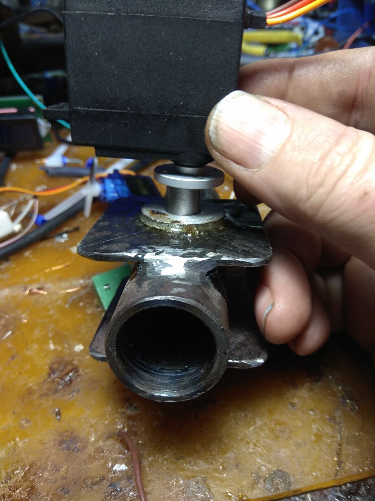

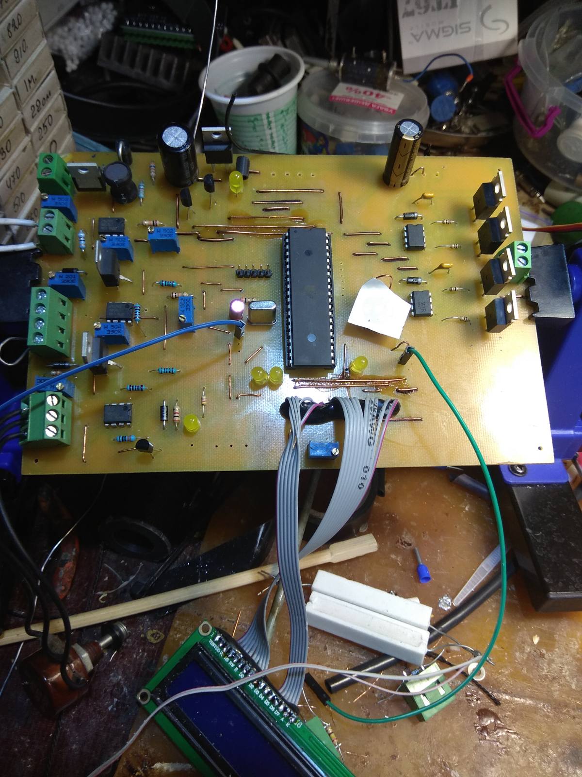

I also make an electronic carburetor that will control the air supply in automatic mode. Here’s a video.
 ![](https://img.youtube.com/vi/2N-Z8B9qI3w/maxresdefault.jpg)https://www.youtube.com/embed/2N-Z8B9qI3w?feature=oembed&wmode=opaque
I have a question. Has anyone already seen similar air management systems. Those that I found are very expensive and are used on large industrial equipment. And who sells small systems that catch alpha?

> [@Serg](#):
Hi Sergey
Does your air gas mixer work on the principle of a venturi?
the air enters at high speed and generates a slight vacuum on the central pipe which transports the gas?
do you manage to mix better (50% air / 50% gas) with this design?
Thierry
<div class="post-metadata">
### Author: ![Serg](http://forum.driveonwood.com/user_avatar/forum.driveonwood.com/serg/32/27746_2.png) [@Serg](http://forum.driveonwood.com/u/Serg)
#### Post date: [March 5, 2020, 10:13pm UTC](http://forum.driveonwood.com/t/sawmill-gas-generator/5126/6 "2020-03-05T22:13:15Z")
</div>
Yes venturi. Yes, it mixes well with this design.

You still need to regulate the air a little. With different gas compositions and different loads, it is still necessary to adjust the air supply. Yesterday we finished the electronic shutter which will do this automatically. We’ll test, take off - I’ll post the video. Existing systems on the market are expensive and for a large industry. I want to create a small one for cars and small generators.
