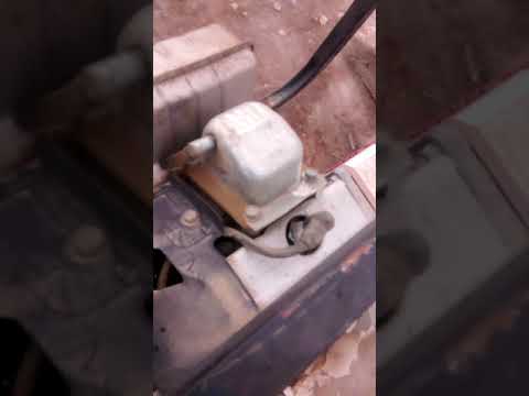

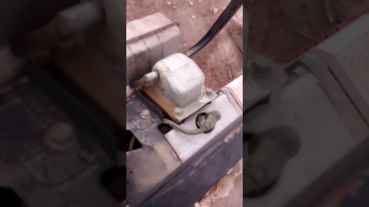

Do I need to load a video onto “youtube” and then from there to here?
I FINALLY went out and sized up the charcoal and got the generator running and am pretty darned proud right about now.
Yes, upload to Youtube and just copy paste your video link here. Congratulations!
SHAZAAM! Y’all might end up teaching me something after all if you can kick hard enough.
I know it needs a filter and some other “stuff”, but I really have to thank you all for all of the input you’ve had in making this thing work.
Congrats of your first generator engine run Allan , something i did notice was when you stopped the engine i could hear what sounded like a fan running ? did you still have the in line mattress fan running while the generator was running at the same time ? i have never managed to start my engines while the fan was running , so well done
Yes I did, but afterwards turned it off and the generator kept running by itself. After I do some changes I need to make a better video.
Hi Allan ok thats interesting , like i said before not 1 of my engines would ever fire up and run if the fan was left on .
If i can now make a suggestion , can you remove the fan from where it is now, that would then be a good spot to put your filter , and then you can use your fan to draw through from the very end of the line so when its ready and you have a flare you can unhook the fan and plug the hose straight onto the engine , that way your fan will not get a build up of soot and should last you a lot longer .
Cheers
Good call. Thinking on it now I agree that it would probably get filled with soot. Thank you.
