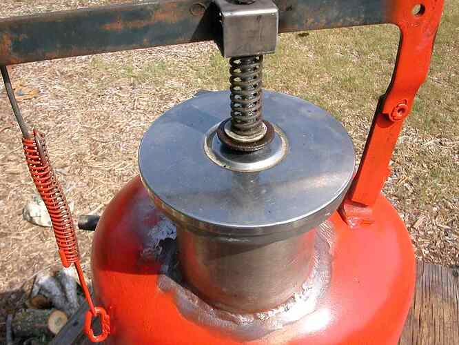

You said “do not think a puffer lid is needed for charcoal”. Please consider this would not be necessary for a coal gasifier while for a wood gasifier that is necessary?

Hi Thierry, I have been using puffer lids on my Simple-Fire charcoal gasifiers, just to be safe. Check out Gary’s latest video where he uses a round steel plate over the lid of a small grease barrel. I think that is the way to do it. Here is a photo of my puffer lid built on top of a Bain Marie that I TIG welded into a 6 gallon propane tank. The actual lid is from a stainless steel coffee percolater. The steel for the arm is from a broken recliner. I have either a silicon mouse pad or a silicon baking sheet as a gasket between the stainless Bain Marie and the lid. All of the Pfoof’s I have ever had have been out of the inlet nozzle, so it is best to rig up a mirror to use to look in at the color and shape of the glowing charcoal.

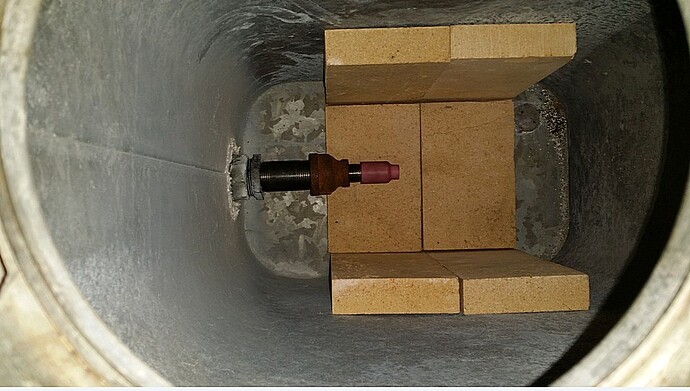

Does anybody know or want to guess how far from the end of a horizontal nozzle the hot fire lobe stays under normal operation in a SimpleFire? I want to sort of center it in my container and I need to know what size nipples to use.

I like the fire brick idea. Do you plan to secure them in there somehow? What size engine do you want to run this with?
I am going to try that high temp latex that Tom Collins was talking about to secure the bricks. I have a 12hp Briggs I want to try with this.
Hi Don, with that nozzle creating a higher velocity then a 1" pipe I think I would back up the tip so you have no more then 1/3 the barrel in length. That will give you 8" on either side of the lobe for insulating. Just a guess based on your 13hp sizing. I’m interested in knowing how the silicone holds up for the bricks. I tried maconry cement to hold them but it is inflexible. I ended up casting it.

Don; What are you using for a charcoal container? Yours seems to have flat sides which lend themselves to using the fire brick. Please let us know how the “Latex” works in this case. I feel it will be fine. There is a tremendous amount of heat in that area but there will be a couple inches of charcoal and then the fire brick to kind of insulate it. I’m working on a engine just like yours and hope that today was the last of the snow, so I can get out to the shopTomC.
