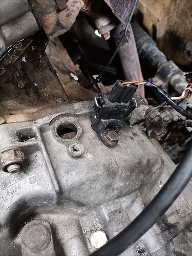

I’m not a fan of these sensors but I think the crankshaft sensor takes all it’s reading relative to TDC of the number one piston.
I have my distributor set at about 32° at idle, stock setting is 5-8° for gasoline. The high torque mini starter has no problem cranking up at this setting and the fly weights in the distributor max out at 45°. I never did run it on stock timing in woodgas so I don’t know that there is a power difference but I have never had a mixer box puff???
Good solution setup Kristijan.
Second hole mounting will physically only allow a minimum 10-15 degree advanced from the standard sensor position.
Now here is the uncertainty . . . . MANY later electronic systems put the crank sensor at a true 45, or 60 degrees ADVANCED from a true cylinder #1 top-dead-center!

Today l relocated the crank sensor.
Put it 3 cm forward on the flywheel, shuld corespond to roughly 10° aditional advance. I still have space for aditional 5°, but it might be pushing it.
The engine runs good on petrol. No cnock and good power.
Woodgas, ha! Thats more like it! I squeezed a nother 15kmh out of it on 100% wood, the engine likes to rev now! Much better torque too. Now l reached a point where l can say the sistem reached minimal standards performance wise, so that l can takeoff nice and stay with traffic without blending in any petrol. Its no race car thugh, still 80kmh is top speed. May reach a bit more if l throw the bed cover off. But this is good enaugh! And it runs on the same setting with both petrol and woodgas.
