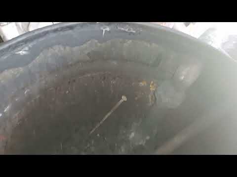

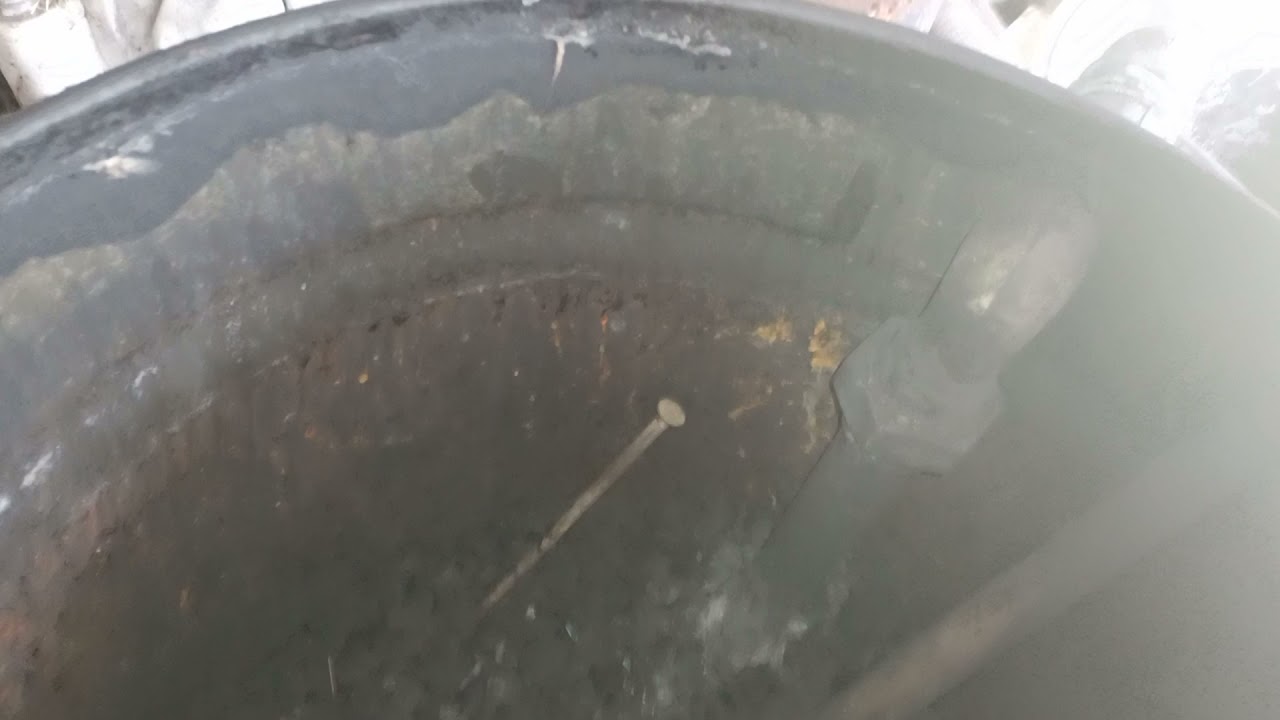

Food for thod. The proof that stainless isnt best gasifier material and why l only use it in my builds as sacrifficial plates.
Interesting, but yes, stainless has a slightly lower melting temp than mild steel. The only advantages are it doesn’t flake, it doesn’t rust and it’s somewhat insulative.
I’ve used 1.5-2 mm ss “sacrificial” plates in all my builds and I’ve never seen any wear on them.
Yours being a charcoal machine may run hotter. Also, I use protruding “nut” nozzles. Even if only protruding 1/4" they may spare the walls some heat.
But hey - they are called sacrificial plates for a reason
Yes on my new build, I am building I will be putting the protruding nuts on the nozzles holes with the plates also around them. Mike Gibb, you, and others have all had good results with this in the wood gasifier fire tube. Right, a .25 " is all that is needed to push the heat out away.
Good point to bring out for everyone that is build fire tubes.
