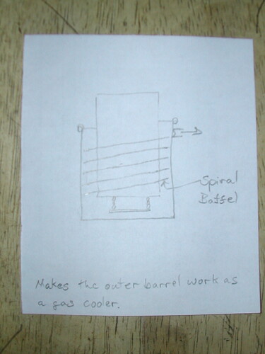

The barrel has loads of surface area but its a sluggish action happening in there with the gas. I want this. Means the barrel works as a dropbox and a gas reseroar to smoothen out gas quality fluctuations. And it prevents the localised hotspots or the barrel itself to overheat.
The test like l sayd was overpowered and the barrel got hot. How hot will it get in real life we will see but in any case its too hot to hook on a plastic piping.
Solution one is a roof cooling rack like JO has. But solution 2 is more apealing, l will throw it on paper now.
I like this idea, it’s a rudimentary cyclone, drop box, and sack filter! My little ammo can filter seems to be working great as just a drop box and sack filter I’ve pulled tons of soot out from the bottom already.
But primarly its a cooler, cyclones are excelent coolers with their turbolent atmosphere
Forcing the gas to go downwards also will cool it down somewhat, right? I know with distillation of alcohol, I will get some natural condensing before adding water when my output pipe is pointed downwards. Not sure if this applies to Producer Gas.
With slow velocity gas im sure thats a thing. But here the speed of gas is probably too great to show any effect…

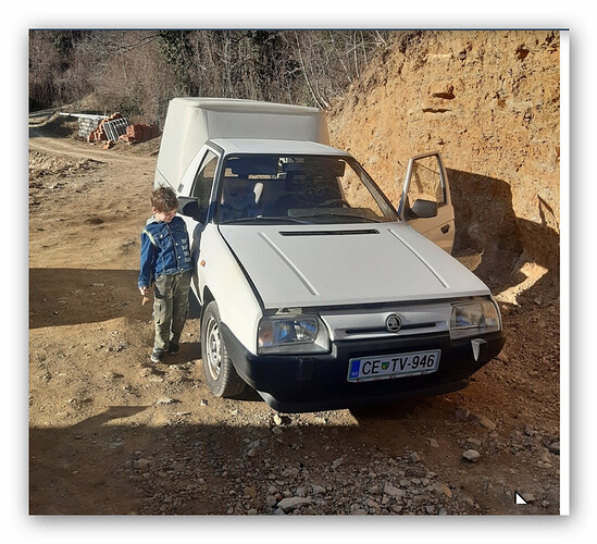

Kristijan do you plan on keeping the top over your pickup bed?
Don, I thought Kristijan would use the lighting port that he has used before at the bottom by the reduction opening.

Rindert, l thod of doing something like that and im sure it wuld work but l loose the gas storage/equalising ability. Also commenting to Bobs reply. Unfortunaly it turns out volume of gas in a pipe doesent help much, if anything it makes things worse as the gases have no way of mixing, they just flow trugh the pipe. Imagine if you leave a garden hose on the sun and then open the nozzle. First, there will be only hot water flowing out thei instantly cold water. There is no chance of them actualy mixing…
Put in woodgas terms (in case you dont have any big woodgas wessel) when you release the gas pedal, there is a sudden rush of super rich gas that fills the sistem (cooler, supply pipe…) then the gasifier cools and while the engine idles on the “old gas”, shitty gas is produced. If all the old gas is consumed at a long idle, the engine will start to dye. If you want to takeoff, forget about it. Untill there again comes good gas, no go. And you can have a mile of supply line, you will always have a “slug” of bad gas somewhere in there that the engine has to digest.
In a big volume vesel, the rich and poor gas have the time to blend/dilute each other before geting to the engine.
