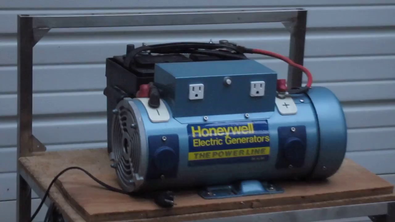

Anthony here is a video of the first widespread commercial application usage of the then new strong rare earth permanent magnets:
These were developed and used in service trucks, RV’s and man-lifts in the late 1980’s thru the mid-1990’s before true full wave inverters were developed.
I sought out and E-Bay ‘Buy-Now’ got five of these.
IF you can struggle to push out the co-axial dual wound armature from out of the Magnet housing . . .then the real problem would be inserting it back in without taking off a finger or edge chipping those hard brittle magnets. All of the since late 1990’s permanent magnet auto car starters etched this well to.
Thses are Redlines are nearly non-electronic. With just a discrete component control board that senses circuit connected then powering up a one or two constant duty relays for battery power. Easy to flip-switch On-Off convert for a totally non-electronics usage.
Yes. An electrical consumer. Versus your electric power making generator.
But the huge incredibly strong permanent magnets having to spin close; and fast; will be the same.
Even if these Chinese units are 95% efficient that 5% as heat will add up at 5kW to 8kW power levels.
I do not see enough foreced air cooling for long duty cycle using.
Color me as very skeptical. You buy. Then you are their out in the real-world Beta-tester user.
