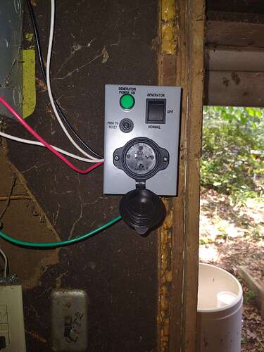

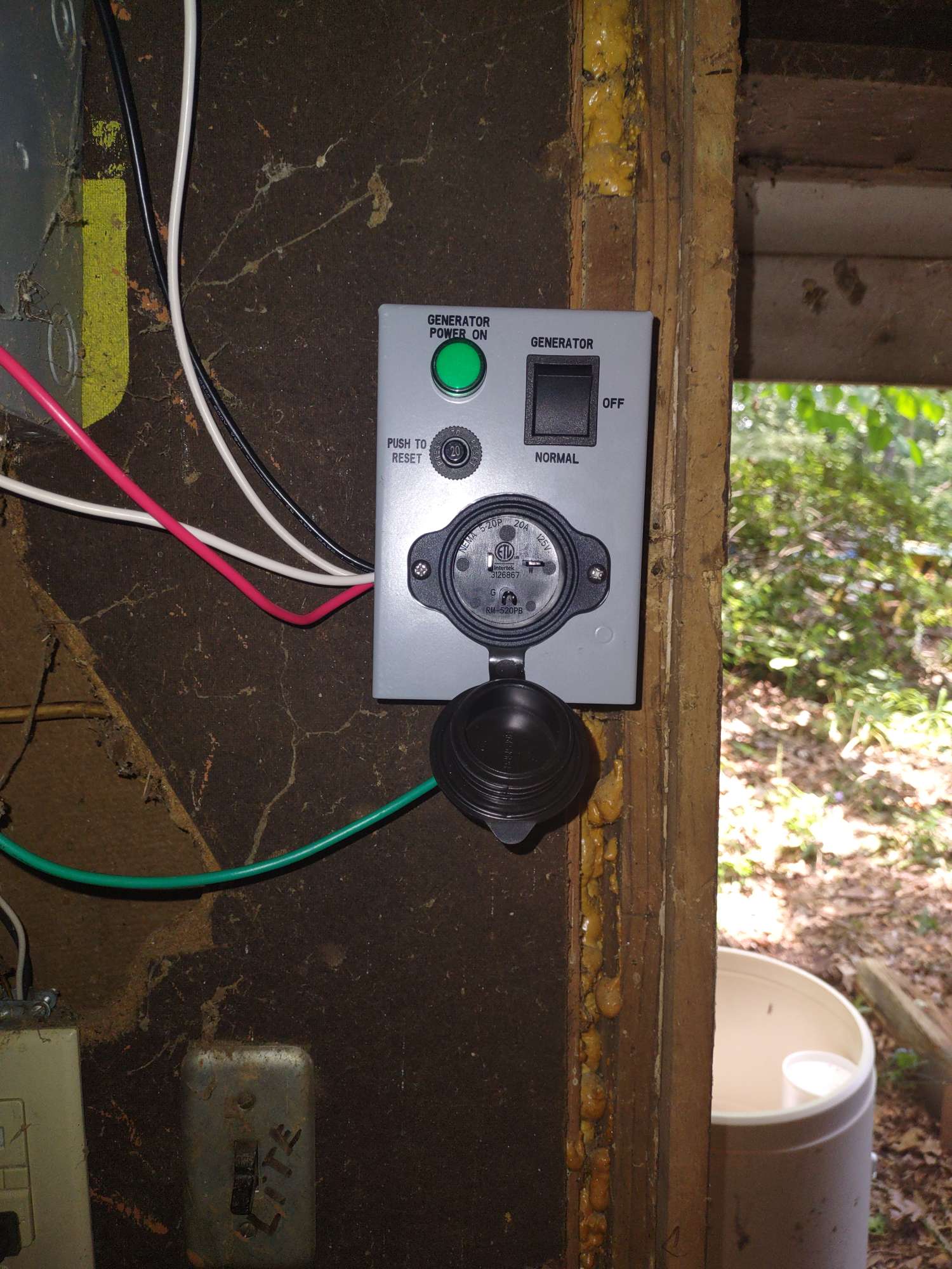

Well well well. I finally found a transfer switch that will work for the Well House. 20 amp with a 3 position switch, takes a 20 amp 120v cord for generator inlet.
I’ll use my older big Predator, the non Inverter one, to power the pumphouse in the event of a power outage. Overkill but hopefully it will be fuel efficient that way. Now to get an interlock for the house. We have a funky breaker panel inside the house that needs an expensive interlock adapter but now that I plan to power the well separately I should just have this one set up for only the house. Little bit of redundancy.
