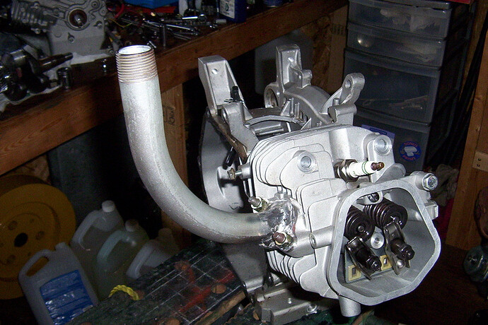

Here’s one of those big valve heads.
I paid $25 for an almost new engine that blew up from Kijiji.
It has provided all kinds of useful parts for projects and I still have this head I tinkered with ( was never fully ready to do anything with )
If you look at the bottom left of the image on the floor you can just make out another engine.
Its a partly stripped GV340…
Freebie that mighty make a good gasifier engine.

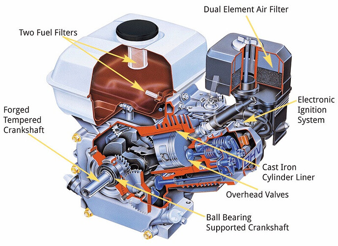

These are consumer level engines and they were made of aluminum and made cheap because that was what the consumer wanted and needed for light jobs around the house.
The companies that made these were caught on the back step when more robust designs with better quality could be had for not significantly more.
This engine has to fit where a Briggs or Clintons and Tecumseh engines fit.
Look at the compromises that went into make it cube shaped.
Thats a very short rod, almost too short.
It needs that Iron bore to help deal with the high side loading on the bore.
If the block has another 1/2 to 2/4 of an inch rod to stroke ratio it might have been suitable for an aluminum cool bore

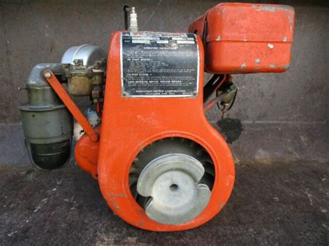

This is anything but cube shaped.
It won’t fit in the same places as its contemporaries.
But it retained a long rod and roller bearings and cast iron construction.
Thats why they quite making them
Just things to think about…
Observations:
The long rod long stroke Wisconsin has advantages in wood gas.
Lower side loading on the power stroke lends itself to lower operating RPM and slow burning low cal fuel like wood gas.
Everything else being the same…
You might be better served by using this type of hard to find engine.
It will require experimentation and testing to see if the GX is a better more long lived engine than all the others.
Maybe its the Wisconsin thats better with its easy to adjust timing and low RPM operation.

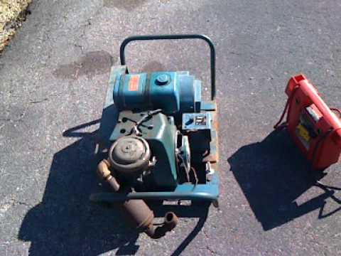

This is a brand new generator engine for the 3600 rpm screamer generators. I have two of these here with the rods hanging out of the blocks. I have considered buying the replacement engine. The engine price is $220 with shipping? Even with the new engine, the screamer generators aren’t worth $220, for a 5Kw. This engine is a good engine, for free, I have dozens. They are used exclusively on Arens Snowblowers. There are thousands of fifty year old Tecumsehs here, and they all die the same way. They begin to burn oil and then they run out, then the rods poke out the blocks. The reason they still operate is because we have some meticulous stubborn Finlanders here, who always check their oil before they hit the starter (snowblower engines all have a ring gear and a 120vac electric starter motor).
