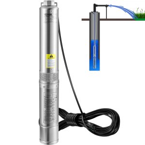

It might be cheaper to get a new pump… This one has a controller built-in, I don’t know if that includes soft start but I can’t think of what else would be on the controller that would be in a box. You would also need to replace the hose, and replacing the wire is usually good as well and you need the waterproof electric fittings. And some emergency rope to tie to it in case the wire and the hose breaks. And a bunch of chlorine to sanitize the well.
