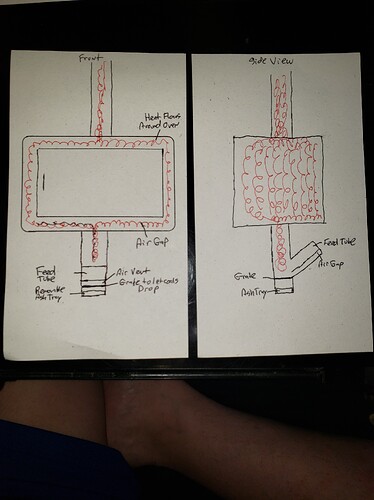

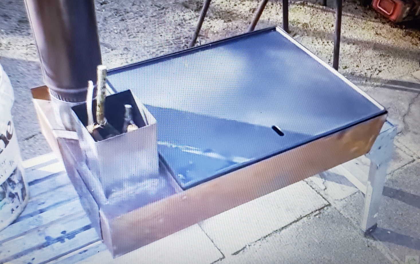

I eventually plan on building an outdoor kitchen for cooking in the finer weather so that the cabin does not get so hot.
Going to have a single burner rocket stove for doing one pot or making coffee or tea.
A rocket stove cooktop.
And a rocket stove oven. (Still in the design stages)
With plenty of room for preparing and canning the Harvest.

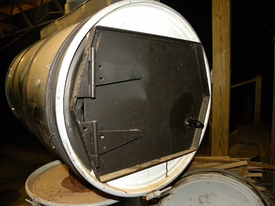

Hi Barry here are a few rocket stoves we have built. My Dad (Billy) and Dr. Larry invented the oven back in 09. It is made from 3 1/2 barrels the chimney inside the bottom barrel is made from lightweight stainless pipe surrounded by mud/straw mixture for insulation. The Heat/smoke goes up the chimney into the lower manifold between the split barrel and the inner barrel and collects in the top manifold and goes out the exhaust chimney. The two orange stoves are just rocket stoves designed by a man named Raphael. They are built out of bricks and they are stacked in a certain way to line up with the principles. They are called a 16 brick stove, we used more that that for the platform to build them on. We mostly use these for canning. The flat plate cook top can second as an oven if you build a box for it. It is made to cook directly on the plate or put a pot on it. Two of the most overlooked principles of the rocket stove is un-insulated fire boxes/chimneys and creating a choke point or a bottle neck. The second is extremely easy to do in the flat placha cook top stoves, just as a heads up. Jakob
I love them Billy. Very rustic and simplistic. Great for an outdoor kitchen.
