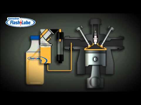

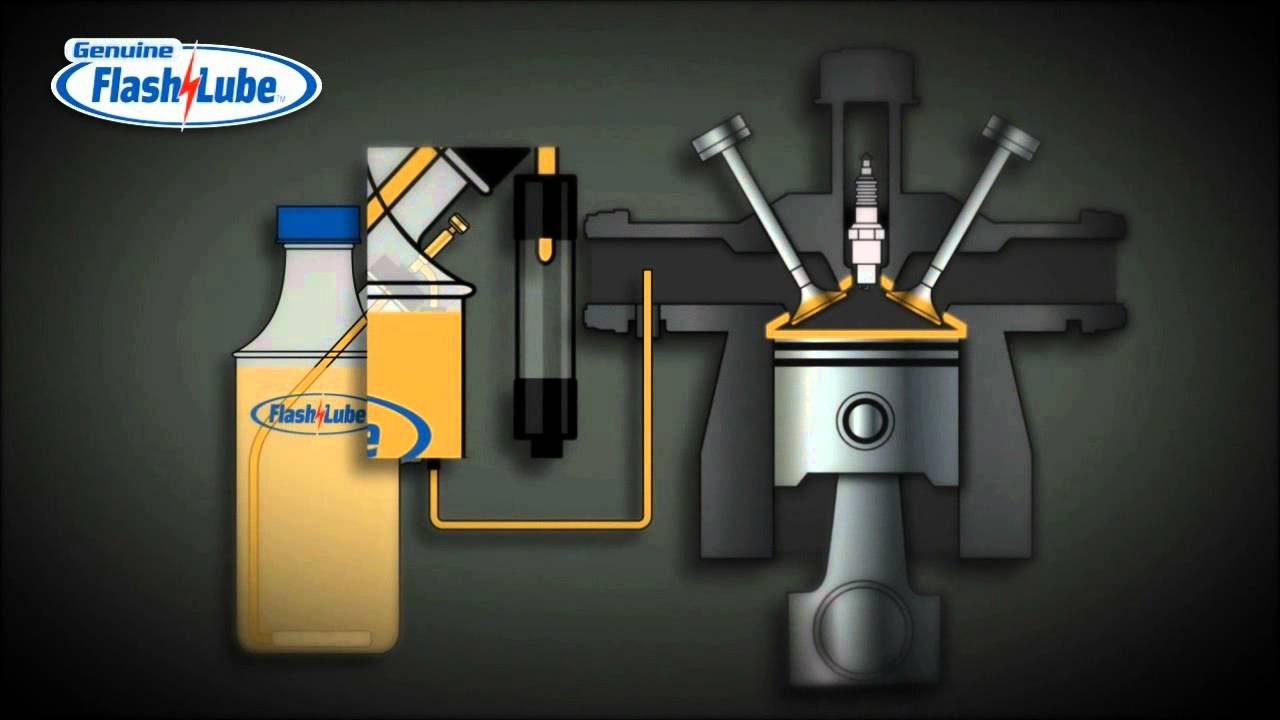

I faced the same problem of backfires with my Subaru, it happened at low revs and if I opened the throttle all the way. In such a case, the ignition is only a few degrees before the peak, because the centrifugal regulator does not increase the ignition time, and the vacuum diaphragm is released and reduces the ignition time. You can imagine that there is a full amount of mixture in the cylinder and if ignition occurs, high pressure is created. The gas and air mixture is relatively dry and does not lubricate the valve seats, which means that they do not seal 100%, so the flame can escape and ignite the mixture in the intake manifold. I then installed a valve lubrication system in the Subaru and these problems practically disappeared.
valve lubrication when using LPG,… a simple system, also interesting for water dosing, or for lubricating flaps and valves when using wood gas, any oil is good, even used, it is good to dilute it slightly with diesel fuel
You are right Tone!
Already during world war there was “top-lube kits” available for woodgas cars, was said to reduce backfiring, i have never thought about it until you, professor Tone bring it up. :smiley:
I post a pic of one of those old kits later.

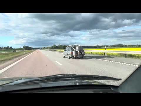

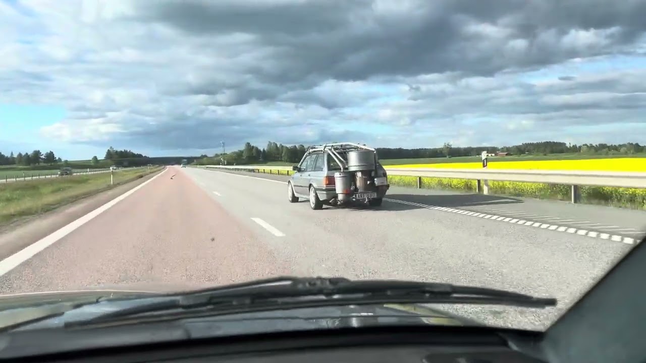

I almost forgot, I made a video on the trip home after the meetup and it turns out to be pretty much undeniable proof that it is impossible to overtake a woodgas vehicle. Per is not letting us pass :grinning_face_with_smiling_eyes:
Yeah, that was close to 70 mph and no more woodgas power to add :smile: At that speed wind drag is getting very important. Only if I had been able to let go of the box on the roof I may have been able to pass :smile:
110 km/h requires about 30 hp (rough estimate for such a vehicle), the Volvo 2.3 l engine rotates at about 2700 rpm at this speed. Is your system working optimally?
A wood gas engine should reach 5kW per 1l of working volume at 1000 rpm, if it works optimally. Now we can calculate how much power your Volvo would develop under the above conditions…
multiply the working volume of 2300 and the engine speed of 2700, divide the result by a factor of 200 and we get 31 kW.
Maybe I underestimated the power of your car at the beginning, maybe it works closer to 30 kW than 30 hp…
