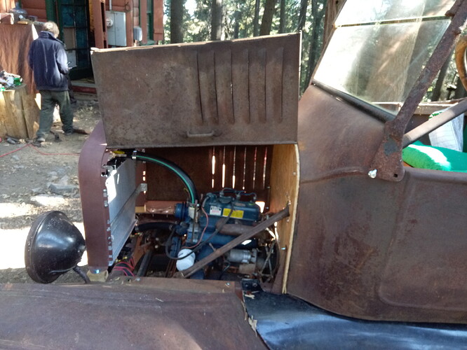

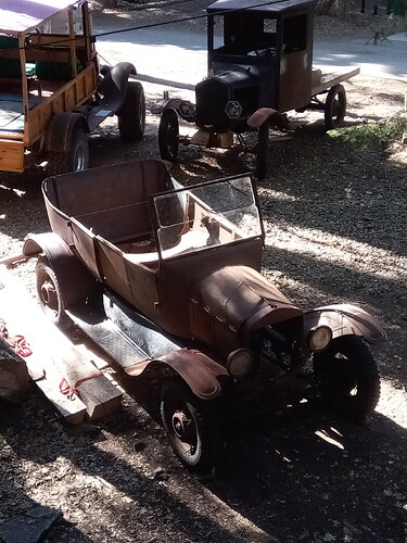

i have 1925 ford model touring car with kubota 600cc diesel we run it on waste fry oil
I would like to see pictures of that.
That is very cool. Where do you live? A little stark on the interiors.

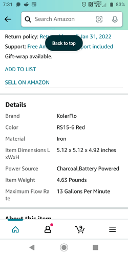

I couldn’t find that. I checked Kolerflo and Amazon. Could you link it?
