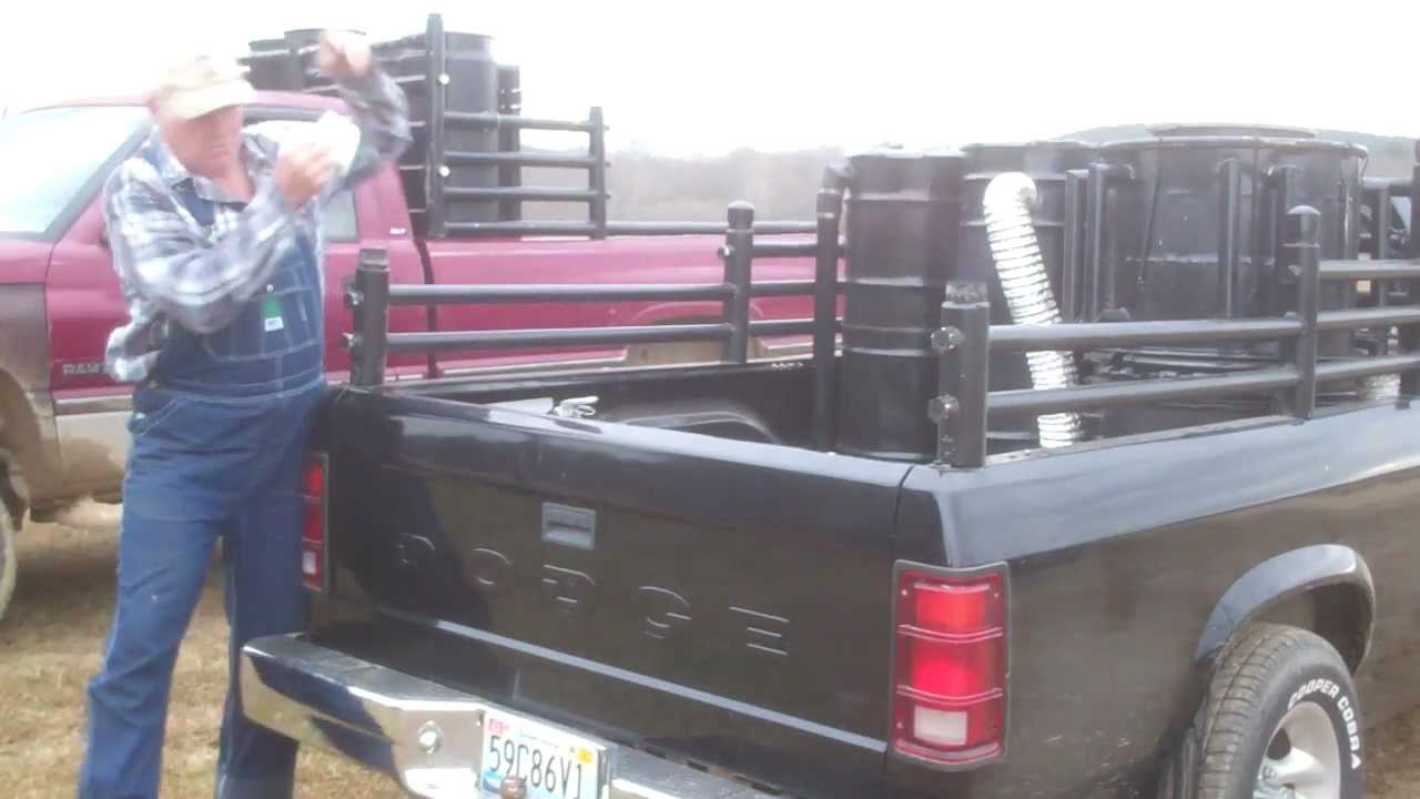

Hi Al; You say you have a lid seal that does not leak under vacuum. Could you explain what you have? You can see it leaking when you shut down but you say it is not leaking under a vacuum. It makes sense that the vacuum would help seal it, but how do you really know it isn’t leaking under a vacuum? TomC
Hi Tom, I will try to explain, If I turn the blowers on with the system closed, the vacuum gauges read between 5+10in. No leaks! My lid does not leak at shut down either. I would post pictures, but this new site says my phone pics. are too big.

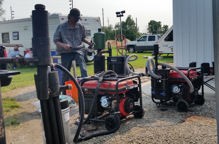

Don’t want to hijack your thread but here is a very short video .
Mr. Wayne; I have seen all of you fellows flare many times down at Argos. I have flared the basic gasifier on a couple of builds while they are sitting on the shop floor, without cooling, filters or anything except a 20 ft pipe and a Kirby. When I mount them with all to other goes intos they don’t just flare off like yours. I rely on flashing in the hopper. Other than that if it starts and runs I say a prayer for no tar.
