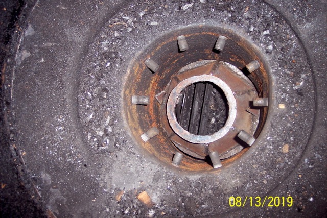

Jan; that was the one that resembled a WK with no nozzles in the holes and a large restriction 10 in. below my nozzle holes. Also no grate. Quite quickly I saw flaking around the nozzle holes. A problem the WK’s had. They cured it with “heat sinks” welded just below the nozzle holes.
I just cleaned my hopper out for an inspection. I had put this inverted cone, with nozzles, and grate in.
100_3043
I couldn’t get it to generate gas. After setting for a couple of days is when I found the accelerator locked up. When I cleaned/inspected the hopper, I found the inverted cone had come off the pins that held it. It dropped down an inch or so and sat on the char in the ash pit.
It didn’t make gas, but it must have gotten hotter than hot— the metal on the grate and the cone flaking like de-lamination or something. Very little signs of white ash in among the black ash.
Have you made any changes yet? Like raise the grate up or even tried running charcoal in with the wood.? TomC
I have only inserted larger nozzles than, have not driven that much (hay salvage) maybe driven 30-40 km, it seems that it got better at idle with 12mm nozzles.
Thought to try to go a little further now that I’m done with the hay, but suspect that I either have a leak or that the wood is still wet, cooler pipes get hot on both sides, and they did not do that before.
It was weird that yours did not make gas, does it get too much oxygen so it burns up the gas?
Would be interesting to put in a little bigger restriction, think Kristijan is right there, but is afraid of tar when I drive so slowly when we look at animals.
