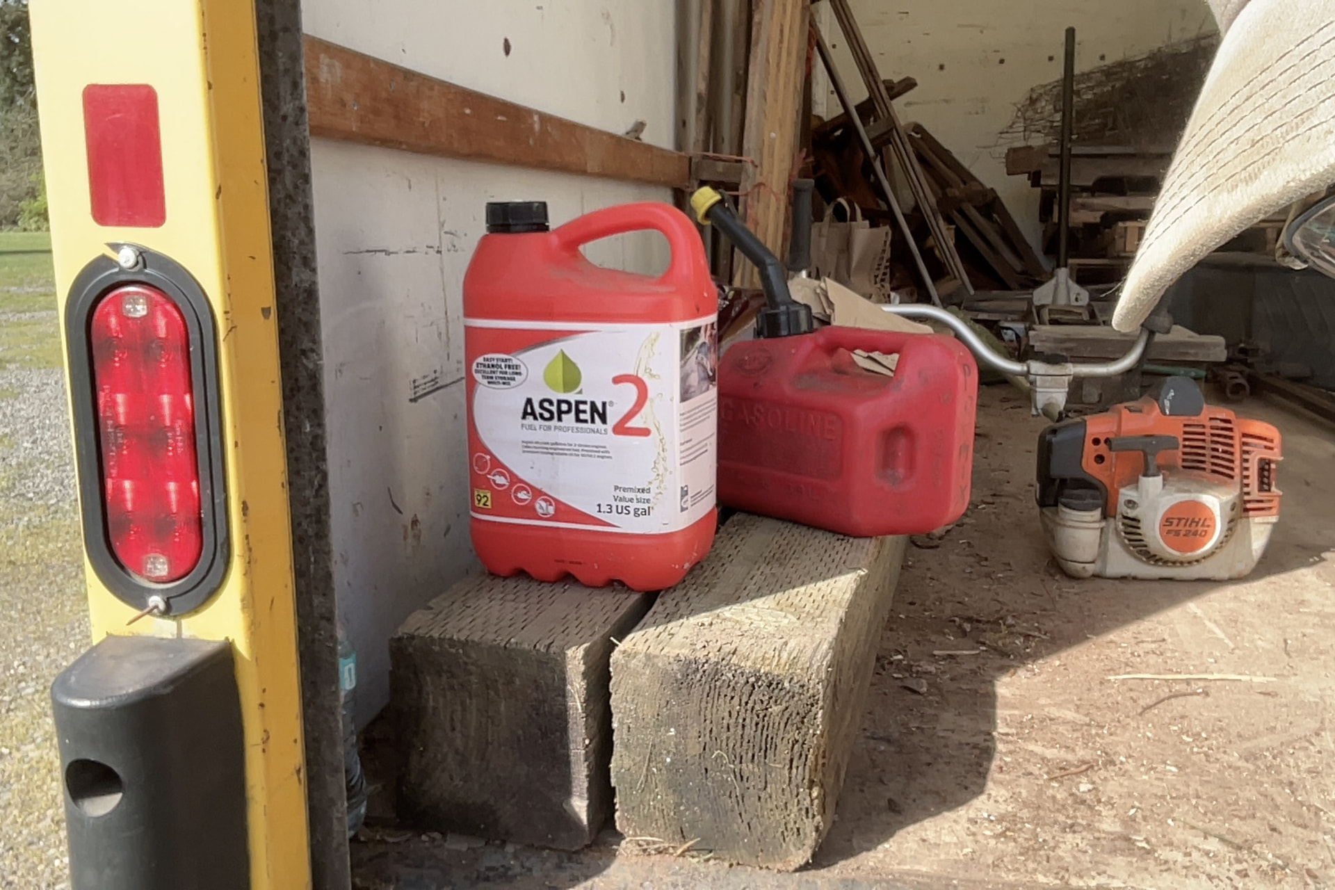

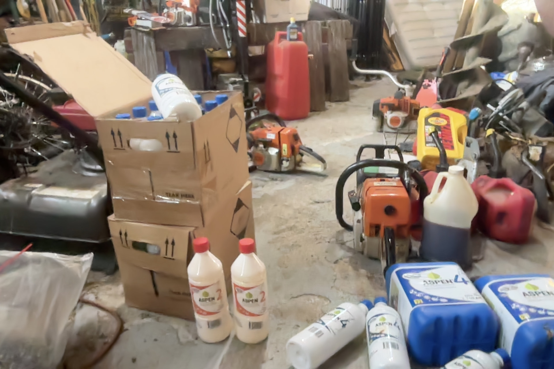

Hey! Good news for me. I found a logging supply outfit that had dragged out their old stock of Aspen selling for their original cost. Only $4.50 USD a quart (.946 mL). Only $45.00 USD for a case of 12 = 3 US gallons. Be about $16.00 USD a gallon by the time I oil mix it. Cheap, cheap for any canned engineered engine fuel. So I’ll have enough for about three years. Shame, there was no Aspen2; the best value as the same priced here as the Aspen4. So you then get the mix oil for free.
So I’ll have to oil mix myself. Now why did I not keep any of those Aspen2 red “Value-size” 1.3 gallon jugs!?
Since I am not actually hours and hours; tanks after tank working with the Aspen I cannot vouch for fuel changing over problems. I’ve had no problems switching back and forth for 3-4 years now. I can vouch for long term sealed can; then use, storage. The only one of the previous Aspen4’s marked says packaged 4/10/2020. I had not problems using it up this Spring.
This new stuff not quite as old . . . marked 7/8/2020. Already maybe 6 years old. It will be ~9 years by the time I use up the last of it. I have no fears.
All. These white plastic containers are #1 PET. The blue are #2 PE-HD. It appears on-line for sale into the US the new stocks will now be in metal containers. Metal will certainly have recycling possibility. Plastics having contained chemicals and oils are land-fill buried.

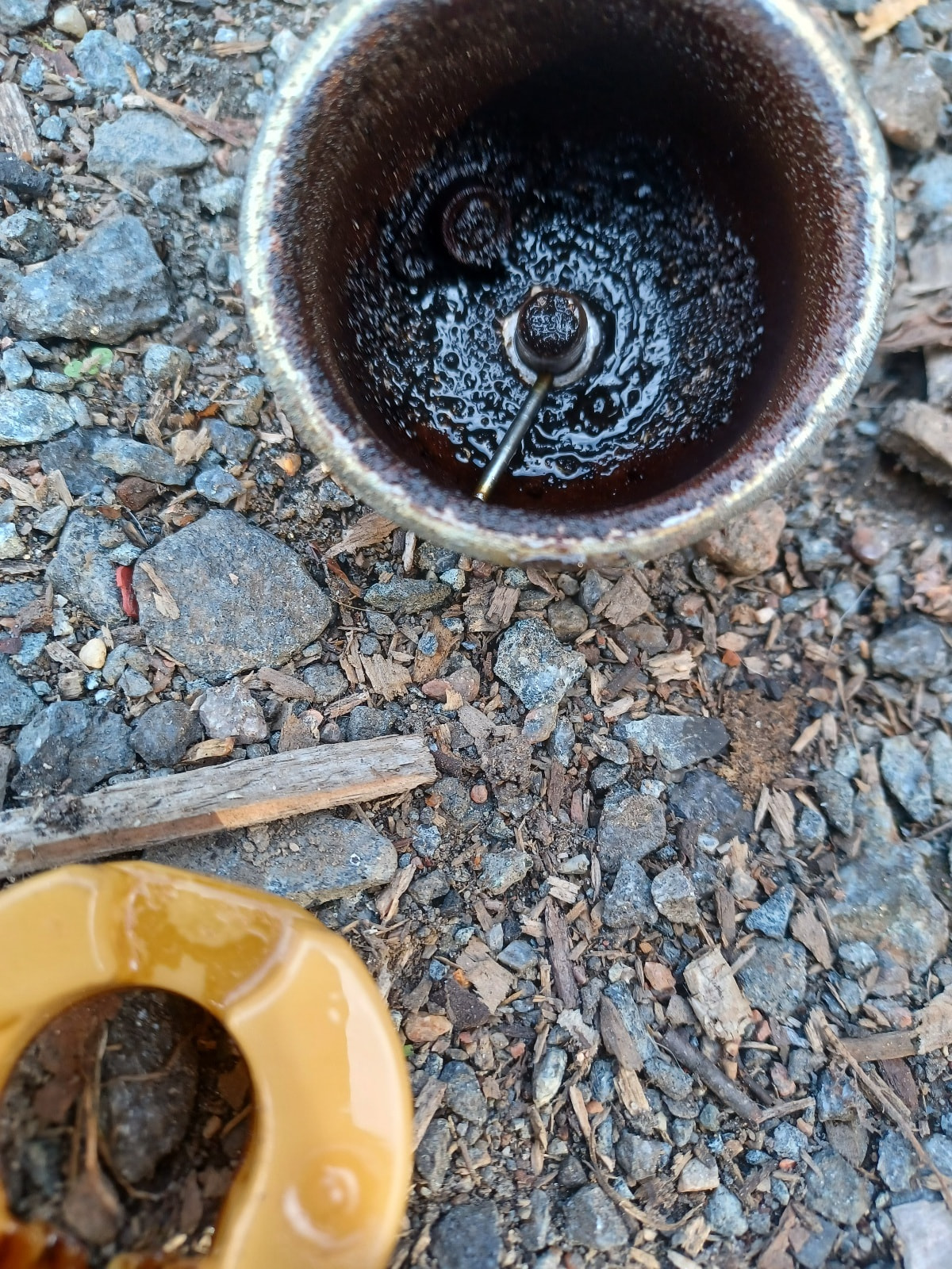

I feel a little to much as an “advocate” for alcylate fuels, don’t get me wrong.
Im not payed from the alcylate fuel companies :grinning_face_with_smiling_eyes:
It’s just that i hate how pump gas has become in quality…

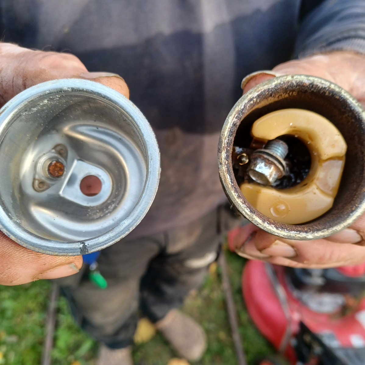

Here comes a example, that showed up today, i needed to pick some parts from some spare engines for a friend.
Please don’t take this as one of the silly television commercials (which it reminds of.)
Honda engine, has been standing outdoors (on engine) for 8-12 month’s since last running.
This is what Swedish pump gas can do. (This was cleaned when i got the engine)
At friends place, the clean bowl has been standing outdoors (on engine) for 5-6 month’s, has only been running on alcylate.

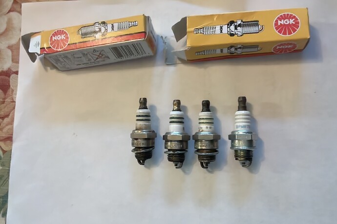

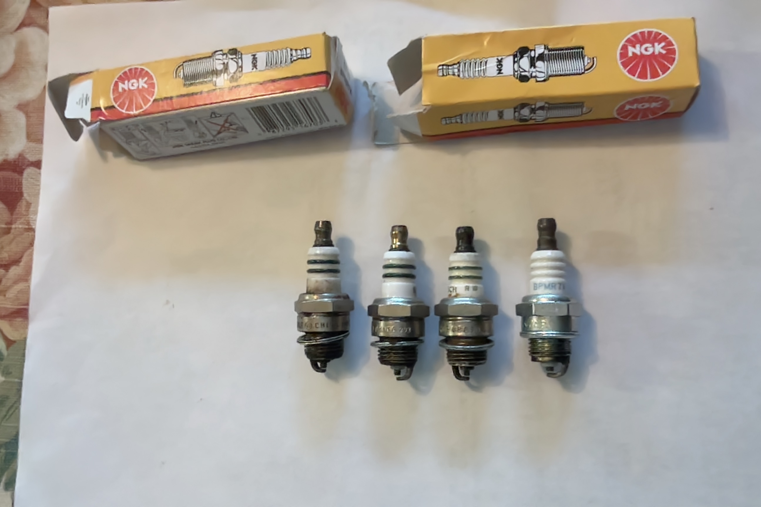

Before you do engine modifications BruceJ. try playing around with couple of different brands of spark plugs. The two I’ve been switching over to are Denso Iridium by recommendation on my four stroke generators. And even used, believe it or not, E3’s, #E3.12 in my Stihl 2-strokes. Not a problem loaded running with either. Both seem to help with cold and hot starting. Just hard to find to purchase.
Bosch for the Stihl’s haven’t said Germany for a long time. First Brazil. Now always say China. Stihl dealers supply NGK’s made in Japan.

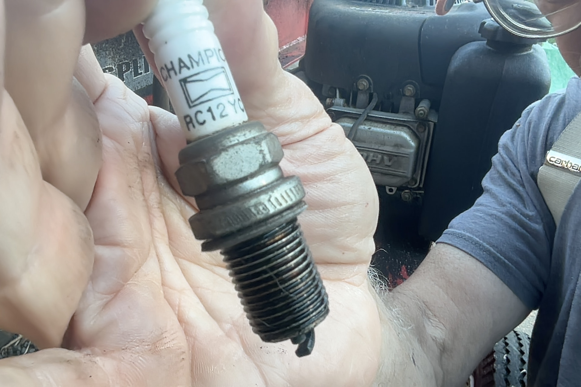

The old, old now woodsplitter with the cast iron cylinder Briggs and Stratton is my eats bad gasoline machine. Now how the hell did that Champion get in it?! I must have been desperate. I’m off tomorrow for an E3, #E3.20 I hope.
