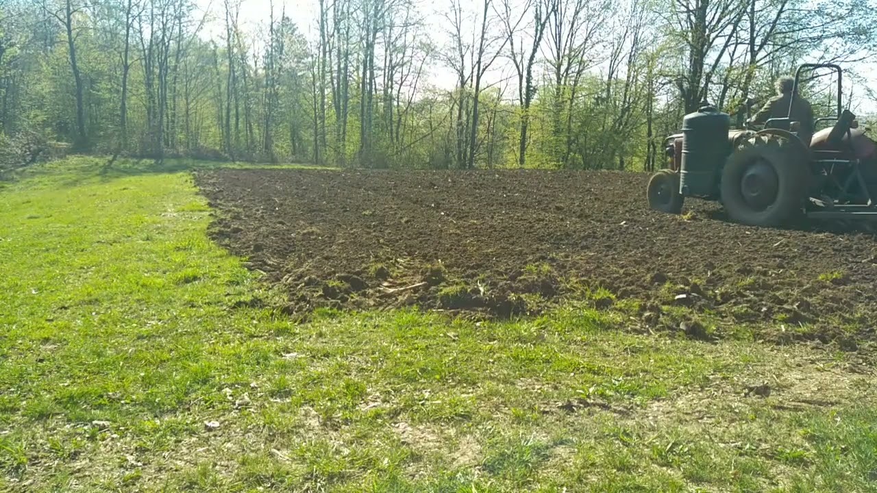

### Author: ![Tone](https://avatars.discourse-cdn.com/v2/letter/t/71c47a/32.png) [@Tone](http://forum.driveonwood.com/u/Tone)
#### Post date: [April 6, 2023, 4:09pm UTC](http://forum.driveonwood.com/t/tractor-with-gas/6182/1060 "2023-04-06T16:09:48Z")
</div>
Preparation of the field for planting, of course powered by wood gas, …
[![](https://img.youtube.com/vi/Qb6spGxF9rA/maxresdefault.jpg "delo na lesni plin") ](https://www.youtube.com/watch?v=Qb6spGxF9rA)

Tone, I’ve lost track. Is that on glow-plug-100%WG or on 10%diesel?
<div class="post-metadata">
#### Post date: [April 6, 2023, 9:20pm UTC](http://forum.driveonwood.com/t/tractor-with-gas/6182/1062 "2023-04-06T21:20:24Z")
</div>
Hello, JO, it runs on 10% diesel 🥺🥴 , I did not insist on the development of ignition with glow plugs, if time allows, I will install spark plugs this time, I got a complete ignition system for a three-cylinder engine, which I plan to install on a tractor.
