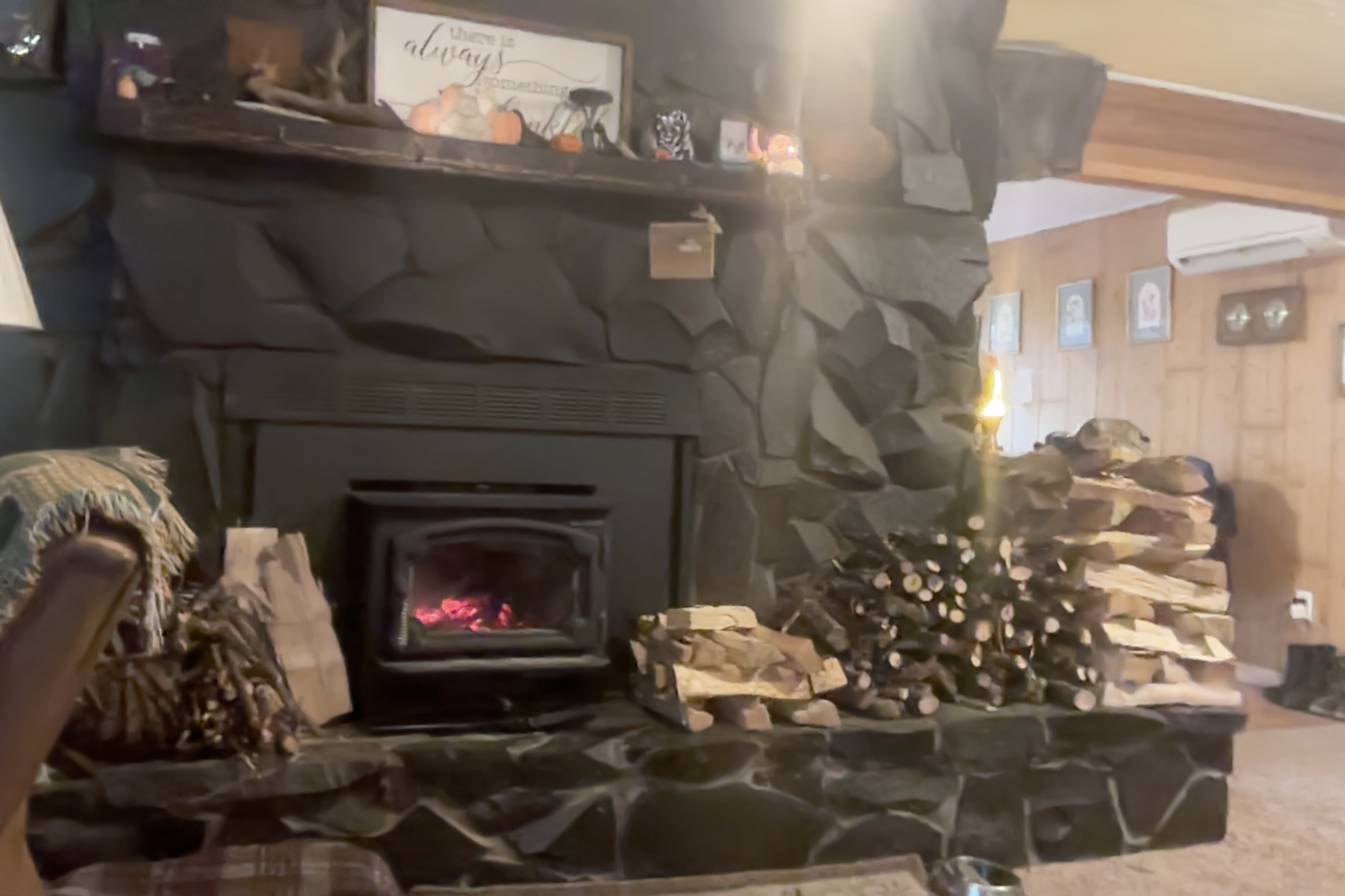

I do harvest and burn a lot of limb-wood. Actually prefer it as long as my bending-over; picking-up-the-many pieces, back and patience holds out:
This limb wood pictured has set for three years mostly off the ground drying/ seasoning. It is very dry coming off of a long summer.
The white trunk splits off of the same tree, the same 3-years; but bark insulated covered did not dry much over the summer. Three years of winter rains soaked trapped inside under that bark. They now exceed the moisture weight of a fresh cut tree.
I aged; and cannot get my wood worked up in our 100 days of drying summer anymore.
And the three trees downed 3 years ago, are in the way if ever we need a well service truck.
So I just had to work them up to get them out of the way. This year, I could with ankle-braces, pain pills and beer . . . next year? Maybe. Maybe not.
And I will burn this wet wood for heat; visibly smokeless; and not glass sooting, using every single “cheat” trick in my experiences.
Get the wet splits crib stacks inside for 2-3 days of drying. Transferred over as last step up too-tight and close to the wood stove side. I feel for dried out then heating up, every time I walk past. Old man; the pee-needs calls me much.
First. I must establish this deep hot char bed with a combination of old boards and limb whiskers.
Dry trunk splits and I could then just it load up and go easy chair nap for 2-3 hours.
Nope. Nope. Wet wood; I have to work the stove then every 3/4 of an hour.
These 30-50% by weight too wet of splits, I have to go with two denser growth, dry branches sections first before every two trunk splits added. Otherwise the still too wet of wood will thermal drag too much for clean combustion. Will be thermal-dragging me down and use up all of the char-coal before the new splits can devolve and make more charcoal as char-bed replenishment.
Without an active charcoal bed you are not thermal-chemically woodgassing. You are steaming and stinky smoking.
