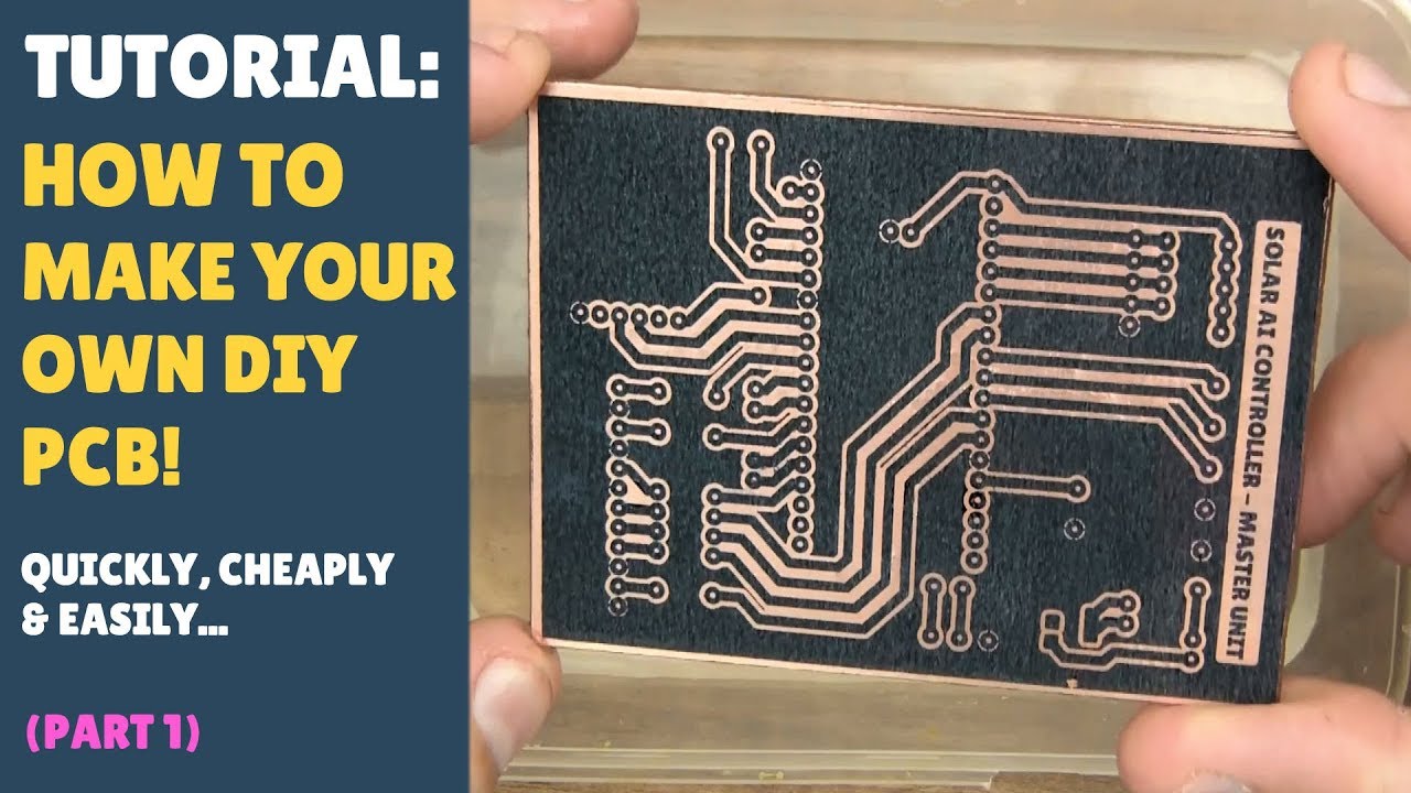

Hey Rindert; Vacuum gauges is a pretty important subject for gasifier. Could you go into a little more detail about these little gizmos . I read about one that would measure 0-40 kPa which I translate to 0-160 in. H2O. Obviously enough for woodgas work. You show the tubes coming from the various locations on the gasifier. They plug into a ācircuit boardā. What is that??? Four (?) wires go from this board to, I assume each post of a four position switch. Then a wire or two must go from the 4p switch to a gauge-- volt, amp, ??? Where is the power (+/-) for this. Sorry for having to ask, but electricity is kind of āblack magicā to me. I think this system may have a lot of potential for wood gasserās. TomC

Tom,
Do not be sorry to ask. If you donāt ask you will not learn.
The little pencil sketch I made is just to show a logical system, it does not show every wire.
A printed circuit board is perhaps better called a āprinted wiring boardā. There is a learning curve involved but after you have gone through it. Making these things is quick, cheap and easy. I think Antony Cartwright really does a good job of explaining.

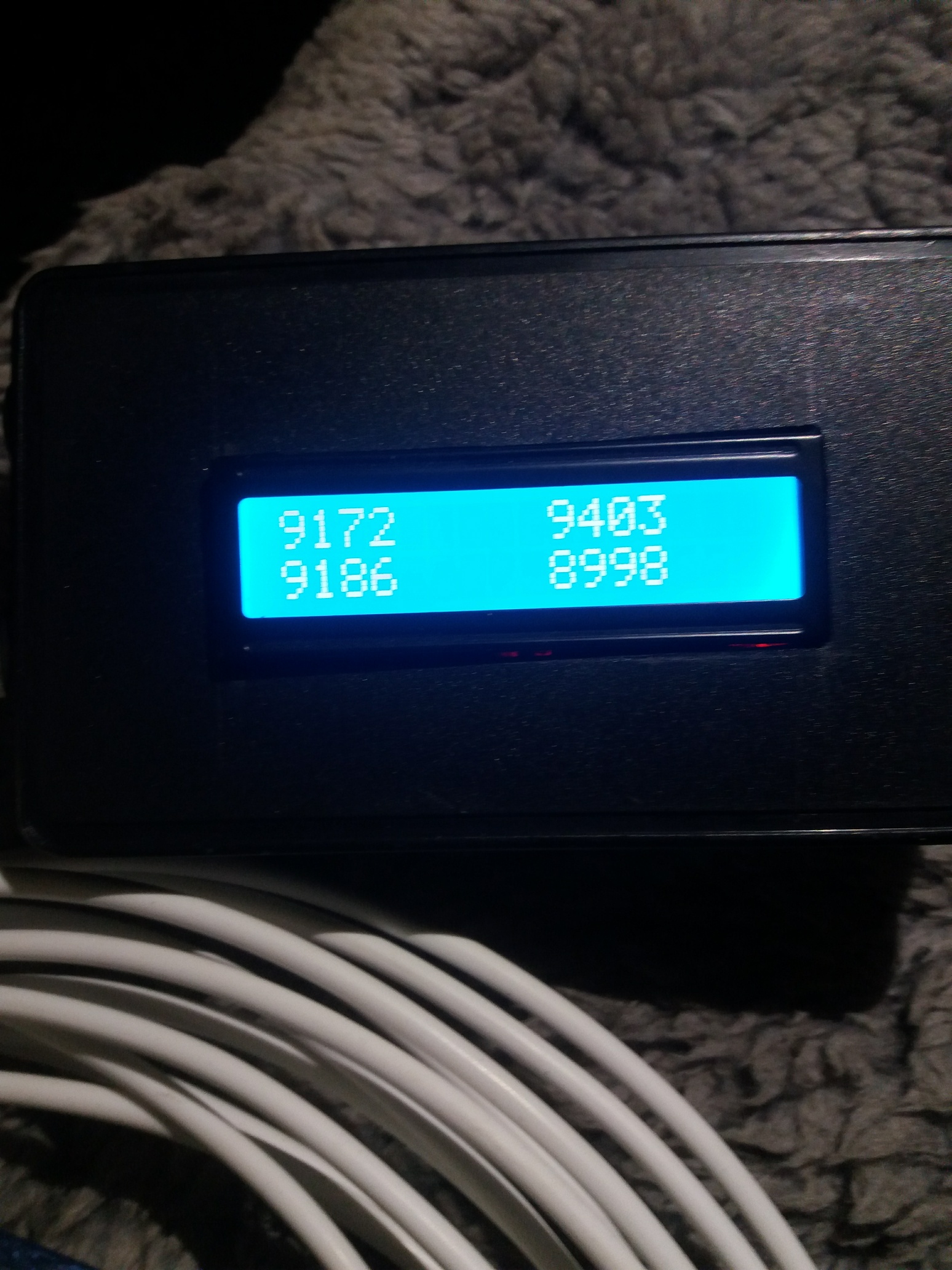

Hi @r_wesseling, I read about your sensors, are these for vaccum or just for pressure, I think it looks like they only work on pressure?
Microsoft Word - Introduction (webnode.com)
Jan,
Yes you are right. But, I think I can make those sensors measure both pressure and vacuum. You can see the small brass pieces in the picture. I am going to glue them to the backs of the sensor, in place of the square covers I removed.
