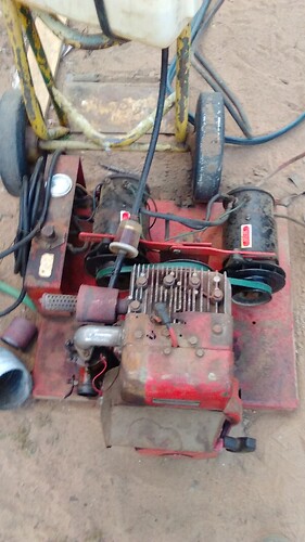

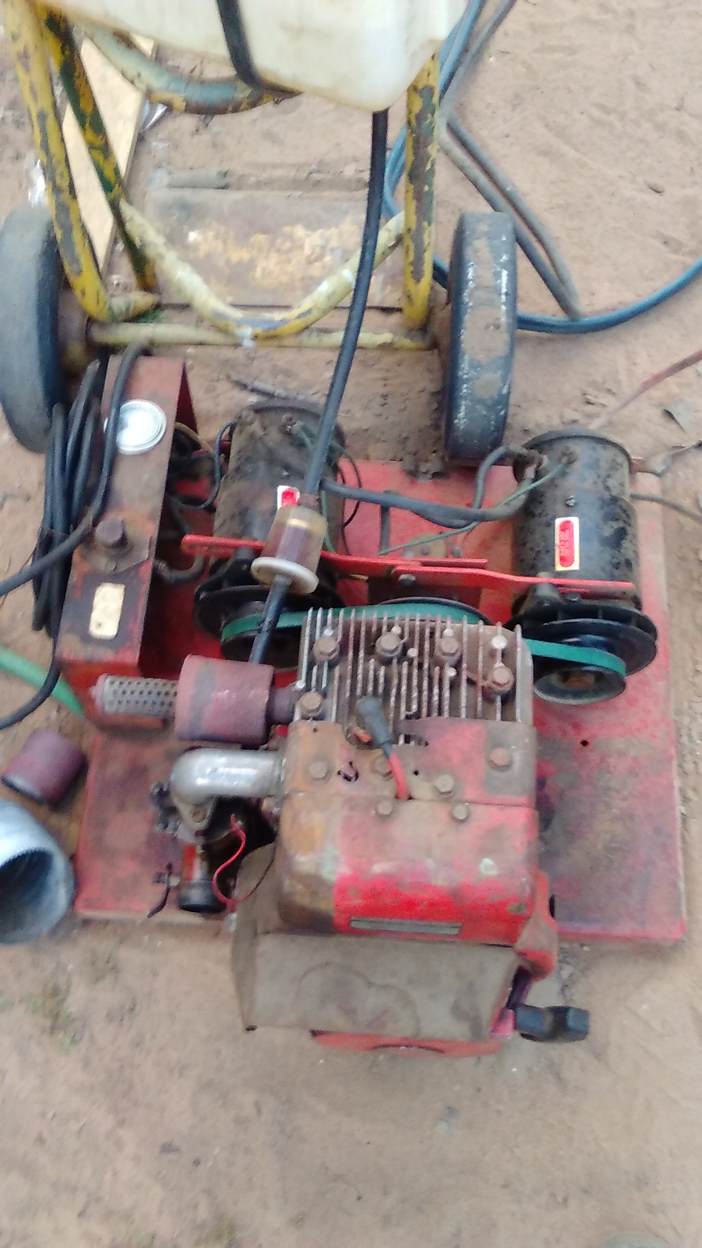

JI was lucky enough to find this on Craigslist .It is my new project and seems to do bolk charging quickly. Have not had much time to play with it but did get an engine and belts on it. I run it a bit but need go get it quieted down a bit. Will be using a gas water heater for a muffeler and stack. It is a Good ell starting/charging unit from a tow truck. It is rated at 300 amps. They are available new but go for about 5600 dollars. This is the platform for my new home built inverted generator. it came with a third generator for a smaller second unit. Fourtunitly I have just the right inverters for the job one 2200 and one 3200 watt constant duty.
Nice find Jim, sometimes you just look at the right time on Craigslist and find a great deal.
Yes Bob I look daily, I always find great deals but usually when I have no money or the time to make the drive . Every thing is 100plus miles one way it seems.

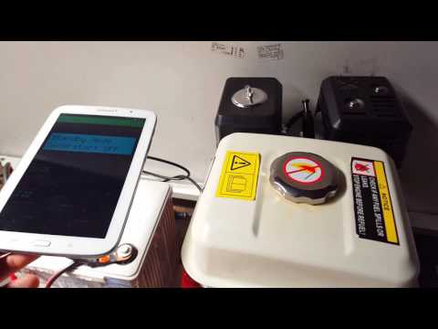

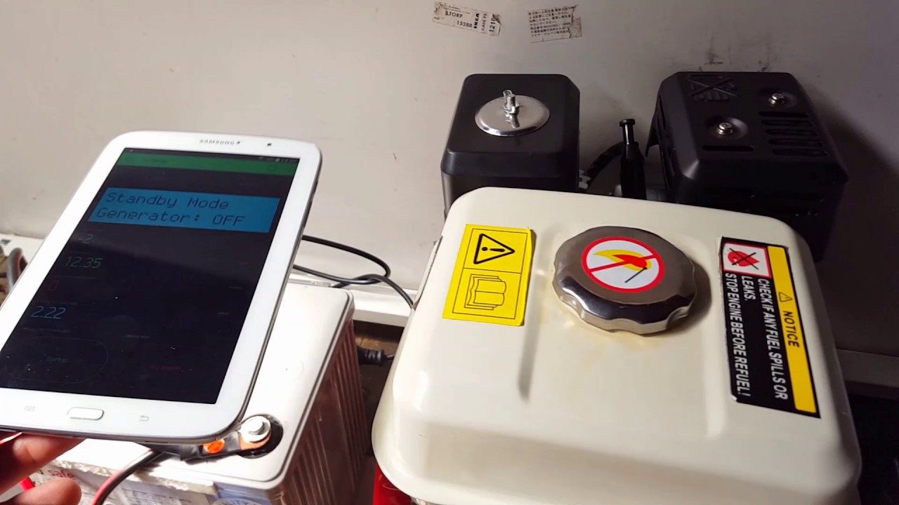

I have an adjustable 3 stage smart regulator on a 12v 120amp alternator driven by a petrol engine.
Here is a short video explaining my setup.

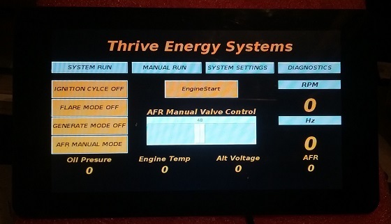

Very nice work!! this is exactly what I am working on now. I am using AIM’s and Schneider 48 volt charger controllers that both feature the auto gen start. This is exactly how these systems will work with the exception our gasifeir plant will go through an ignition cycle first before firing up the engine. Nice thing about wood gas is no choke required, we simply adjust air fuel mixture electronically.

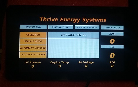

This the Raspberry Pi3 with the 7" touch screen this will drive several arduinos slave modules to perform specific task especially servos controls as they are better suited.
Hi Nick , and welcome aboard .
That’s a very nice system set up you have made for yourself well done .
