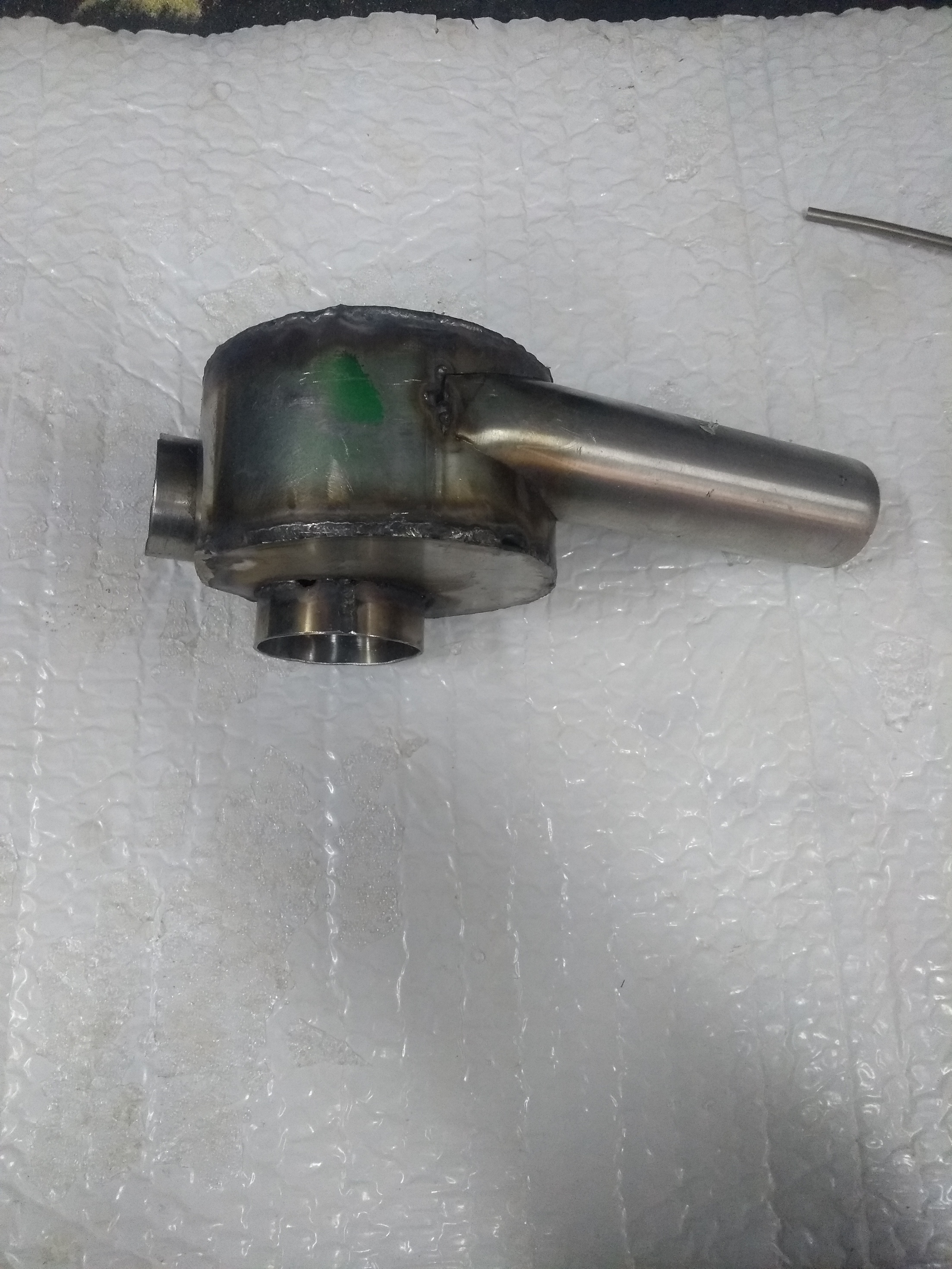

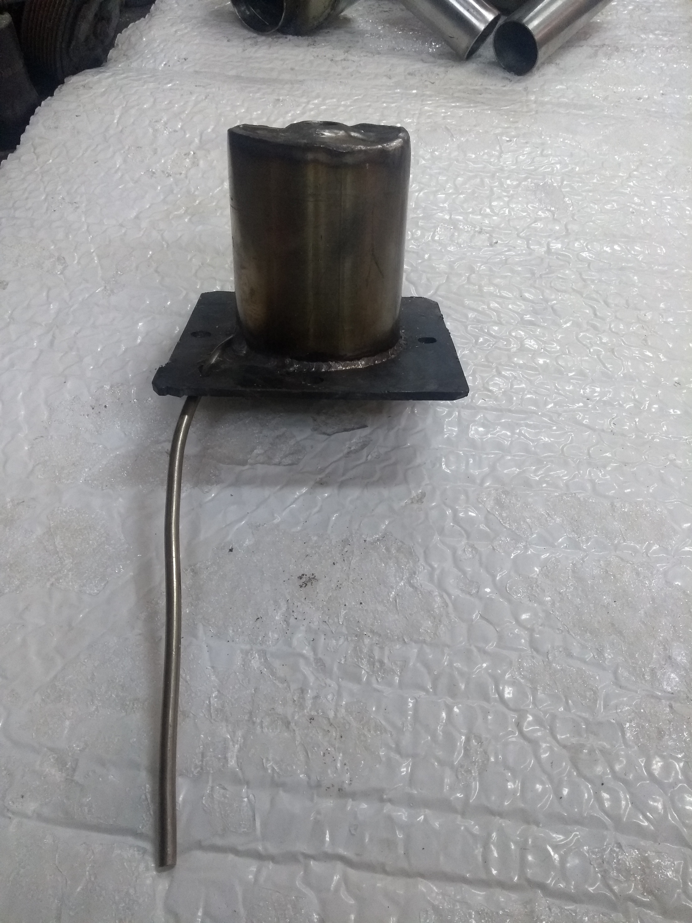

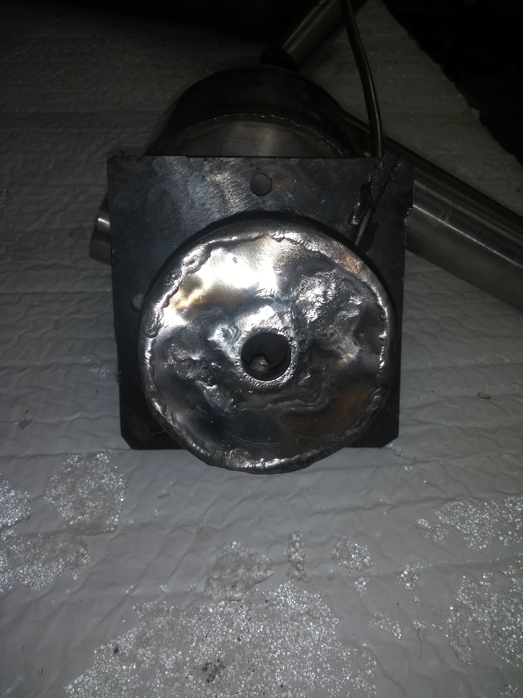

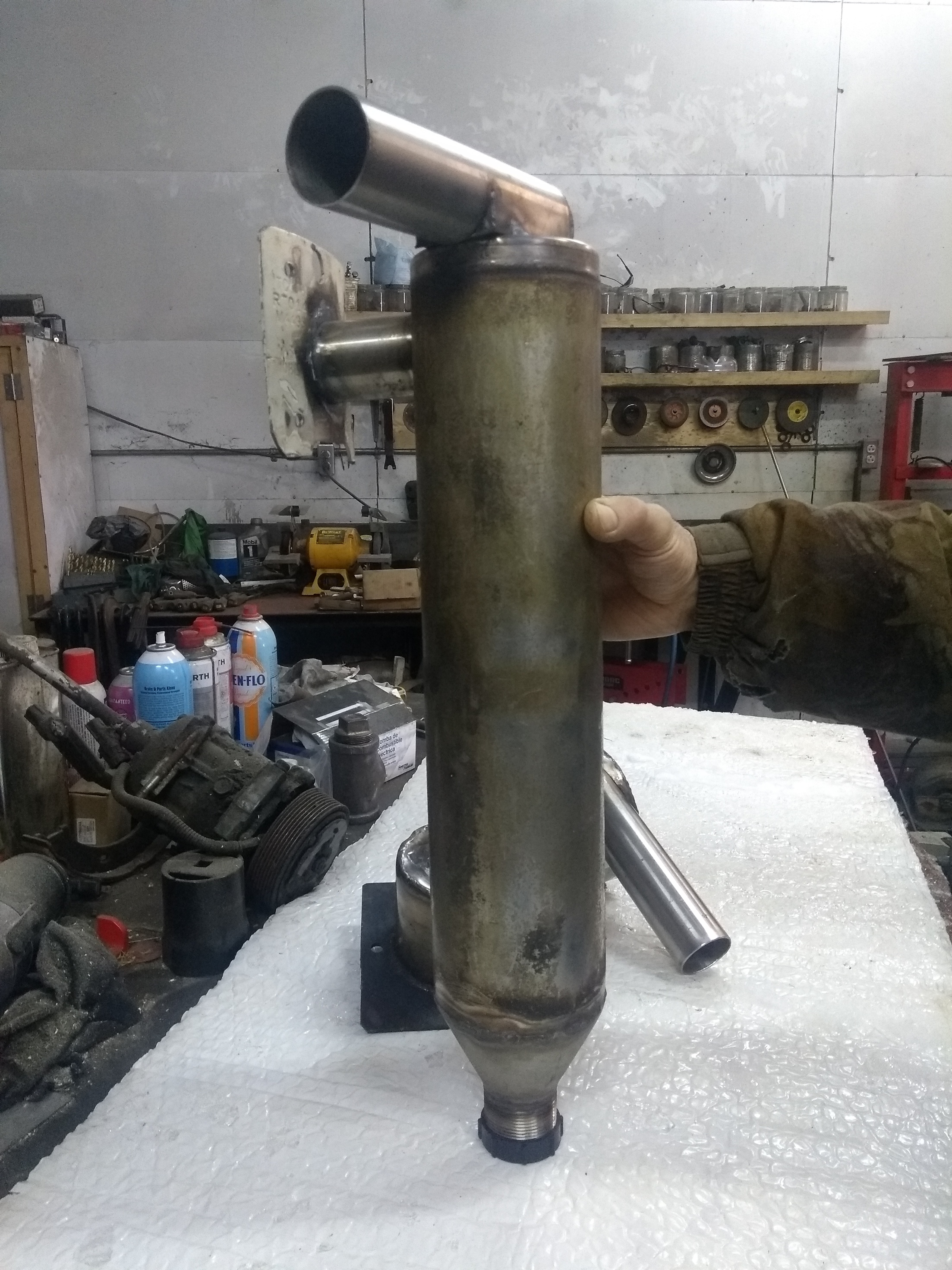

the diameter of the muffler outlet of my car is 40 mm and the diameter of the tube from the hopper is 10 mm. but you need to adjust, since the speed of the exhaust gases is different for different motors.

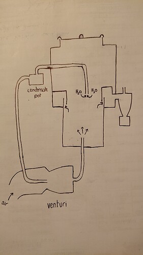

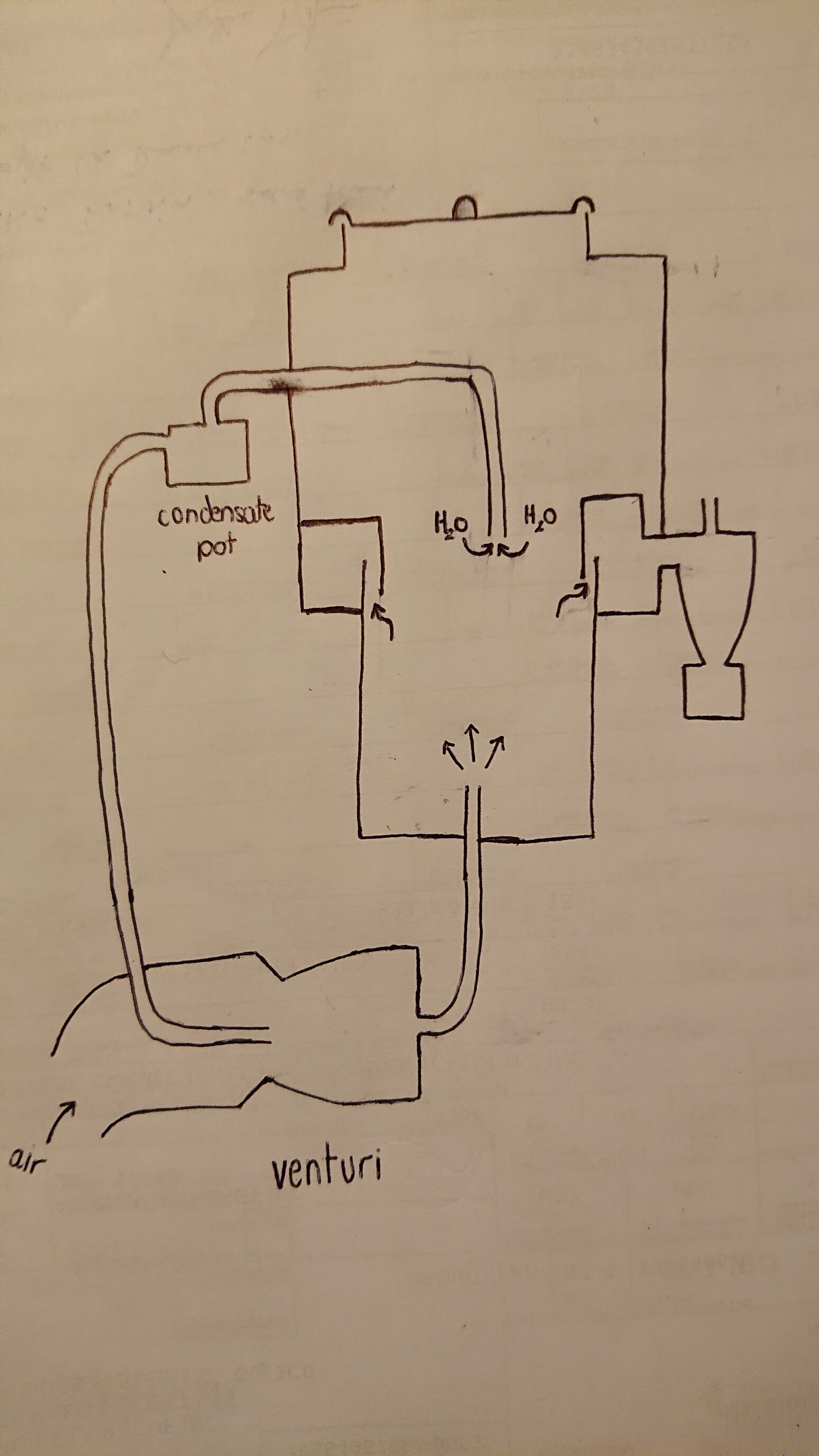

i have an updraft, charcoal, on a 1993 toyota pickup. my charcoal is damp because of my humid and cold climas. Could this design improve my gas?
Thierry in Qc
Trigaux,
to be honest, I have never dealt with coal gasifiers and I can only say one thing; there are many designs of coal-fired gas generators in which the forced supply of water to the core is provided (to increase the content of hydrogen in the gas), and on the contrary, you take water … I think that this will only lead to worse consequences (the calorific value of the gas will drop). Another important question regarding your drawing, namely, the air supply to the gas generator, will such a scheme be efficient? Air will simply be sucked in through both channels and cause upper combustion, because everything always follows the path of the lowest resistance, which means that it will be extremely difficult to implement your scheme in practice. If I were you, I would simply make coal in smaller batches, so that during storage it gains less moisture or use a monorator.

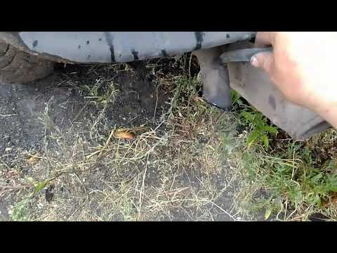

Hi Joni, in the video whos car is the red car? The gasifier is not hiden in the trunk of the car. I thought you had to hide them to drive in your country. Or is it just for the yearly inspection of the car by authorities, the car has to be in it normal running conditions for that make and model of that year.
Bobmac,
Тhere is no technical inspection in my country yet, but they promise to introduce it from 2022. Responsibility for the technical condition of the vehicle rests entirely with the driver. The entire gas generator is made in the form of a separate monoblock, which is installed on the towbar of the car. The weight of the entire system does not exceed 40 kg (permissible load on the towbar 50 kg). There are no alterations in the car itself, only a plastic line is laid under the bottom (it is absolutely invisible from the outside) under the hood, only a fan and an inlet to the mixer. Based on this, I am ready to argue with any traffic police inspector that I do not violate the laws. All they can show me is a loose cargo. For this, a fine of $ 2 (two liters of gasoline) is threatened. For six years of driving on wood, the police only look at me:astonished: with such eyes and ask me how it works, then let me go.
Bobmac,
I forgot to say, my car, this is a 1986 Opel Cadet (this is a copy of the American car Pontiac Lemans) 1.8l 115 hp engine
add a check valve on the water vapor line upstream of the venturi will prevent the air from circulating in the opposite direction?
the question I ask myself: is it possible to build a practically identical depression on the water vapor line and on the gas outlet of the generator? steam must come out of the hopper and enter the generator through the nozzle
