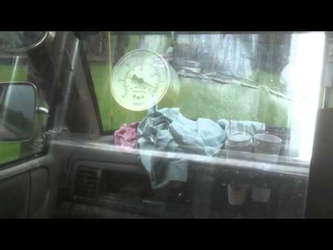

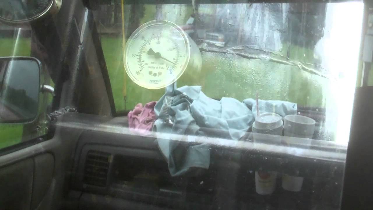

Hello Herb,
I had to run into town and pick son up from at football practice so while the truck was warmed up we gave it a quick test.
With no load on the motor and running 2000 rpm we were pulling less than 5 inches of water at the cooling rails as we open and closed the hopper lid.. I could only see about ½ inch movement on the vacuum gauge on the cooling rails and not enough to register on the fuel hopper gauge.
This shows very little restriction but still doesn’t prove the restriction is at the nozzles but somewhere between the nozzles and the beginning of the air intake .
You may want to do a similar test running your motor about 3000 rpm to compensate for the 8L vs the 4.9L.
Minutes before while on the road running highway speeds the reading at the rails were 15-25 and the hopper 4-6 inch range .
Also something showed up in the video I need to touch on. If the fuel /air ratio gauge goes crazy . All the lights in the gauge comes on or jumping back and forth something is wrong and probably making tar. If this happens I would make sure afterwards the vehicle is idling real smooth or maybe run a little gasoline before shutdown.
I think on the video when we first open the fuel hopper lid the gasifier pulled in all the gases ,steam , smoke ,water and any nasties that were above the nozzles but cleared up quickly .
Sorry about the reflection in the window.
