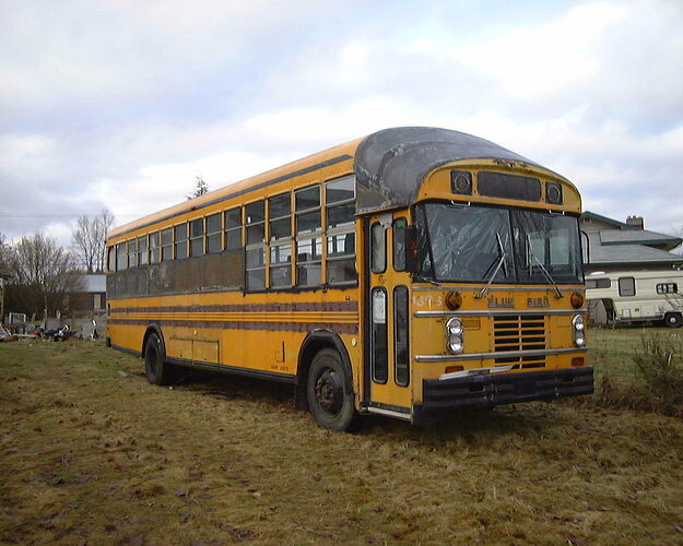

One the best wood drying and storage setups was an old school bus…
If ya got a back forty, it’s hard to beat.
The windows from north side can be removed and empty spaces closed in with sheet metal…
Then remove the metal between the uprights on the south side, to allow placement of the windows.
What ya get is a large solar dryer that is very sturdy, weather proof, cheap, great ventilation, portable if it still runs, not to mention ugly as sin. ![]()
I have done this, works very well.
Wish I had a place where I could do it again.

The pic below should get the point across.
windows could be double height for the full length of the bus.
Lets get together and gasifiy that bus, then we could load it up with wood and take off, by the time we need fuel the next hopper load would be dry.
Just being stupid.
That bus would make a fine dryer. Herb

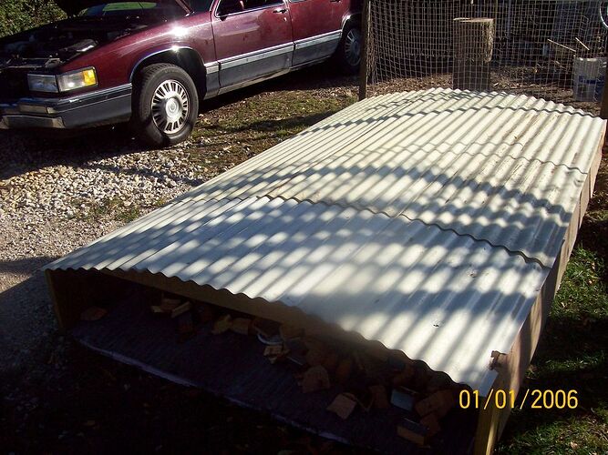

This is what I came up with, it’s not done but close. All used material except 1" insulation under the tin on ground, mostly from an old porch I helped a neighbor take off her house. What do you guys think? It’s going to get wet and cold here this week end sounds like. latter Herb
Looks good for rain. Open it up in sunny weather though. That tin is blocking some much wanted solar energy.
O I should have mentioned that is fiberglass, it does look like tin in the pic. It’s old and dirty on the bottom side but the price was right!

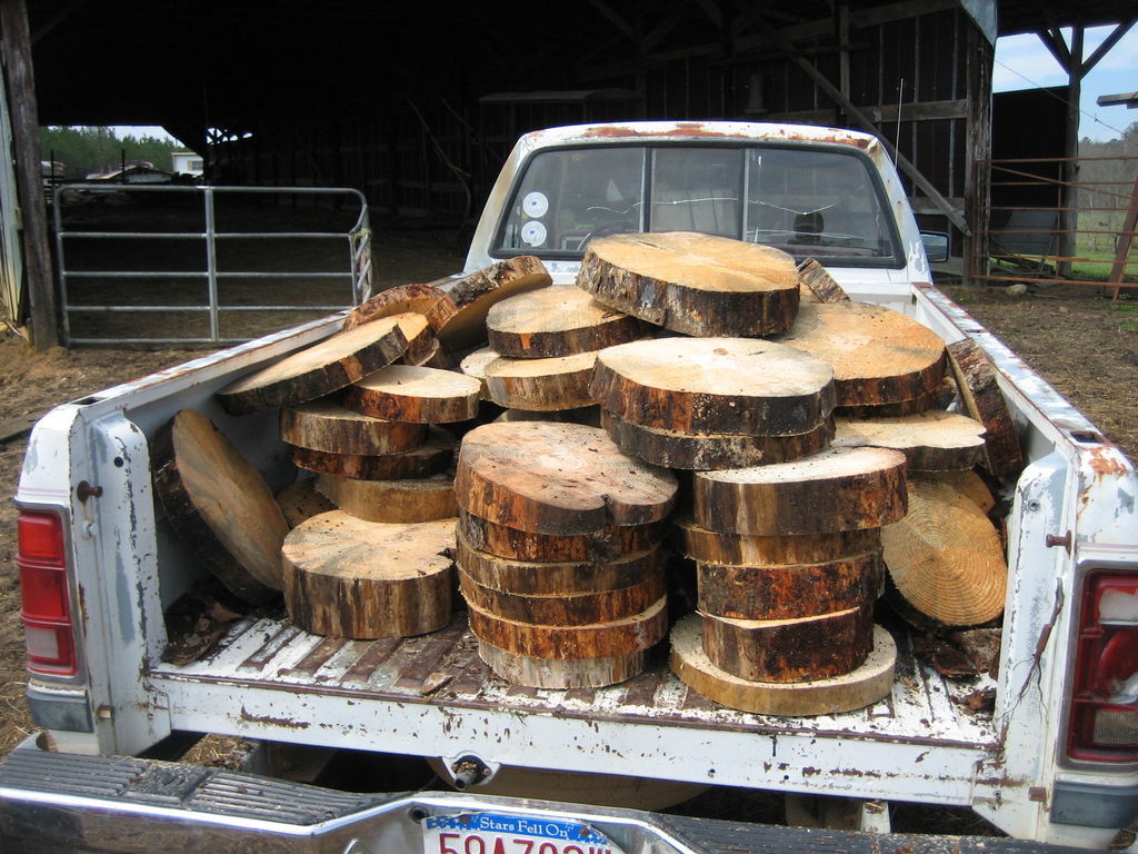

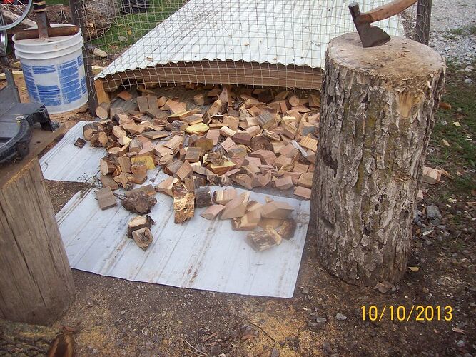

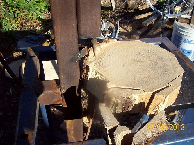

Thought I would put up some pics of how I process fuel. I cut logs off 2-3 ins. long and then split them so I end up with triangle blocks.
pic1. Bandsaw cutting off 3" long “cow patties” up to 20 in round
pic2. Hand operated spliter I made, works good, not as fast as hatchet
pic3. I think we all know about this system

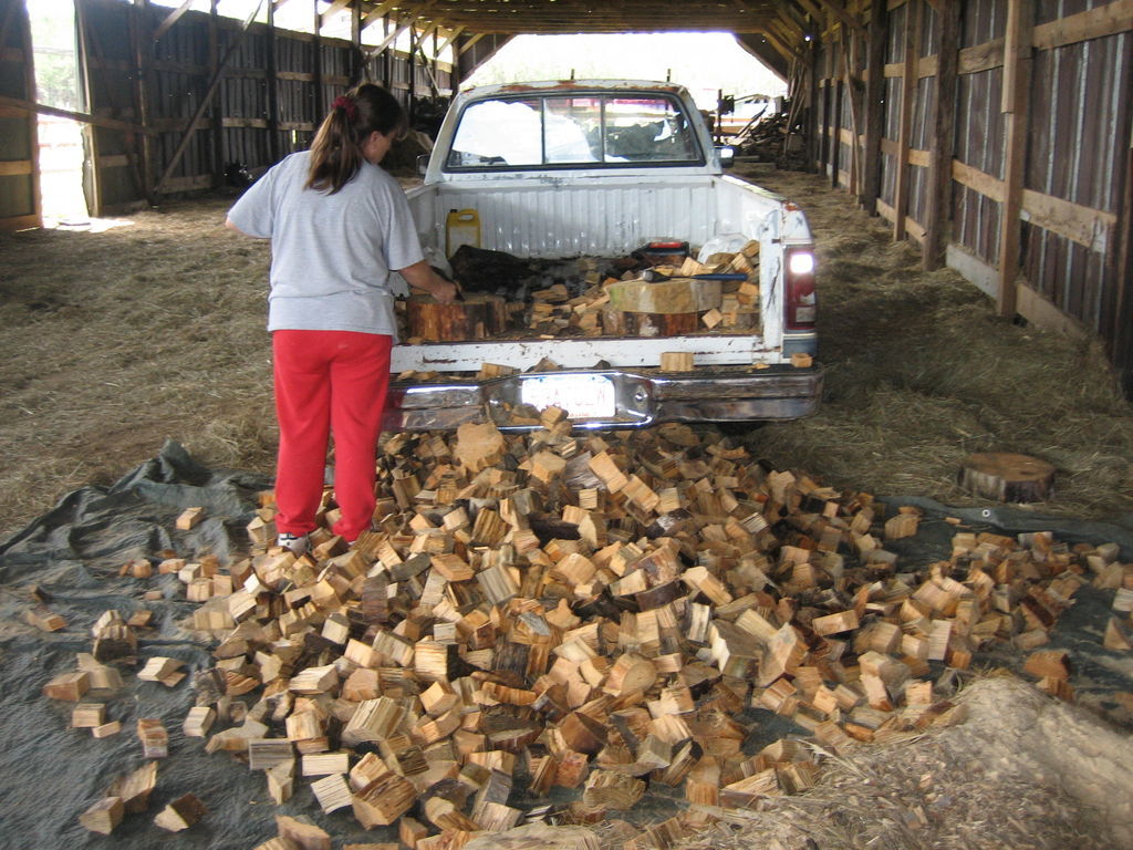

Good morning Wayne and everyone, yeah I like driving the Caddy so that means I’ld better come up with a good way of working fuel. My son-in-law is in the tree business so he drops off logs. You get a lot of mass out of a 20" cow patty and they split like butter because they are so short. Does anyone else work up fuel like this? Very low equipment costs, very low energy costs, the only other time I’ve seen it done this way was on the post Steve U (thanks Steve) put up a few back from here.
Took a couple of more pics. Herb

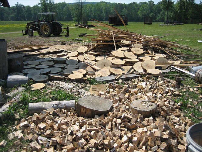

Wayne, I figured you had probably been there done that. How did you cross cut your cow patties? I presume you went with your chunker because you would have slabs from your saw mill left over, right? That is a serious chunker you have. What are you using for the cutter itself? Thanks Wayne, Herb

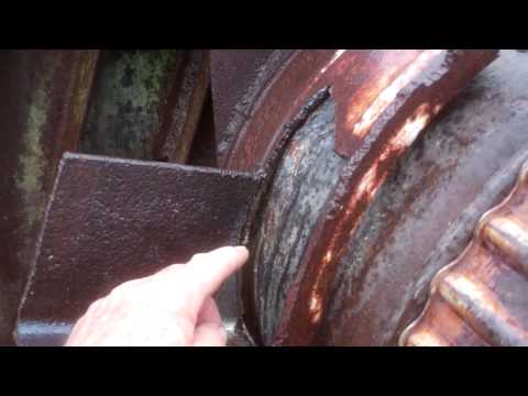

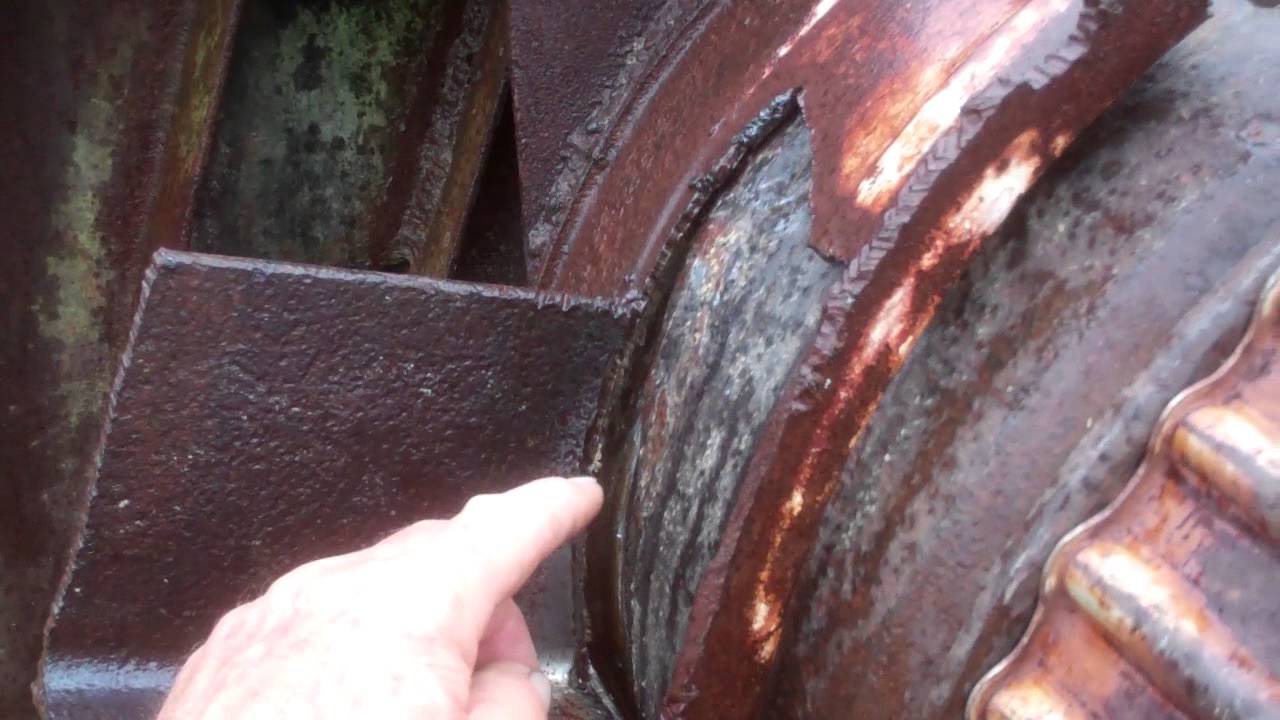

The cuter on the wood chunker is the truck rim. The video below shows it well.
On the cow patties ( disc ) we would cross them out with an ax ,hatchet or small spiting maul.
The sawmill strips and edgings are about the right size for the gasifiers and just needs to be cut into pieces . I used a table saw for a long time before I made the chunker.
