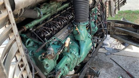

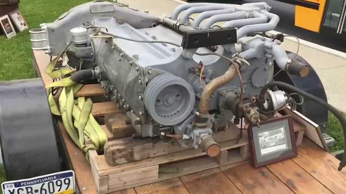

Photos are of a couple of engines used in busses.
One is from a Cancar ( a transit bus from the 1950s ) and the other is a from a GM transit bus ( also from the 1950s )
The Scott Hall ( bet you never heard that name before eh ?) is about 1000 cubic inches of gasoline fuled fury, very reliable with enough power to move that bus a long at a decent speed.
Same goes for the GM bus its a 2 stroke diesel however of 426 cubic inches. the screaming Jimmy as we call them up here.
One goes better than twice as far on a gallon of fuel than the other because of the efficiency difference.
See where I am heading with this?
We are still stuck on the bigger is better solution and ignoring how much biomass is lost to inefficiency.

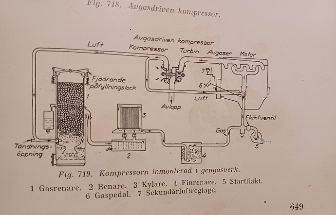

Anyway i thought i could contribute some about the turbo charging: this is a “schematic” from around -42-43, somewhat a cooperation Finland/Sweden about turbocharging woodgas trucks, wich should have worked quite well, reported about same performance as on gasoline.
As others write, i dont like the idea of a pressurized system either, because the risk of leaks.
Observe the much more “sturdier” spring loaded lid.
Yup thats everything less the fluidized bed.
