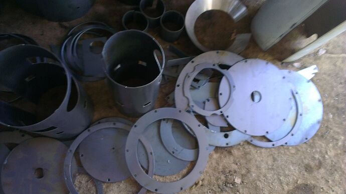

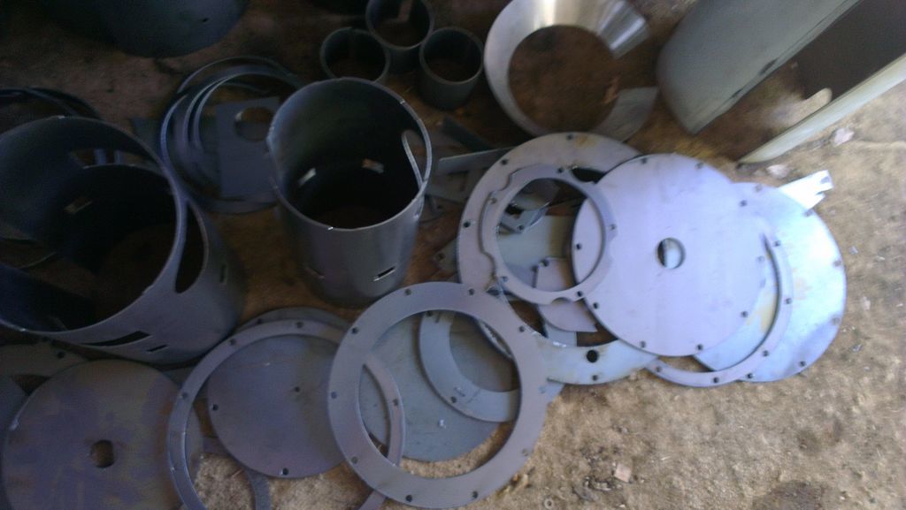

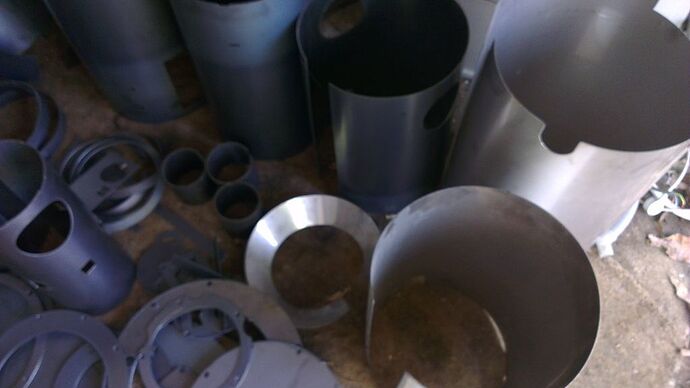

Finally got all the parts cut except a couple that they missed somehow but will get them done Monday.

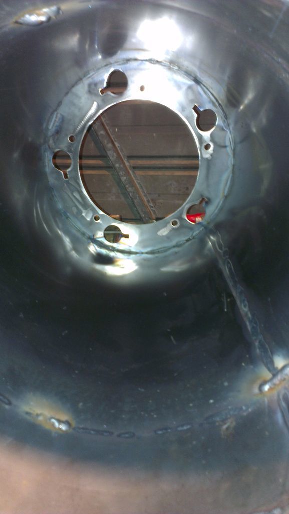

Doesn’t seem like so many bits till you see them all cut out. It does include a Monorator, dryer and exhaust heat exchanger, so lots more bits than just a bare gasifier. I have managed to make a start on welding it together. Certainly will give me lots welding practice, thankfully I have a good MIG welder.

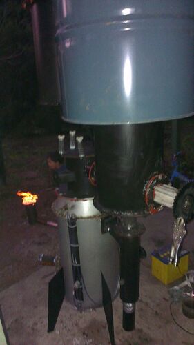

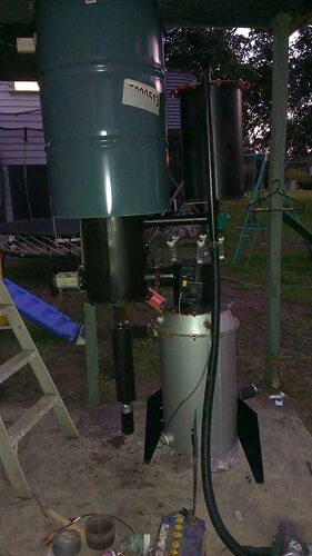

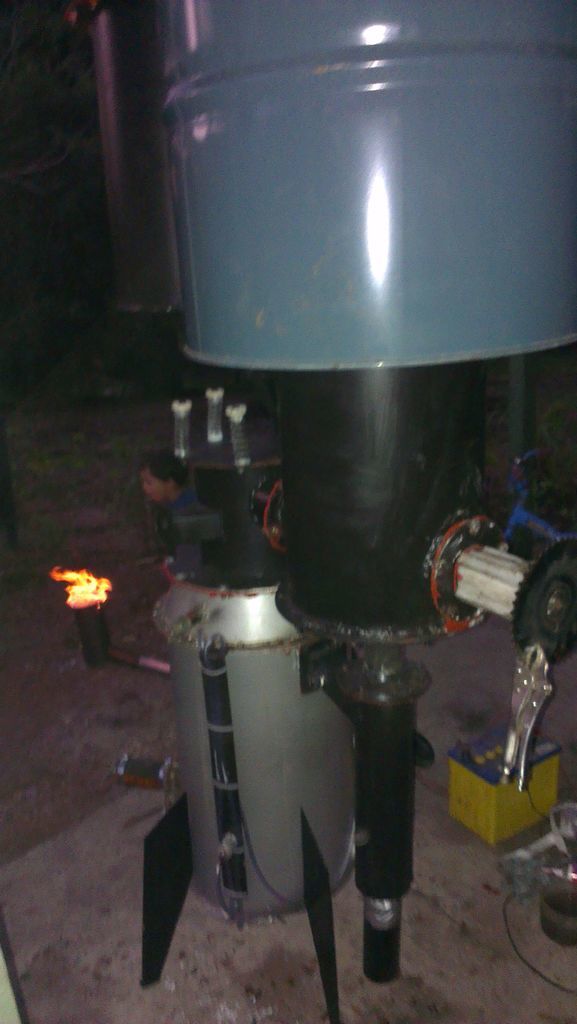

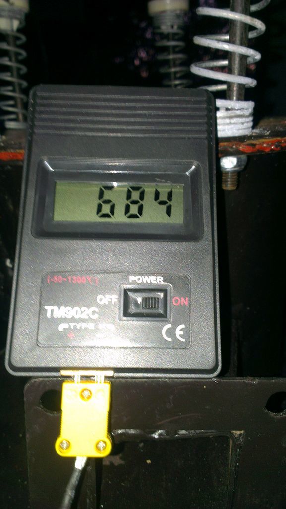

I have finally got to light my gasifier, still got more work to do on it but could not wait any longer to see it burn. The bilge blower I am using here to suck the gas is not real good I can only get 50 MM of H2O, so I am not getting more than 750 degrees ATM. I am building an ejector now that uses a vacuum cleaner blower to drive it. Also need to motorize the hopper auger, now I have got this far I will be more motivated to get it connected to the generator ASAP.
Even with only a small amount of suction it only took a couple minutes till the flare would burn continuously.
