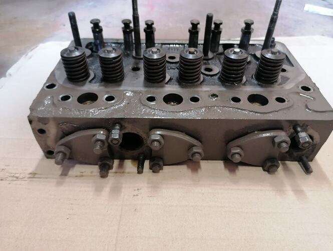

Older Ferguson tractors had a Perkins engine with fuel injection into the vortex atrium, which was manufactured by the Serbian company Rakovica for IMT tractors. They have an interesting antechamber construction, half is in the cylinder head casting and the other half is disassembled, two screws are easily unscrewed and removed. For the purpose of winter ignition, I have already installed glow plugs here, but I could easily install spark plugs for the use of wood gas.
I have a 1958 Massey Ferguson tractor. Four cylinder diesel. Been sitting, sinking into the dirt for about 15 years. The glow plugs are toast and I went to get replacements back then. Sixty five bucks a pop at that time. I bailed. How would you determine the right spark plug to use for that conversion? I think MSD has an ignition system that would time those plugs without having to have a cam gear or ECU. I’ll have to research that some.

Just set up for a long reach 14mm gasketed spark plug with a wide range of available heat numbers.
Dial it in by useage.
Race car guys and other engine builders are always changing plugs for different conditions, compression ratios, fuel types…
Cold plugs are ideal for high rpm engines, forced induction applications, and other instances where the engine produces high operating temperatures. Conversely, hot plugs are good for applications that operate mainly at low rpms. Because they have a longer insulator nose length, heat is transferred from the firing tip to the cooling system at slower pace. This keeps the spark plug temperature high, which allows the plug to self clean and prevent fouling.
