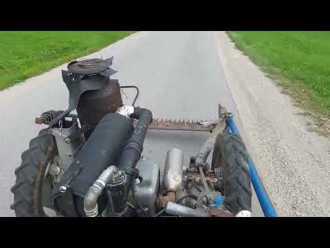

Its been far too long since l last actualy drove on wood. l decided to fix the BCS trolly.
These things are noutoriously fussy to drive. You steer with your legs and the mechanism is counterintuitive. It makes sence to push with the right leg in order to move the mower left but here its the opposite so it needs some brain rewireing. And it can go fast too! Not hard to land in a ditch or a bypasing car. But it sure beats walking 4km where l do work at a friends homestead…
This is how it looks like
