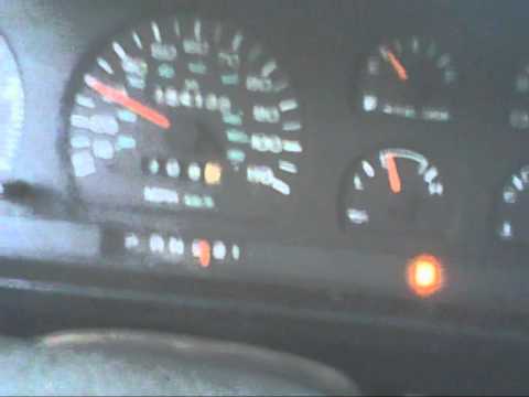

Watch my oil pressure gauge as I film the 1/4 mile run. As soon as I lift at the end it goes to zero. I figured the pick up tube was getting plugged up. It has done this every since I bought the truck. I spent the last couple nights pulling the pan and replaced the oil pump only to find the pick up screen was clean and I believe someone has changed the oil pump prior to me buying the truck. Someone had cut a piece of the pan baffle inside to make it easier to get the pan off with it still in the truck. And it had a mellings oil pump already in it. I doubt that is a factory pump, I know G.M. has a G.M. pump from the factory. Anyway It seems I just wasted 2 nights because it still does the same thing. Now I’m going to do what I should have done in the first place and hook a gauge up to it so I can see what is really going on. As soon as the motor gets warmed up the oil pressure starts dropping off and will not even register sometimes at an idle. Would of thought motor would be knocking if it was indeed not getting any oil. Google the problem and it seems there are quite a few issues with oil pressure and the dodge engines. I’m afraid it can be to much clearance in bearings and not keeping up when oil is hot. Wish I would have bought the high volume pump now. But that is why I should have used a pressure gauge first so I would have known more about how to fix the problem once the pan was off. Will test today and let you know…probably a 20 dollar sending unit…lol I guess even that would make me happy now.

Ok guys did what I should have done to begin with. Removed sending unit and hooked up a mechanical gauge, taped it to my windshield wiper so I could see it and went for a drive. After warmed up it never went below 12 to 15 pounds at an idle. Instantly would go to about 50 when revving the motor. I installed a new sending unit and the dash gauge works like it is supposed to. I was very happy but wish I would have done that first. Joseph is right about pulling the pan with engine in truck. It is so close to impossible I think I would have to tell someone if they asked that it can’t be done. Had 2 blower motors that where no longer working so got them changed today also. I have some video and pics to share but left them in the Dakota at my sons shop where the lift is at. And to Wayne…thanks for letting me know I’m not the only one to change the oil pump befor changing the sending unit…LOL. Also been chunking wood for the trip to Argo’s I used around 1300 pounds getting there one way last year (rough estimate) that included a couple trips to our ,motel which was somewhere around a 30 mile trip 1 way . Ron Lemler if you read this I will be returning the nice wood box you sent home with us last year full of wood. I know there is a lot of value in that box and appreciate you loaning it to us for a year. Hope to get another for the trip home this time also. Hope to see you all again this year.
