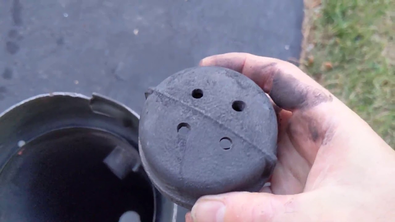

Found the picture of the port. I was wondering how I was going to clean that thing out.
Was the inside of your tank steel or did it have a ceramic lining?

#### Post date: [October 9, 2022, 11:27pm UTC](http://forum.driveonwood.com/t/newbie-needs-advice/6964/17 "2022-10-09T23:27:13Z")
</div>
Mine was a propane tank just steel lined is all
