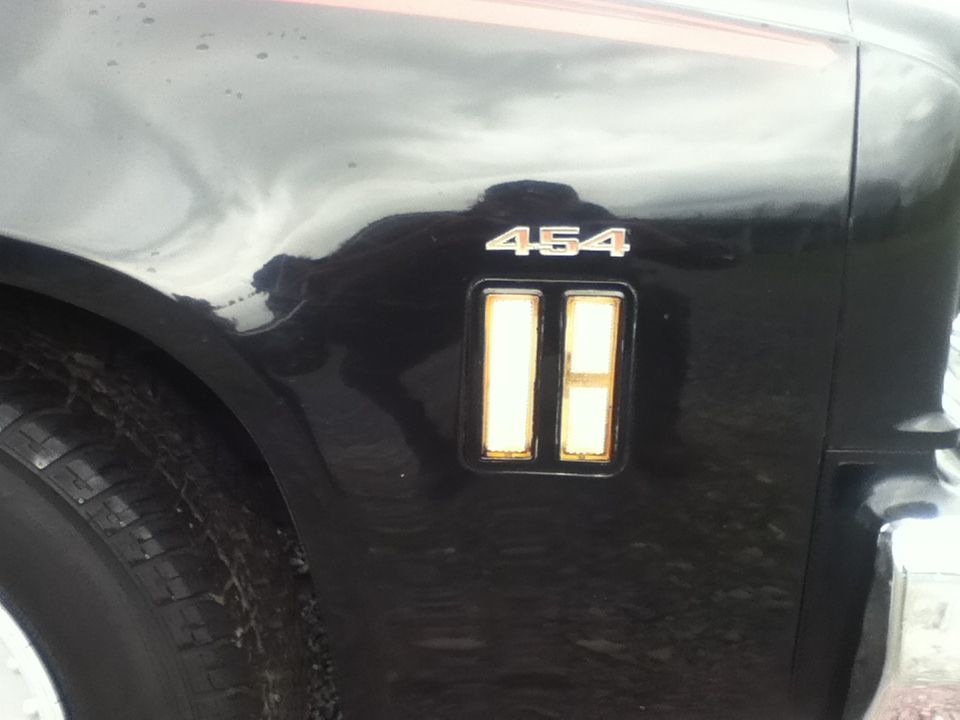

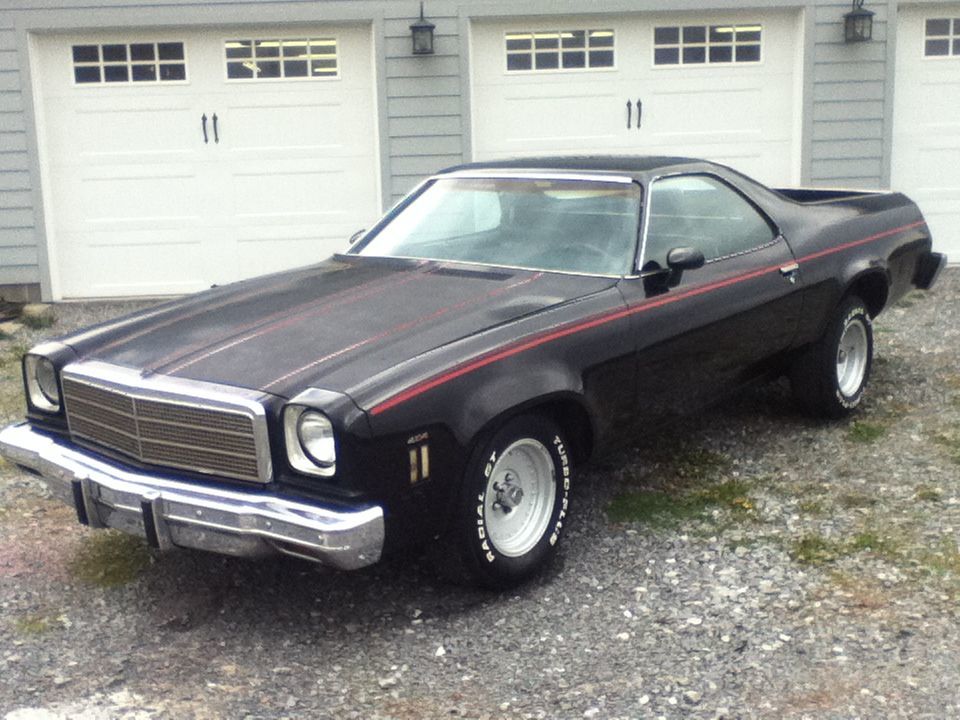

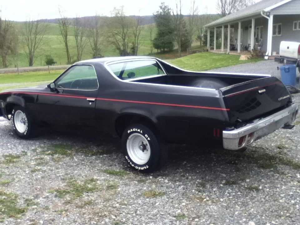

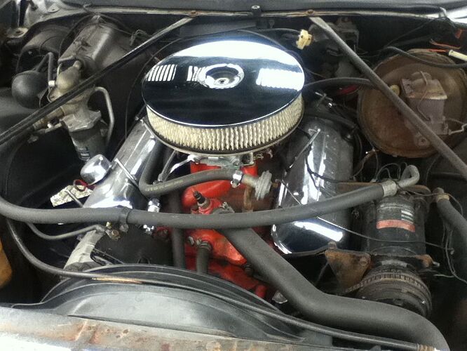

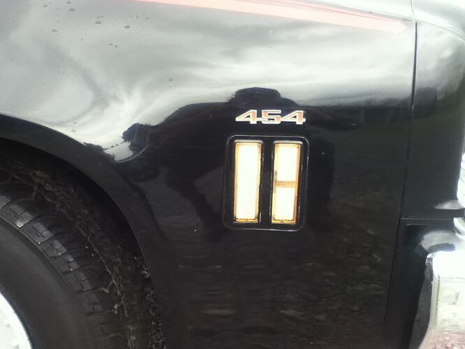

heres some pics of the elky .. still waiting on it .. ill see it in a couple weeks most likely … can’t wait to see it! I’m actually thinking on using two fire tubes it it to get away from the high tar content of one big tube and I’m thinking it will supply enough gas at 3000 rpms .. I’m not sure about this one but I’m building it in my head… has anyone made one that can use cordwood size firewood? whay wouldn’t that work? just curious.
