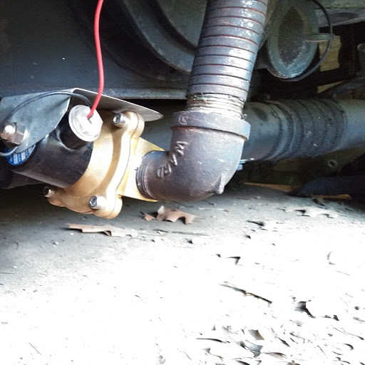

I added a 12 volt hot water zone control valve to my EGR circuit so that I can turn off the EGR from the driver’s seat when I am running maximum water mist at WOT. I can’t wrap my mind around how much the optimum amount of reaction water will cool the reaction without flooding my coolers and filter. If I find that I still want some EGR with maximum water, I may need a by pass or some other way to adjust EGR while driving.
