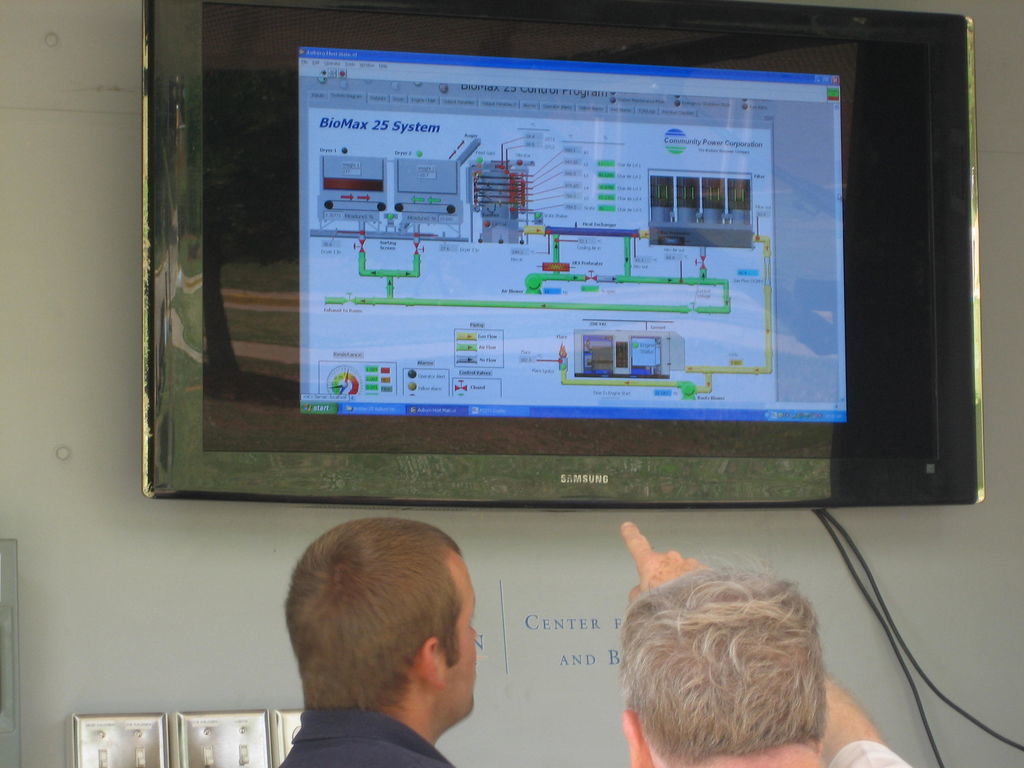

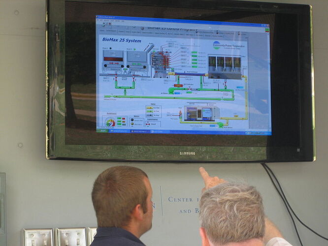

The BioMax 25 is a 25kw generator running on woodgas, driven by a 4.2 liter Chevy Vortex engine. Normally, a gasoline driven 25kw generator by the same manufacturer would have a 2.4 liter engine driving it.
I’ve spent quite a bit of time crawling around the BioMax 25 at the US Forestry Service biomass gasification research station in Louisiana and have talked with the guys who run an almost identical BioMax 25 at Auburn. The USFS unit has a roots blower to generate vacuum for starting the gasifier. The Auburn unit has the roots blower feeding the engine. It seems to me, the blower could help recover some of the lost hp when running on woodgas.
The BioMax I checked out uses Woodward automatic governors. It has a valve controlling the wood gas, another valve controlling the combustion air (from a standard K&N air filter) and a third valve controlling the engine speed. The lines feeding the woodgas and the combustion air look to be about 1 1/2" to 2" in diameter. As I said each of those has an automatic control valve for adjusting mixture. They come into a T and then go through the third valve right above the intake manifold.

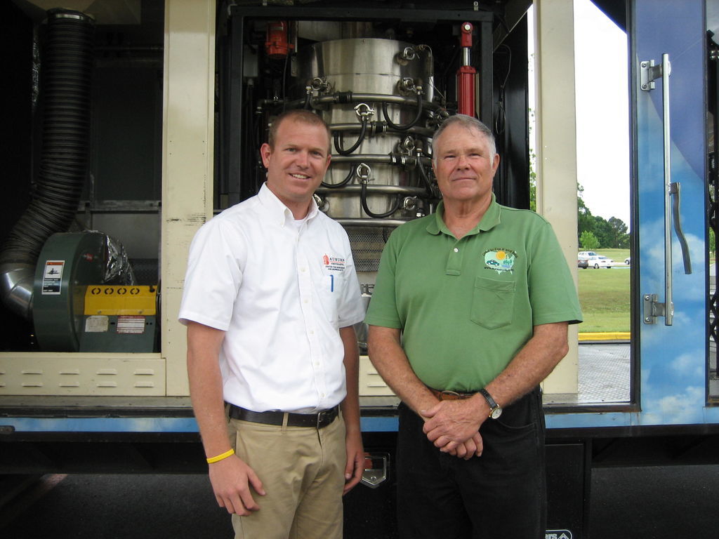

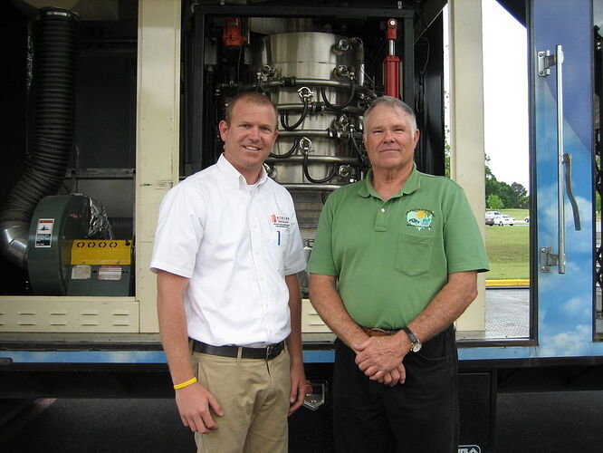

Chris Brodbeck (one of the operators of the Auburn biomax) and I have spoke at several events together. Pics below
The biomax machine is big, computerized and shiny, but on my trucks ( V-10 8 L ) I am putting out near twice the power and the gasifier takes up the front two foot of the truck bed.
Chris tells me with today’s energy prices and the near ½ million dollar price tag the machine will never pay for itself.
