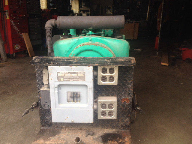

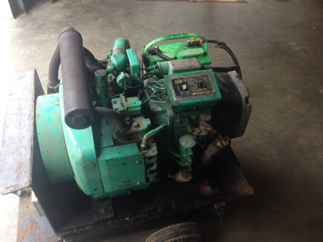

In the old timey times something like the Onan CCK came in several flavours.
It was rated at different speeds and in some cases the exact same engine might be bolted to a 3 4 or 5 kva generator ( 6 if you include the water cooled marine version ).
Much of this is not about what the engine can put out, but rather how well it might cool and how long you want to run it at that RMP and load.
