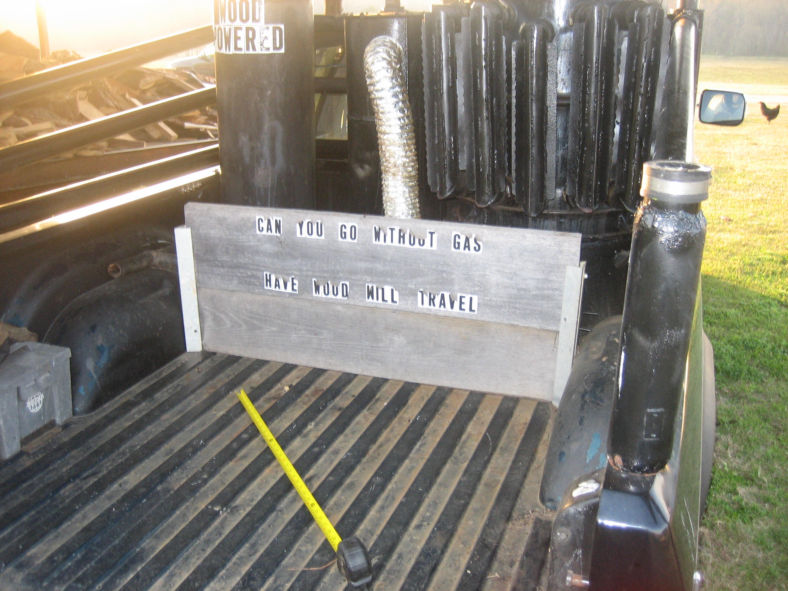

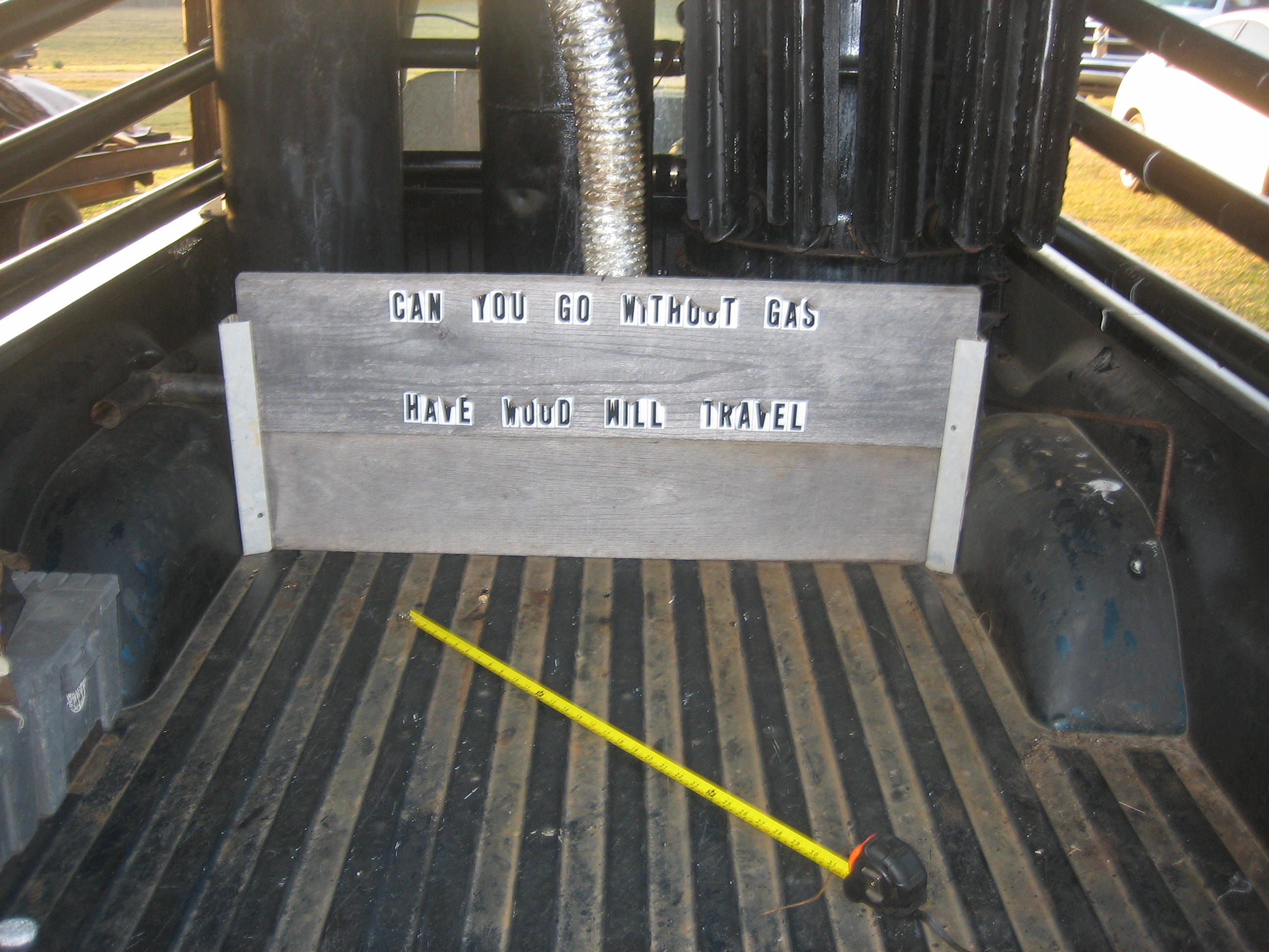

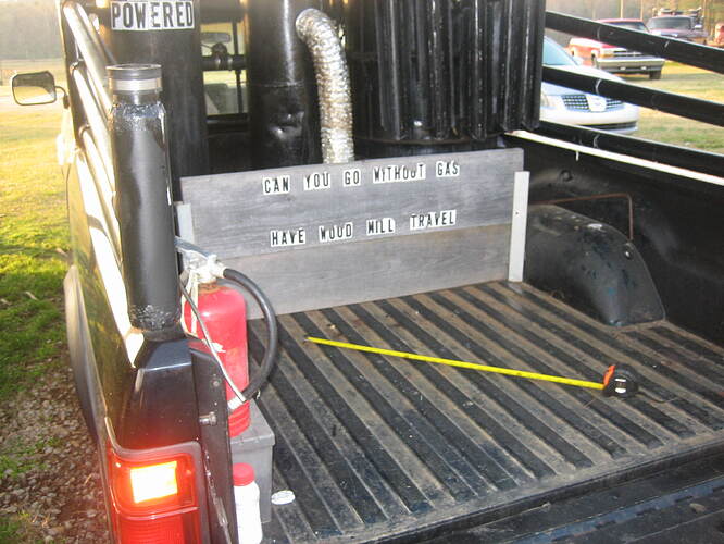

Nice that seams reasonable. How many feet of the bed does the gasification system take up? Also it appears the link for sizing the burn tube is down in the video tutorial. @Chris any way of getting that link back up and running? Are the measurements in the video tutorial specific to the Dakotas?

The gasifier and other components occupies the front 32 inches of the dakota truck bed. ( just went out and measured to make sure )
On the dakota we start with a 12 diameter and about 18 inches long fire tube . The gasifier will need to be tuned to your wood , driving habits ,weather ect. This is done by changing out the choke ( restriction plates ) .
