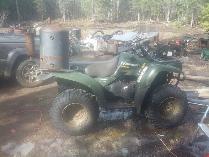

Funny enough I just started working on one. Charcoal for me of course. At this stage I’ve run it off the tractor’s unit and have started mocking it up. I’m using a 10 gallon hot water heater tank as the unit. Lots of pipe fittings already welded on. The rest I have on hand…

No idea of HP its a 360cc though

That’s the problem I’m running into at the moment, I don’t have a lot of uses for the bulk heat that comes off the charcoal pit/barrel. It’s had to match it up to anything beyond heating a big space or some water, and in my climate, we don’t need anything hotter! ![]()
