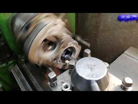

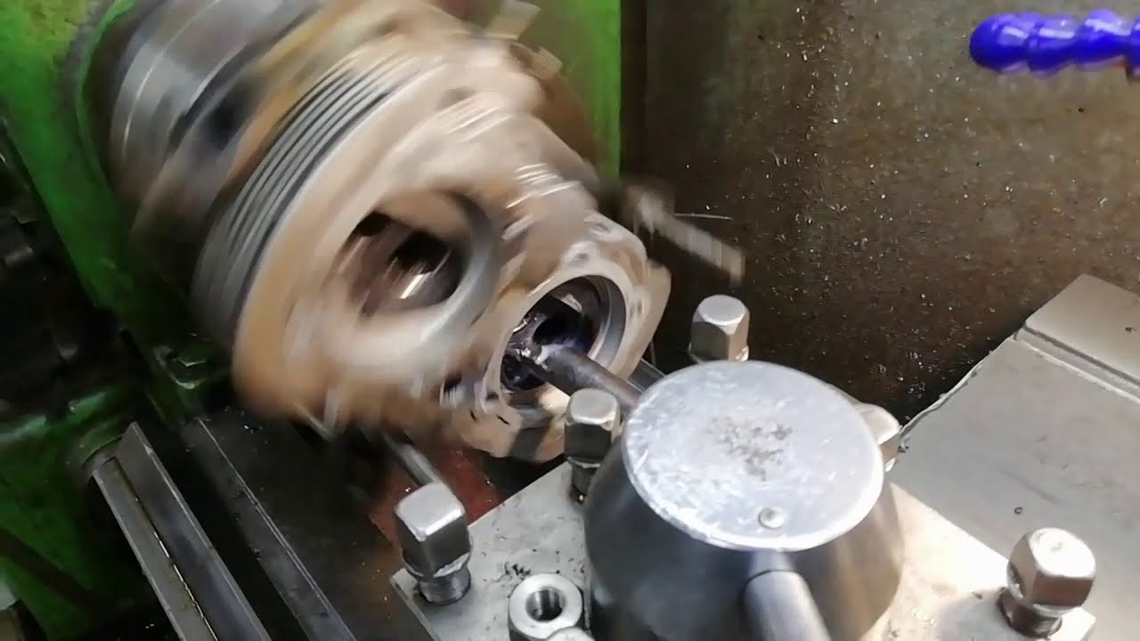

what i did today..
i have 30mm thick a steel pancake roughly cut with plasma cutter
some surfaces rounded and flattened, some guidelines cut
drilling and tapping four holes
for 4 M8 bolts
head in chuck
centering
one cylinder done
both cylinders done
everything went surprisingly well, a lucky day. ))

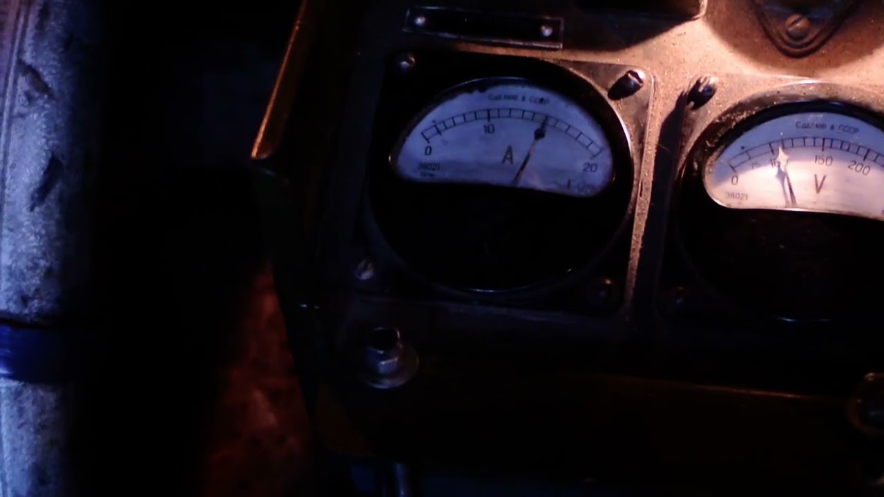

at first run i was baffled because power was way lower than expected.
i think i found the problem.
seems that it is some blockage either in muffler or exhaust gas cooler.
on video muffler disconnected and power output is close to 3kw instead of 2kw like it was before milling.
Andris, if you get 3 kW at 1500 rpm with a 420 cc engine, this is the ideal power that such a large wood gas engine can handle. If you have the option, it is a good idea to make the exhaust pipe from two separate pipes for each cylinder, which are joined in the shape of the letter Y, and then install the muffler.

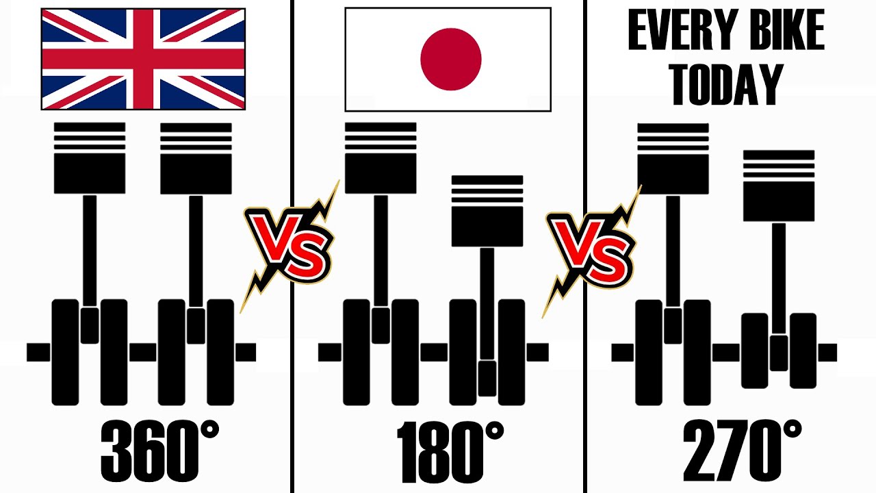

Hey AnthonyB. if you go back up to AndrisL.'s first starting post in his pictures set it shows the spark plug angled in from the side.
Machining down the cylinder protrusion step in the cylinder head puts him right down onto the spark plug intrusion.
And his picture set showing both piston up TDC at the same time tells me the crankshaft type on his vertical twin cylinder engine. Its balance and its degrees firing sequence possibilities.
yes it is just like Steve explained.
