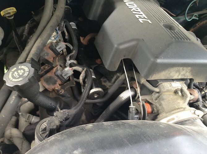

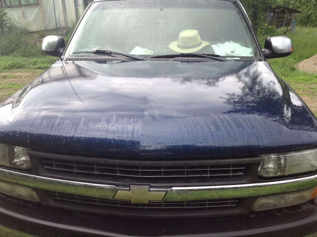

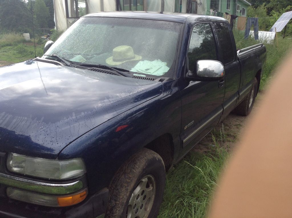

I have a 5.3 to do Chevy Silverado extended cab with any foot box has potential build. After reading some research on Wayne Keith’s projects is the cleaning of the intake . The 5.3 L Chevy comes with a plastic intake
i’ve been researching whether I can find a metal intake to replace the plastic No such luck with their buying something that’s worth more than the truck any ideas some help would be appreciated
Do it anyhow GordieB plastic manifold and all. MikeLaRosa with his GM now does. WesK with his Dodge 4.7 plastic now too.
Get a speed wrence, a couple of wobbly sockets and these no-coolants dry manifolds are easy on and off for any needed miles used accumulated needed cleanings.
Ha! Ha! EVERY spark plug change on a PT Cruiser requires plastic intake manifold removing, with YES an EGR exhaust tube like I see on yours too. Fellow learns to get fast. Real fast.
Something done and learned from trumps all of the imagining about it.

I concur with Steve, do it anyway.  20 minutes and I can have my manifold off. Only periodic checking will determine the frequency  of having to remove and clean, if at all.
Pick up a couple of spare intakes from the salvage yard so you’ll always have a clean one on hand. Treat it like routine maintenance - change the oil - change the intake.

The vehicle you have as a known conditions will be 2X better than anything you have to go out search and find.
From a few years of professional auto tech’ing on both of these families of engines I’m certain a 5.3 GM LS will hold it’s own against a Dodge Magnum 5.2 in a extended cab comparable wheelbase. Oranges to oranges comparing. Not reasonable to compare to a short wheel base Dakota.
The GM control system like Toyota’s is much more ignitions timing aggressive  seeking than Chrysler/Dodge.
GM much more EGR fine controlling and tuning allowing a higher base compression ratio and combustion chamber shaping than Chrysler/Dodge. Until you do go later Dodge/Jeep 4.7 like Wes’s your GM has a much more advanced active individual cylinder ignition timing shaping unlike the for-all distributor Dodge 5.2 Magnums.
These combined with woodgases much higher resistance to detonation/pinging I think will give you the woodgas better engine power to offset your heavy chassis. Wood consumtion?? Donno.
I’d like to say that I’d bet money on my statements. Or dramatically say you can take this to the bank; but Ha! This will not be my money or effort to prove woodgasing these GM LS’s.
I am now over $11K into stationary power small engine woodgas proving outs my mouthing’s.
IF you were GM dedicated the go-find to better insure your power would be a 6.0L GM LS engine in a short wheelbase body.
GM, being GM I am not certain just what year range their “Biggest Auto Manufacturer in the World” advanced electronics will woodgas scream and put a GM system into fits with cylinder deactivation and limited allowed trans gears.
Your chassis appears to be an early system type. Safest to try on versus later.
Ahhh. Speed wrenching plastic intakes is BEST done with one of the old-fashion looking two hands manual crank arm “speed” wenches.
First install go ahead and torque wench tighten back up. Check then with the manual speed wench wristed over. From then on you’ll have it down pat. Do follow the pattern torquing pattern though.
I am excellent with my 1/4" and two different 3/8" air speed ratchets. Still not good enough with variable general shop air; air ratchets lubrication to risk it not on forgiving metals.
Even removal of plastics to plastics manually you can feel a previous over tightened (or worse id-git lock-tited) fastener BEFORE the plastics cast in brass thread sleeve/nut breaks loose and spins on you. Gives you a chance to cuss do-something preventable before the real sweating cussing repairing.

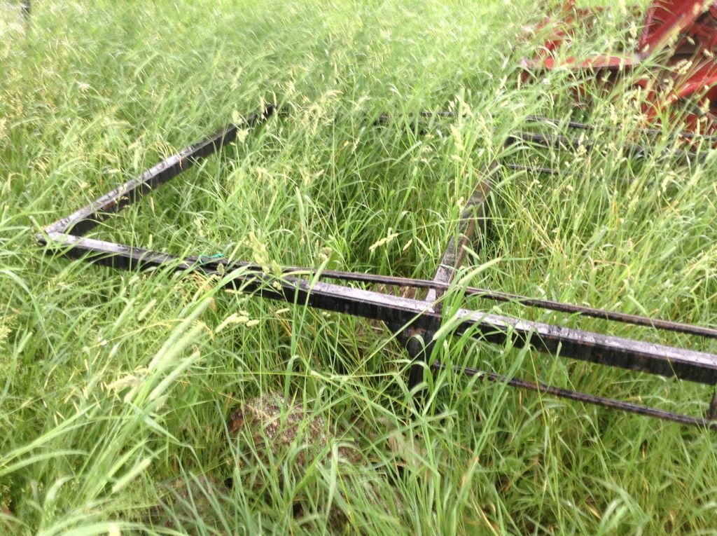

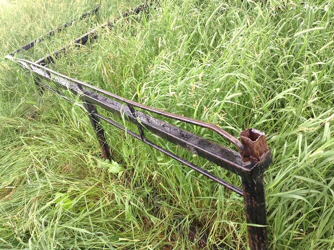

Take a look at what I found in the back 40. It’s a ladder rack off mail pickup truck was thinking of using for my cooling rail
