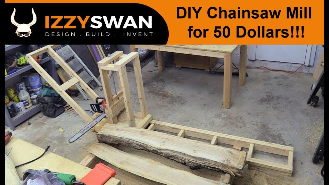

I am considering doing this and using my electric chain saw with a slow feed so I can set it and walk away.
Personally I wouldn’t waste my time. I used an Alaskan saw mill a chain saw just isn’t worth the headache as a saw mill too slow too much dust and I definitely wouldn’t trust one in any walk away setup but that is just me.
If you do use a chainsaw make sure it is a big one as it takes a ton of power and also make sure you have the chain cut at 15 degrees not the normal 35. I made that mistake when I started with an Alaskan saw mill. Honestly you would be better off to pay someone with a portable bandsaw mill. I say this as someone who decided to buy a bandsaw mill myself and have done both.
One thing to remember the lumber is only as square as the mill you cut it on.

It will work, but be painfully slow, especially with the power limitations of an electric chainsaw. And the electric is apt to burn out rather quickly, universal motors won’t hack that use for long unless really babied. Plus the kerf waste will be huge. Look at @BillSchiller 's observations.
My advice would be to jump into making a small bandsaw head, one that uses a fairly sturdy blade, and either power that with an electric motor or gas engine. Bandsaws are very simple in principle, just 2 wheels in the same plane on a fairly rigid frame with a tilt mechanism on the idler wheel for tracking on crowned wheels. Add blade guides. First invented by Chippendale, I believe, pre revolution. (He deserves a statue for that… ) ![]()
Or buy a cheap Harbor Freight, modify and rebuild accordingly. Probably worth it just forthe wheels, tracking and blade guides.

Excellent points Dan,
I have a friend that has a bandsaw mill and it does the trick, but he is about 50 miles away so that = lots of hauling. I think this would work great combined with my CNC for signs, or other rustic designs. It also depends on how much time / money you are investing in the project.

Before you invest the time to make a sawmill like that, I suggest that you simply rip one 8 foot board from a 12" diameter log, free hand. Even pine. But if you are going to be milling hardwood, try it on an oak or hickory, too.

Great suggestion you can also nail a 2x4 on the side of the log and use it as a rough guide. I have done this more then once with a chain saw when I didn’t have a mill.
I agree with what everyone said. With that said, sometimes you just need to try your way to appreciate what everyone’s opinion actually means.

I think I would get tired of waiting for the thing to cut. But I think it’s a neat idea…maybe in a development situation where nothing else was available… But I also agree with Bill. Every context is different, it might work for you depending on what you want to do.
If I was going to try it, I would want to cover the contact points of the boards-to-rollers with metal so the wood wouldn’t get worn out… Also, maybe where the logs are going to be rolled.
Also, in my experience with Alaskan mills and ripping lumber freehand in the Amazon, cutting at 90 degrees is much slower, albeit cleaner cut, than cutting on less/more of an angle.

Our shop teacher said, well you can do that, but the kerf is bigger, the boards aren’t as accurate, and you spend more time on the planer and sander and end up wasting wood. Planer blades aren’t free either. It is a pain working with boards that aren’t square in a number of applications, but not all.
The idea of using of an electric chainsaw is neat, it -might- work, but I am not sure they can go fast enough and too much heat will build up. You do need a different chain.
