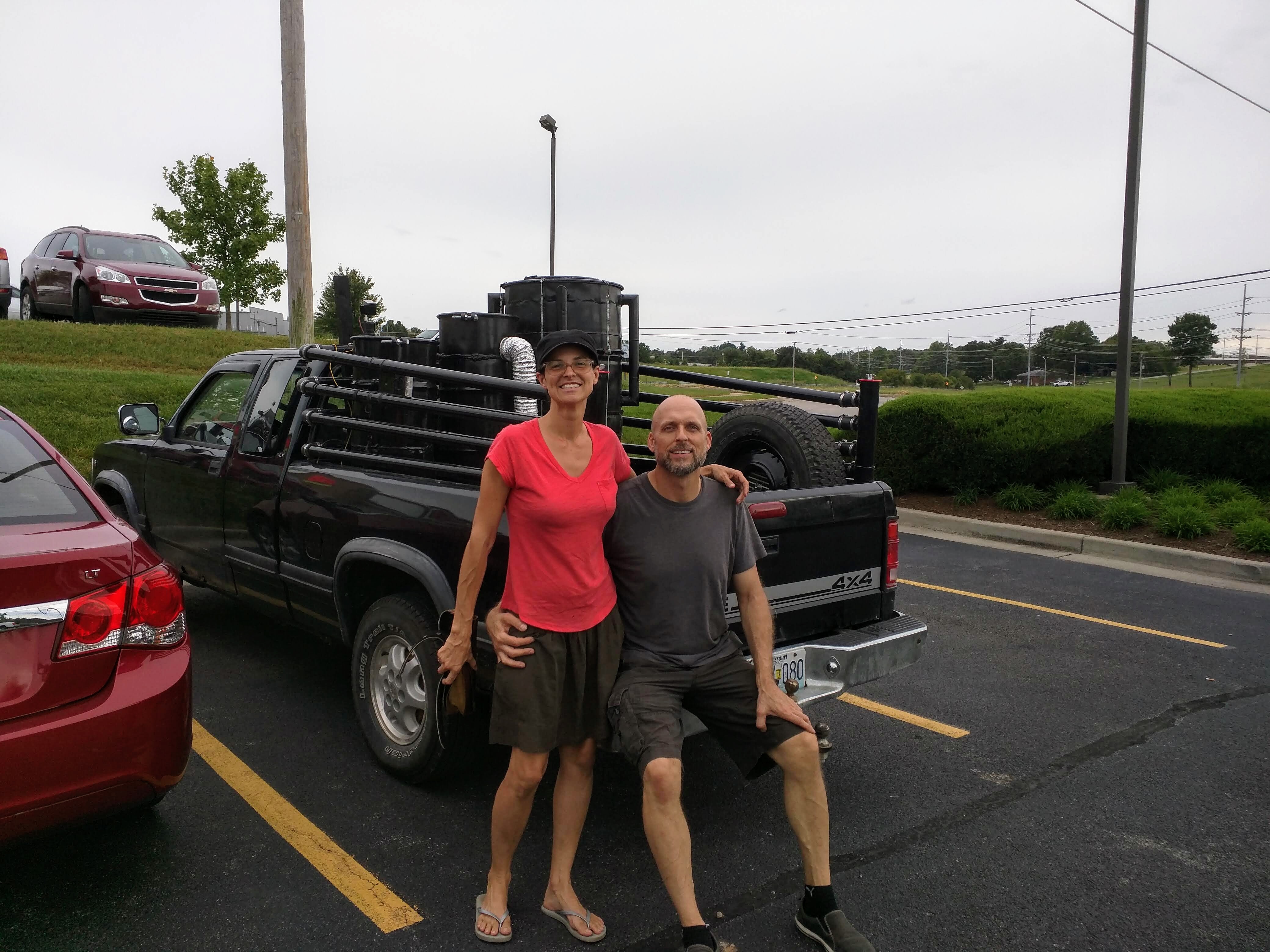

Aaron and Rae came to visit on Sunday! They are on a roadtrip doing a documentary on intentional communities, and they drove their woodgas truck (although on gasoline).
Apparently they got the truck all built and ready to fire up, but got stuck on the operation of it, and because the gauges they had bought read in inches of mercury instead of water, they thought there must be a huge vacuum leak somewhere.
We spent about an hour looking over the truck, fixed a loose connection, and fired it up on woodgas. Truck ran and drove just fine! It needs an idle string and some new vacuum gauges.
Best of luck on the rest of your trip guys!

Good too see another wood gas beginner, the learning begins, enjoy your jurnny they are hard too come by these days, be sure and keep the insulation in the ammo can before shutting the ash door, it will work ok with out untill you run intoo an extended bridge condition, then your ammo can seal will be burned out and truck be stalling. Keep yes keep us posted when time exist.
We are grateful to Chris for the last part of our build…knowing how to operate the beast! Thank you sir!
It was very generous of you to accommodate our last minute visit to your home.
We basically sprinted on the build for about 2 months solid last fall and then work and travel issues kept us too busy to spend the time finishing it.
We do plan on keeping insulation in the ammo can clean out. I have seen images of too many crushed ones…
And yes i forgot the 2×4 or spacor too keep the can from colapsing, it distorted mine when it went.Enjoy the learning and teaching experiace, Good thing too see how well it works. And knowing how too make it happed properly and safe as it is.My next ammo can lid may get the spacor attatched so i dont have too spend as much time fidleing under the ash pan area or looking for the spacor i lost.
