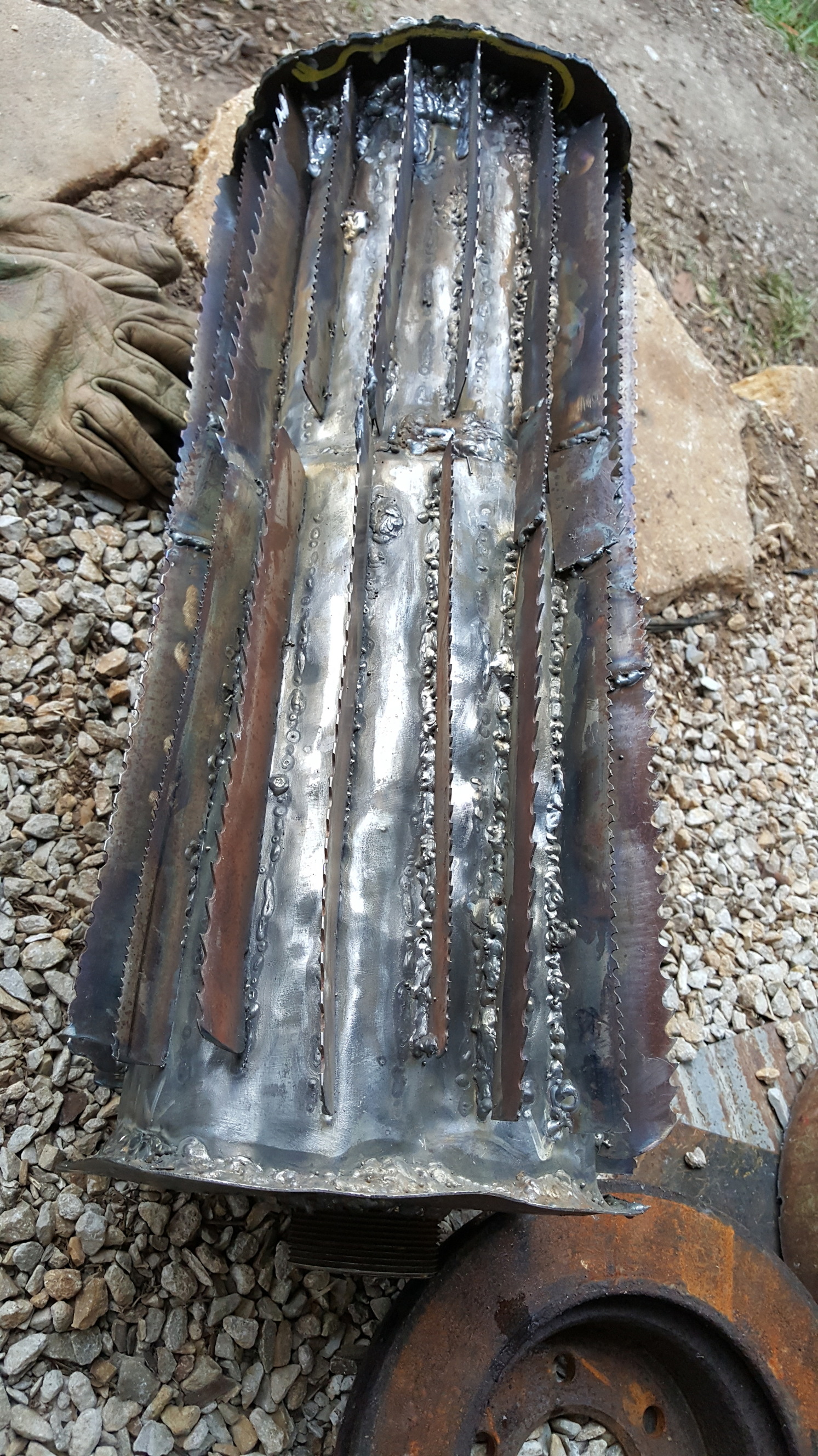

As I am welding the internal component of the large heat exchanger I am having trouble getting it to test watertight. My question for you all is which parts must be watertight in order to prevent explosions, and which parts can be close enough? For example I’ve heard Wayne say that the spray paint will help to fill up any tiny pin holes. But a hole in the wrong place could blow bigger holes in the system.
Hello amurphyone
If water is just seeping I wouldn’t worry to much about it. Also you may be able to spray some heat resistant paint on the inside and outside of the heat exchanger to help seal it.
I don’t think a very small leak on the heat X would cause an explosion but it may dilute the gas but might not be enough to be noticed .
If the heat X reaches the ignition temperature of the gas it is likely a small flame will form at the point of the leak which would weaken the gas and raise the gas temp going to the cooling rails. Again , it might not be enough to be noticed just depends on the size of the leak .
After the gasifier has been used for a while you will be able to look down in the housing and see if any air leaks have fired up . The heat X should be covered with black soot . If a pen hole has formed and gotten hot enough to catch fire it will be white in that area .

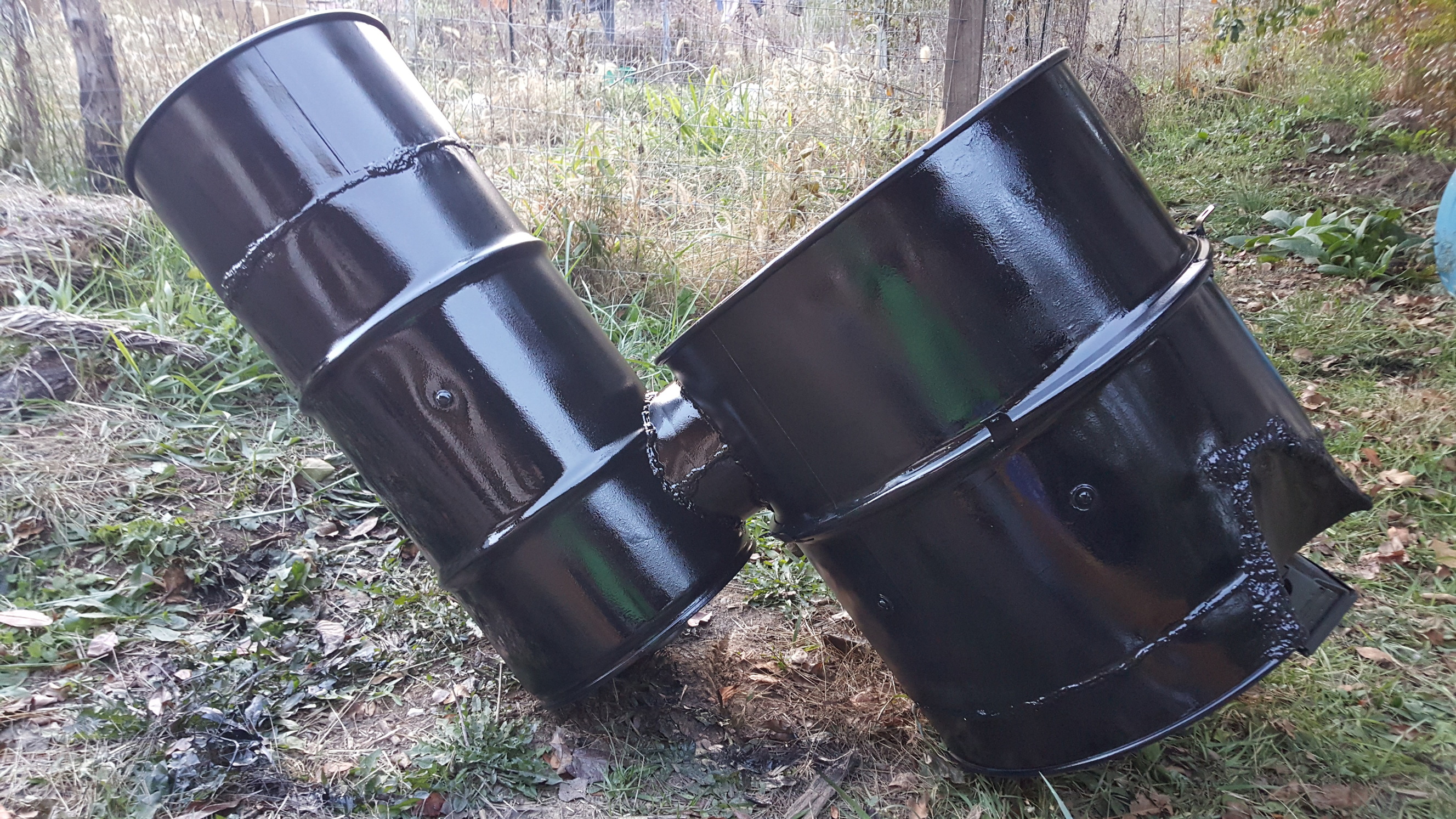

thank you wayne for responding 2 my question. And thank you for putting together this gasifier design. I am enjoying building it, after painting the heat exchanger I attached it’s outside housing to the outside housing of the fire tube. Things are going great.
Looking good Amurphyone. Remember, the nice looking black paint on your gasifier will soon be matching the tar and soot, that will be getting on it and that is good. That’s why Wayne decided to paint his WK’s all black, and the rest of us have follow his good and sound proven idea. There are those who prefer stainless steel, but we don’t hold that against him. Lol… I even have some stainless in my build, but you can’t see it.
You will soon to be making a big SWEM going down the road.
Thanks Bob. I chose a black truck so it hopefully all blends together as others have done.
