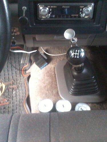

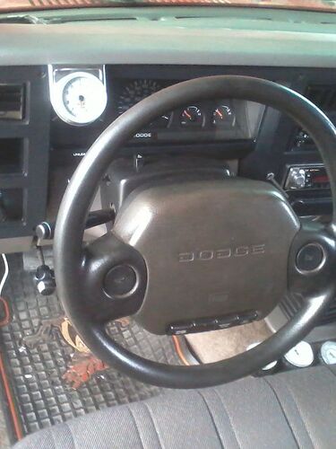

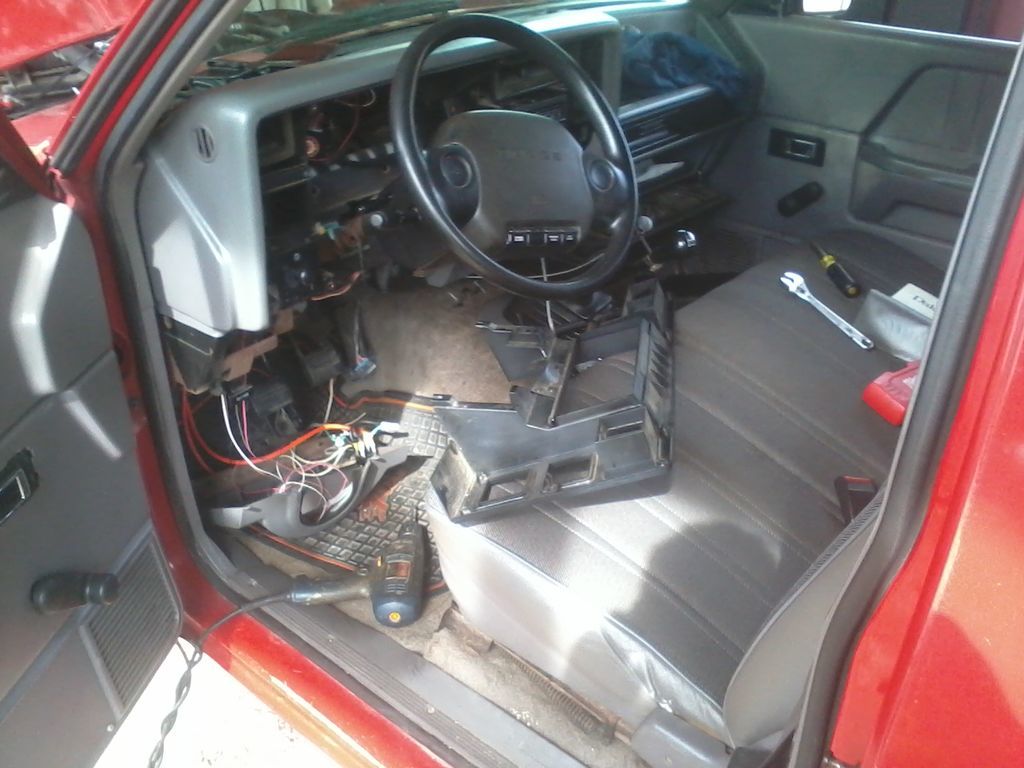

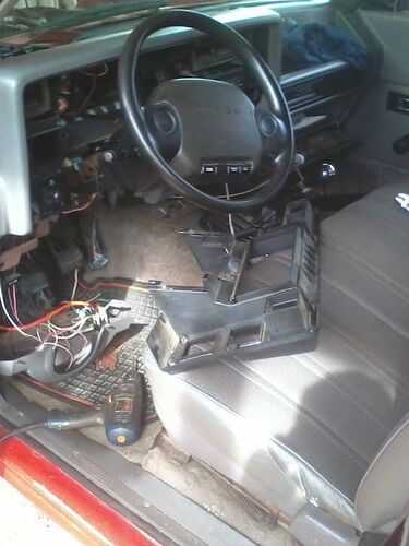

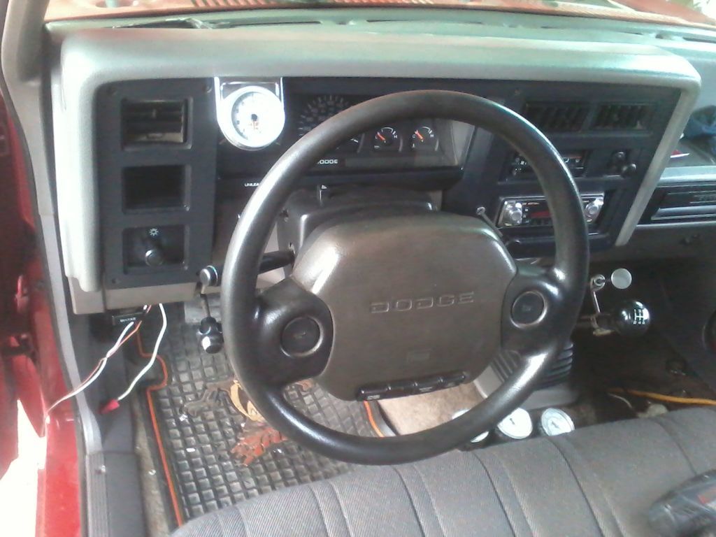

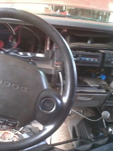

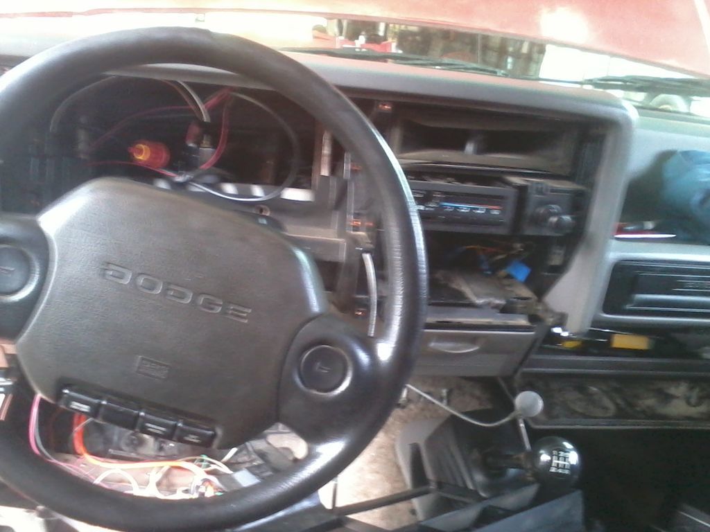

This truck will replace the ranger that I have been driving for the past year. This is a 96 dakota v8 manual trans regular cab short bed. The gasification system is already installed on the truck. Worked on gauges,wiring and control cables today made good progress. Hope to be running on wood by the 19th of this month.
Enjoy the pics. more to come soon!!!

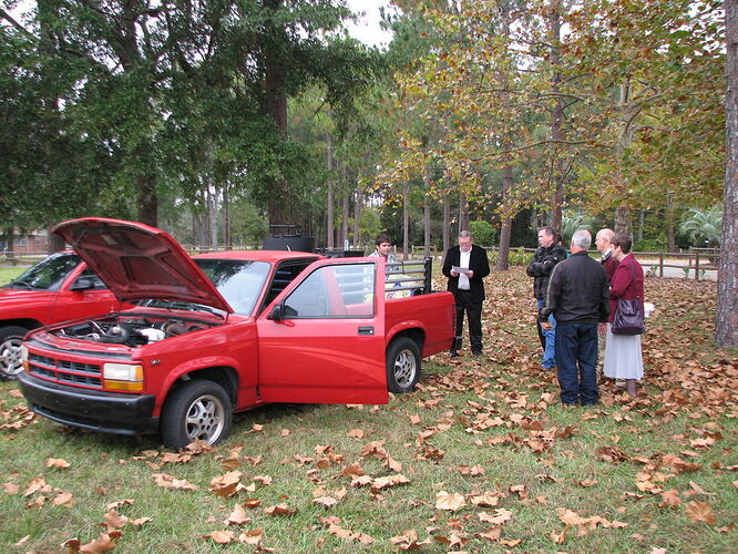

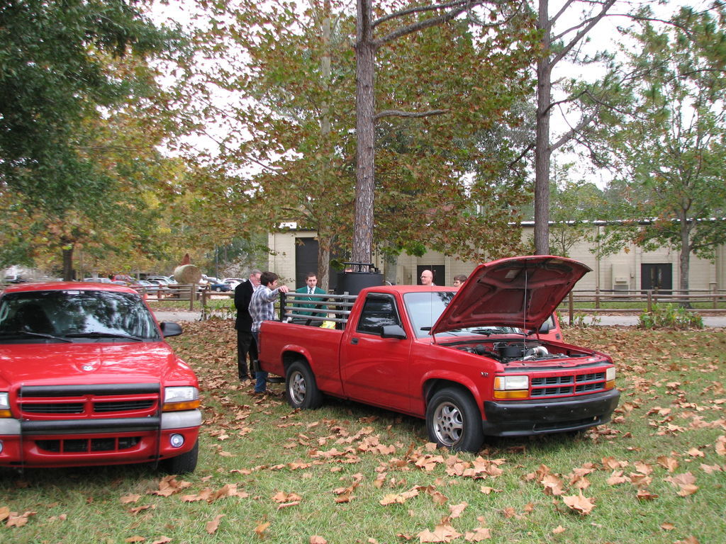

Are you kidding? My butt is glued to the drivers seat!!! Woody going to arm wrestle me later winner gets to drive tomorrow. I think we will be building another Dakota very soon.Yesterday I was asked to speak at a meeting in Green Cove Springs for UF. The truck did very well. After that drove around for the rest of the day put down 200miles. Today I got up cut some more fuel put down another 150miles both highway and back roads country driving. Truck is doing very well couldn’t be happier I will put some more videos up soon. Sometime I will have to get back in the shop and finish building the monorator tank and grate shaker. Hope all is well in your part of the woods. HWWT Sean

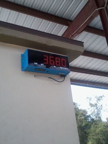

The Dakota lives again!!! Running much smoother now we should be out driving tomorrow. I meant to put this pic. up a while ago and forgot. I took the truck to get it weighed before the gasifier was mounted on it. This was with my weight out of the truck. The man at the scrap yard said it should be accurate to within 20lbs. I haven’t been back that way yet but plan to see how much weight was gained with the system on it. Wayne this Dakota should be close to the same as the one you most recently built the only difference should be the automatic trans verses manual.

I was tired last night when I wrote this my mistake. I was sitting in the truck taking this pic. so the correct weight is 3480lbs. with no one in the truck.
